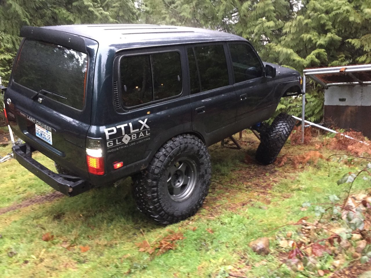

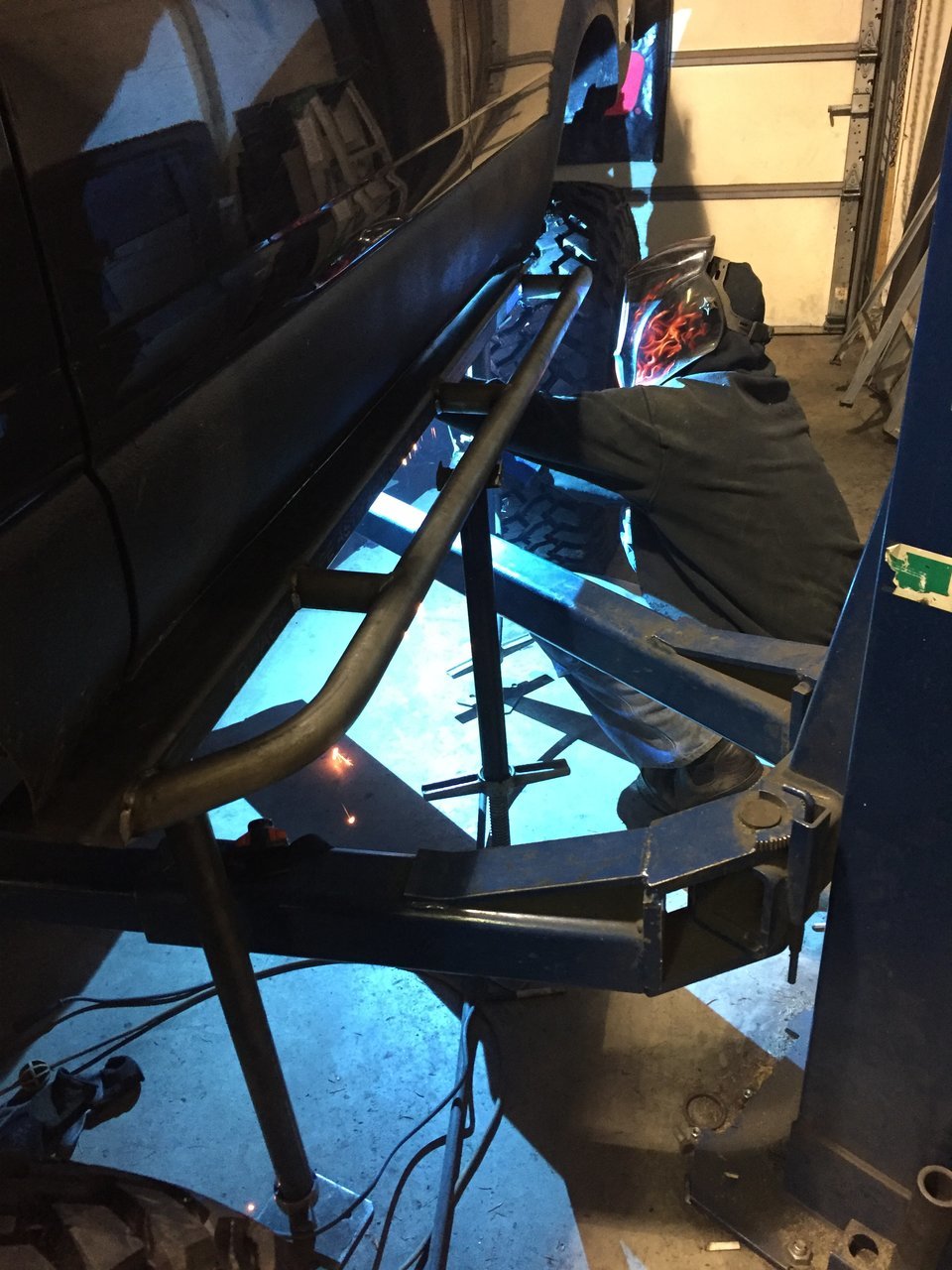

    Did some bump stop tuning this morning
    And sliders this afternoon. 2x4" 1/4" wall main tube
    And it's ready for the rocks tomorrow. Hoping the inaugural run to the rocks goes well!

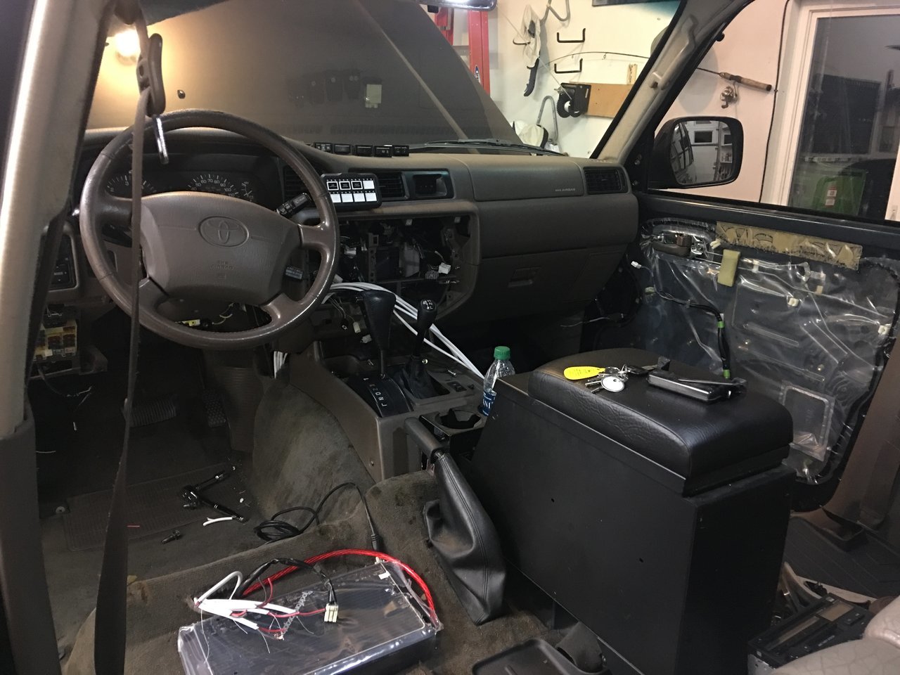

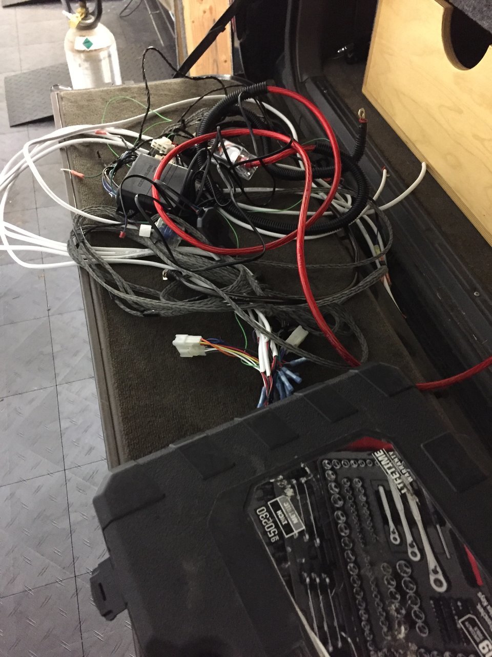

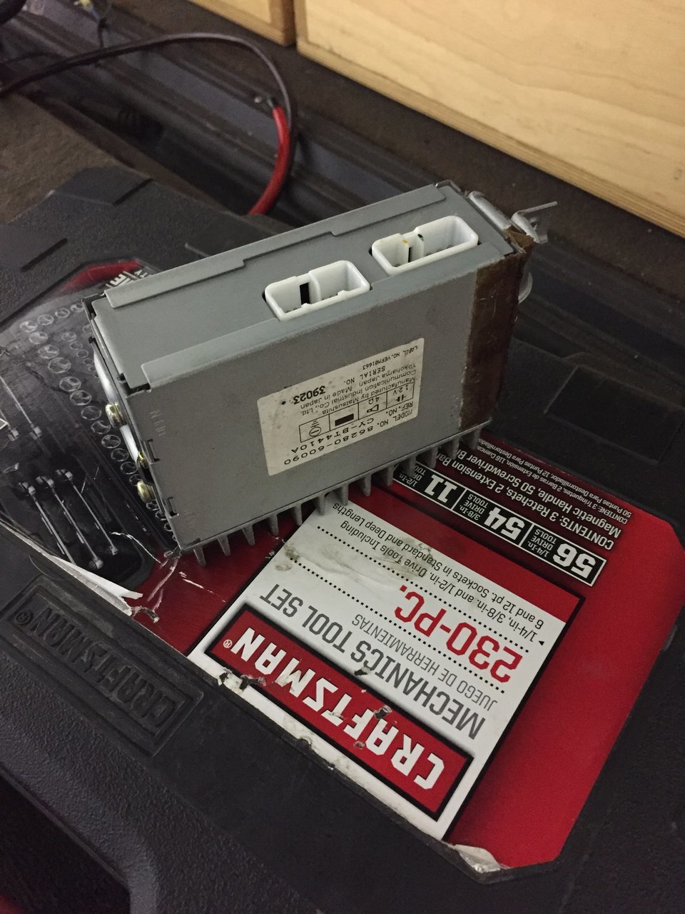

    During the stereo install my dome light went out so we figured my battery died since we had been testing the remote start. Turned out it started right up, but my radio, dome light, clock and dash lights didn't work. Blew a fuse. Put another in and immediately blew again (tried 2 more times). Unplugged radio and some other stuff, put a new fuse in and it didn't pop but we noticed an electrical burning smell. Great. Never saw smoke but the smell got strong.
    We ripped out all wiring that we had just put in
    and something was still burning. After 2 hours of testing wires, checking EVERYTHING and getting mad/trying to figure out what the hell it was I called my buddy Nick and said check the stock amp. Sure enough, even with a bypass you can't run a stock amp with an aftermarket amp, and that almost caught fire.
    So we reinstalled the stereo which is now:
    Pioneer double din headunit
    Rockford Fosgate everything: amp, front door speakers, tweeters in the rear doors, 6x9 speakers in the very back with two 10" subs. This heffer is LOUD.
