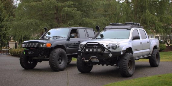

    Driving my friends' 80 feels really good actually. Last time we went wheeling he was driving it with one finger doing 80mph on the highway. Its pretty street friendly on 40's
