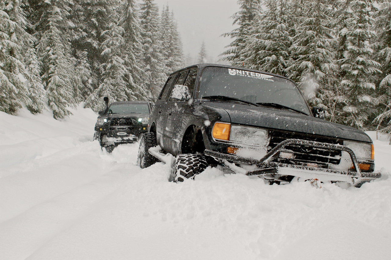

    Well I brought this home today, thought its time to show @loco how to build a land cruiser ;)
    1996 LC80
    172k miles
    4.5L straight 6
    Currently:
    When I bought it..
    Once my taco sells it'll be time to go all out on this one. Plan is to have it done by the end of August.

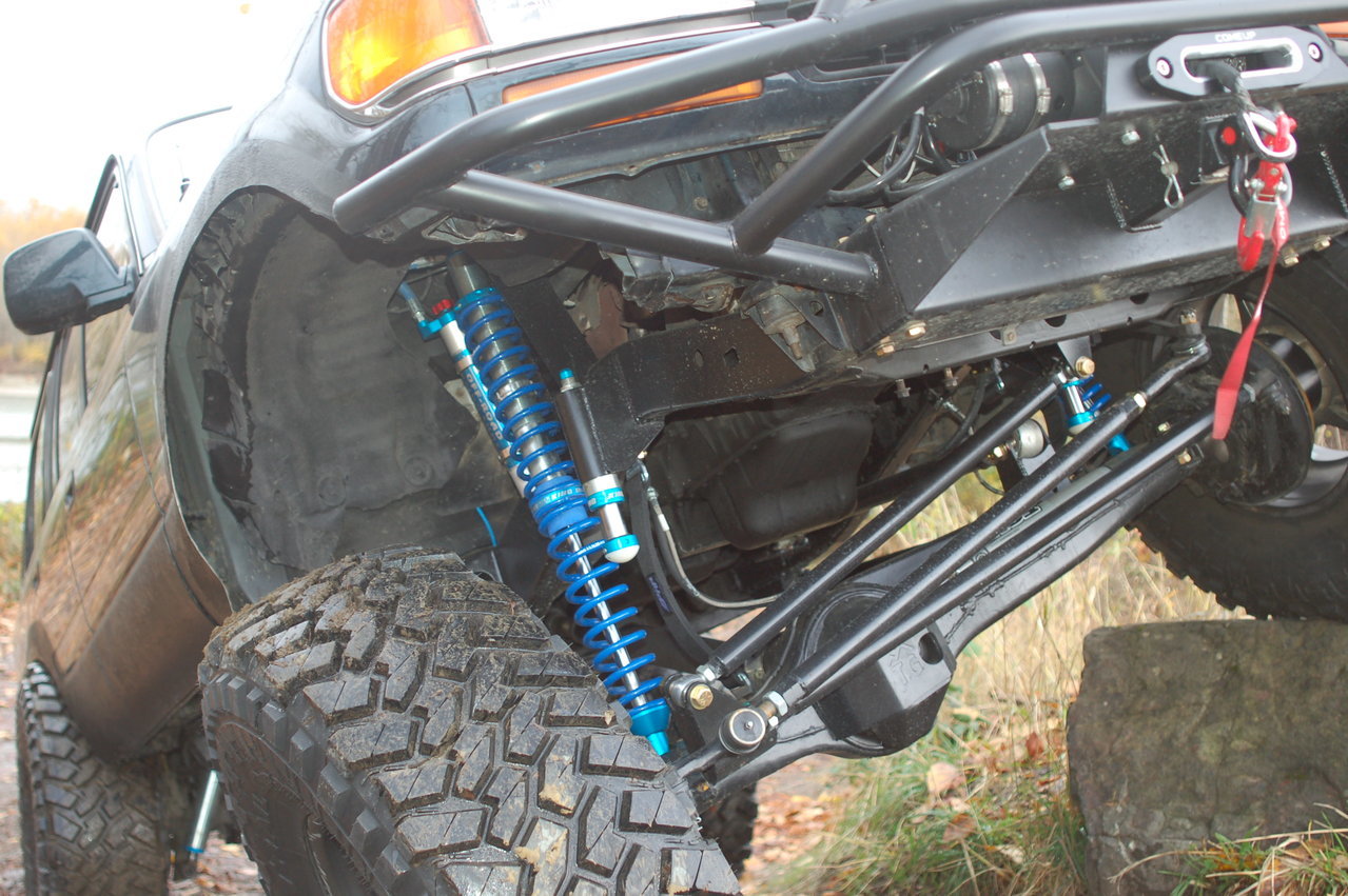

    Maintenance:
    Purchased 172,220
    PCV valve, deflared, vacuum hoses 172,470
    New Radiator 172,660
    Power steering flush
    Full axle rebuild/3 link 174,400
    Front end:
    114" wheel base.
    14" 2.0" King coilovers with resi/clickers custom valved
    King 2" air bumps
    Ruffstuff 1 ton Y link steering
    Fox Steering stabilizer
    High steer
    RCV axles
    Trail Gear diff guard
    Low Range offroad axle truss
    Custom 3 link
    Complete axle rebuild
    PRP 16" limit straps
    Slee extended brake lines
    Ballistic fab joints
    Nitro 5.29's with ARB locker
    Rear:
    Rear rockers/fenders cut/plated
    Dobinson 3" progressive coils
    14" 2.5" King's with resi custom valved
    Metal Tech rear Links
    Iron Man panhard
    Timbren bump stops
