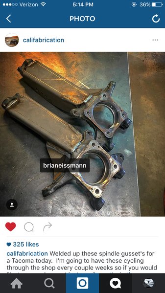

    They just welded the TC spindle gussets onto spindles for me, then I ship them my current spindles to get my core charge back

    Supposedly the TC spindle gussets with sway bar mounts are beefier/stronger than the ones without, thats the only reason I got those. Definitely not going to run a sway bar :)

    Yeah I've heard that too and I will be doing the swaybar gussets with no swaybar

    Excited to see all this installed. I need to get them TC spindles and gussets soon my self

    You should probably just leave off the dust shields as well.

    Really? Looks like you have yours on
  14. Apr 26, 2016 at 7:14 PM
    #2614
    2ndGenJonny
    2ndGenJonny Well-Known Member Vendor
    Jan 3, 2013
    #94306
    18,447
    Jon
    Gilbert, AZ
    I do, and regret it. I had to go back in a day after my lift and clearance it. Its a pain in the ass and those shields just end up getting bent and catching rocks.

    Hmm I may.. I've only had one rock get stuck in there, just bent it out with a screw driver and haven't had a problem since.

    Well if you dont when you get the rotors and calipers on take a real close look and spin them. Climb under over and around that bitch to make sure its clear.
    Use a punch and a hammer to beat and bend it. There are a few spots near the caliper that will catch.

    @dakotasyota did you have any problem with your dust shields? Wonder how much beefier the sway bar version is versus non sway bar..

    According to TC, quite a bit

    I have the spindle gussets with sway bar spots and I just used my ball peen hammer to clearance the dust shield and I have no issues at all

    I guess ill try clearing the dust shields first and if I get tired of it I can always take them off. Thanks guys for your info!!
