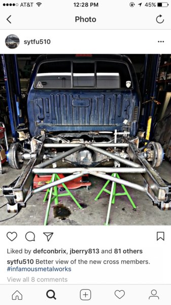

    Bri did you remove the frame cross members? I'm trying to get a visual on one piece vs your standard steel to box out the frame. I'm also assuming the new cross members are replacing the area that used to store the factory spare... Im I on the right track?

    Not sure how he is doing it, but to do a one piece you'd remove that cross member that holds the spare, so yes. That's my plan, probably 1.25" DOM tube

    Got it thanks. Been curious about the welds and such. Spacing? Assuming same areas where the existing cross member is welded on now is where You would put the 1.25" DOM ...

    Same as what he is doing

    Yes, but welds depends on which plate you get. If non-windowed, you'd want to do a continuous weld along the entire thing but if windowed, only the parts that meet the frame, obviously and I'm putting my cross member where the stock one was and two extra in the very back and very front

    If you are going back to OEM shackles then instead of a rear cross member I am putting one between the 2 shackle hangers so they don't bend anymore coming off a ledge. Ill see if I can find the pics to how I plan on doing it

    Yup, that's my plan but I am going to do each one separate and meet together on the frame cross member, I don't want a tube hanging low causing a potential catch point on a rock or something
    Like what @sytfu510 did

    Yup. Then just placing the rear cross member so that it can bolt to the top of that.
