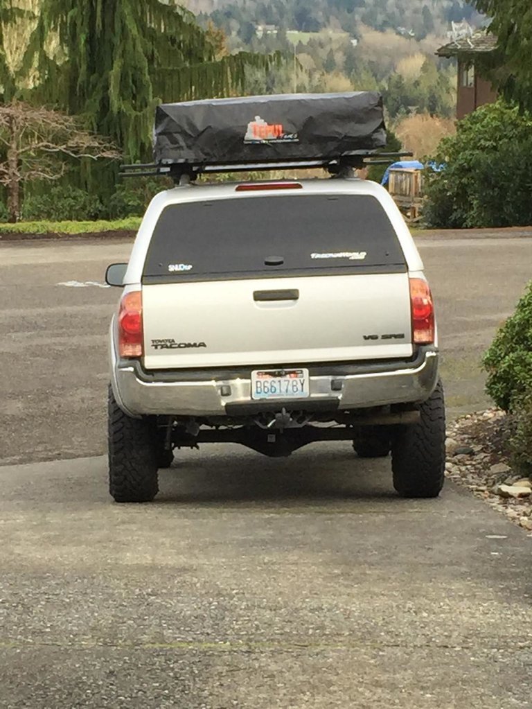

    Parked at the YMCA and turned around and thought it looked damn good! The front is 3/4" taller than before, going with 285's for sure next time.

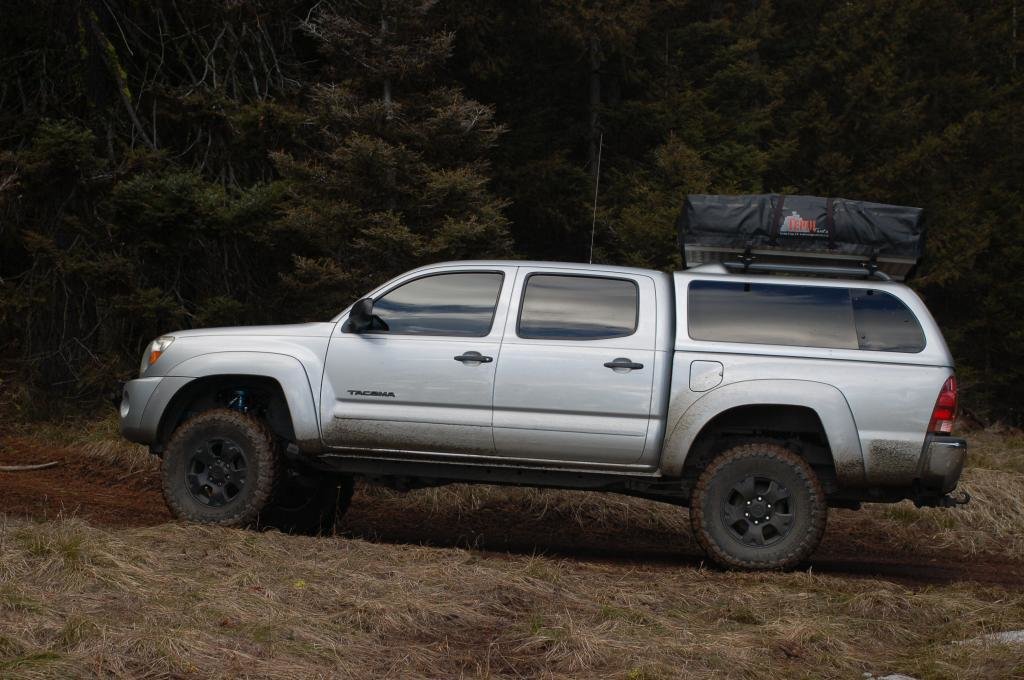

    Loaded up for this weekend :D

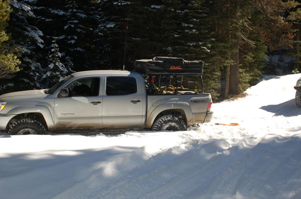

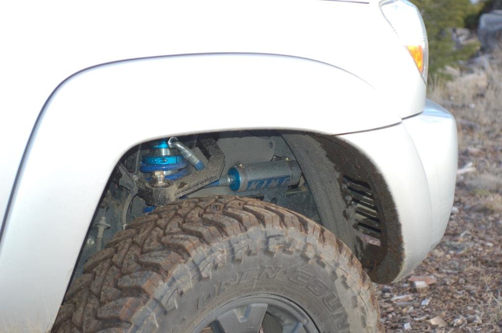

    Went on a short weekend trip with Greddy and JDAM, ended up being quite an adventure. 12-15 degrees when we woke up this morning so it was a bit cold, then having conflicting signs towards civilization made it even better. Going to be pic heavy :D
    Getting the kings dirty :D
