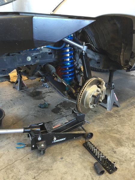

    Done for the night.. Few set backs.
    TC cam tab gussets sucked up 3-4 hours at least.
    Driver Side uca through bolt, at the tip the threads got really screwed up somehow and huge thanks to @utroda for coming up with the idea to file it down, then used an impact wrench to get it on.
    Then the cv wouldn't go in.. we think because it wasn't perfectly squared up.
    But got the following done:
    TC cam tabs, both UCA's, LCA's, driver coil over. Will finish tomorrow, but couldn't have gotten this far without @utroda and @dakotasyota.

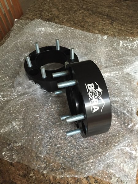

    You aren't running spacers in the rear?

    1.25 spydertrax. Cuz I already had them.

    Same thing i run with my kit, i for one wouldn't consider going wider in the rear than I already am.

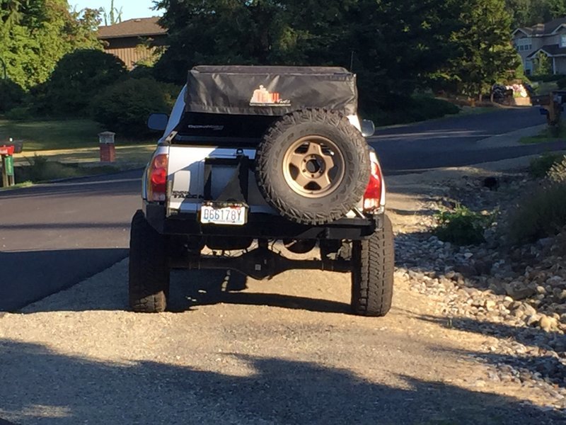

    Looks pretty good going down the road, didn't want to take a pic until after the alignment. It was kinda pegion toed on the way there!

    Hub to fender is 23.5". I LOVE IT
