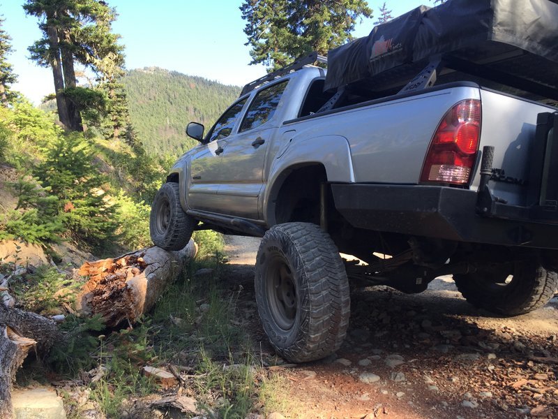

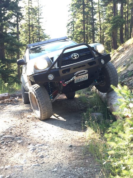

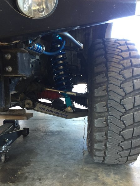

    What a night.. Truck has 4.1 and 4.5 degrees of caster and doesn't rub!!
    The good.. Went back salmon la sac with @utroda on my way home
