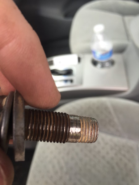

    Got the bolt from Toyota this morning. Pulled out the skid plate bolt we put in as a "trail fix" and it came out looking like this..

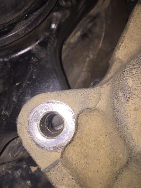

    Fuck. Put the new bolt in and screws about 1.5 turns before I have to force it with the wrench. Looked inside to find this:
    Not sure how the tapered bolt from the skid plate damaged the threads on the spindle. @jberry813 @Mademan925 @2ndGenJonny @NateMob Do you guys, or anyone else, know if its possible to retap the threads of the spindle?

    Its worth a try to run a tap from the opposite side and see if you can fix those threads. If you can get the bolt back in and torque to spec without killing the threads again you will be good.
    Talking to Brandon he saw this issue at the dealer alot when people cross threaded those caliper to spindle bolts.

    You can retap them if you get the right tap of course. And like he said, make sure you tap from the other side that way you can start on good threads and be straight

    Cal Toyota and ask them what size that caliper bolt is that you just got

    Sounds good. I should be able to take the bolt to the hardware store in town and use one of those things you screw the bolt in to see what size/pitch it is and that'll tell me

    The key here is after you tap it that you get it to spec without trashing the threads again. If that happens youre going to need a new set of spindles and gussets. Unfortunately, i can only help you with one of those.
