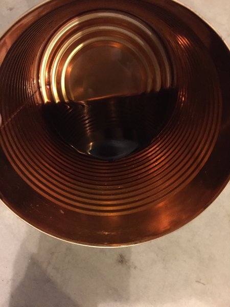

    Thats fine. Just read the bottle, it'll tell you what it is compareable to. I used mobil 1 synthetic ATF, it says on the bottle that it is for general motors and toyota vehicles. Then on the back it says that it is essentially a mix of both dexron 2 and 3.
    Mine is stained. I've had a leak before though. This new fluid appears to have solved the leak issue thus far.
    Good rule of thumb is to change it when it gets dark like that ;) :p

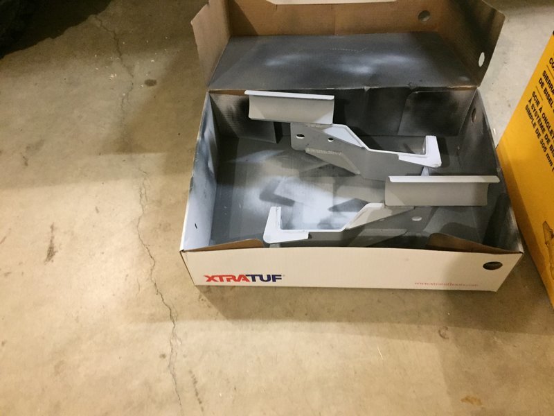

    Started with retorquing everything up front, and repainting these.
