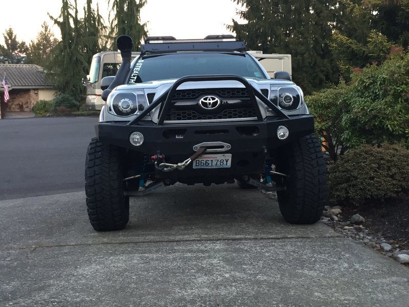

    My OEM head lights with a the mini D2S retrofit kit from The Retrofit Source, then a bad ass paint job and install by @dakotasyota :D

    Right on, thanks! Now i have a good idea of how I want my headlights.
