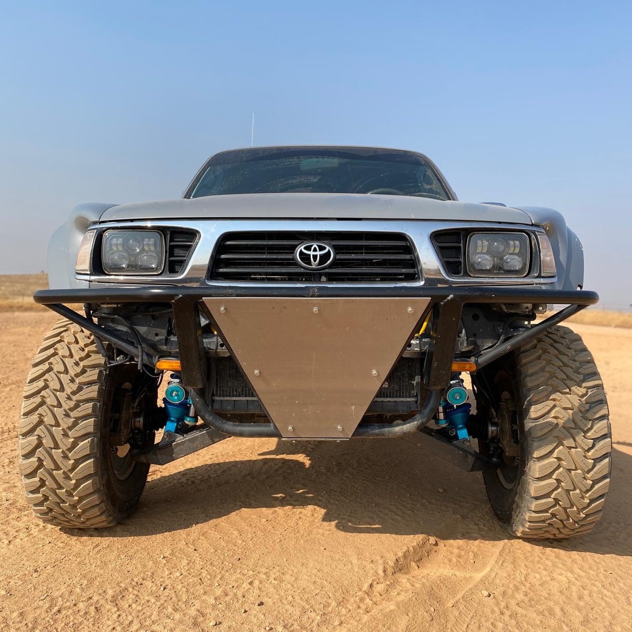

    I’ve got a 97 Tacoma built with a Camburg LT kit, king coils, king bypass, king air bums in the front and deaver under strings, king bypass shocks in the rear. Haven’t tuned the bypass shocks yet but where should I start? Having an obvious nose diving issue when I get airborne.

    Realistically you gotta move more weight to the rear to balance it out

    When you hit the ramp or jump, the rate of compression on the front shocks versus the back, and the rebound setting will affect how the truck takes flight.
    If the dynamics of a truck are similar to a mountain bike (I’ve never launched my truck) I’ll suggest this: You want stiffer suspension up front, with a slower rebound in the rear, so it doesn’t cause the truck to rotate. The rear end recovering before you leave the jump will cause you to pitch downward, hence the delayed rebound. You also need enough travel, or enough progressive response, in the rear that you don’t hit the bump stops, and pitch the nose down.

    weigh Ur truck then U see SEE an obvious weight distribution
    given enuf speed distance its NOSE Heavy !!
    some of the race trucks move radiators....oil coolers maybe the spare also
    they get a lot o air on purpose
    yet they dont want to face plant dig in the front
