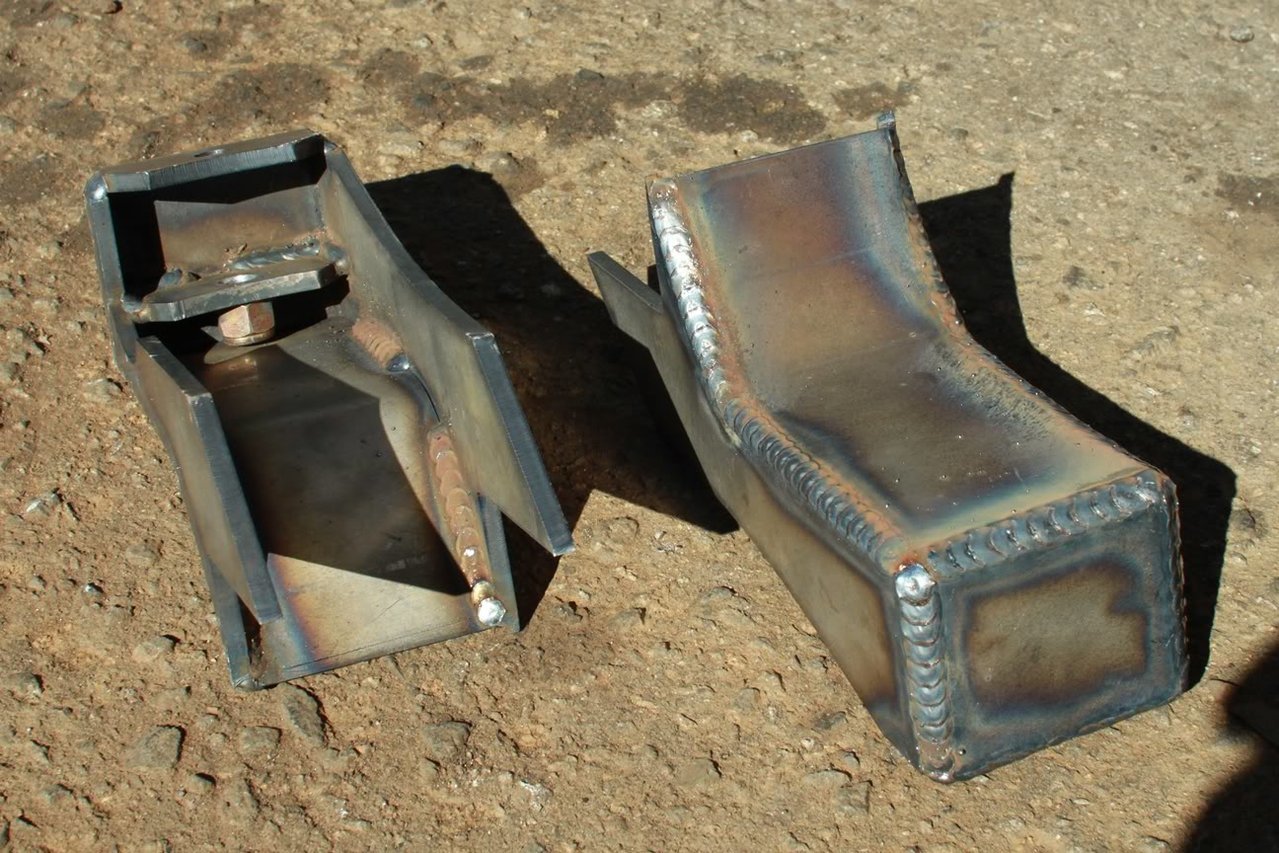

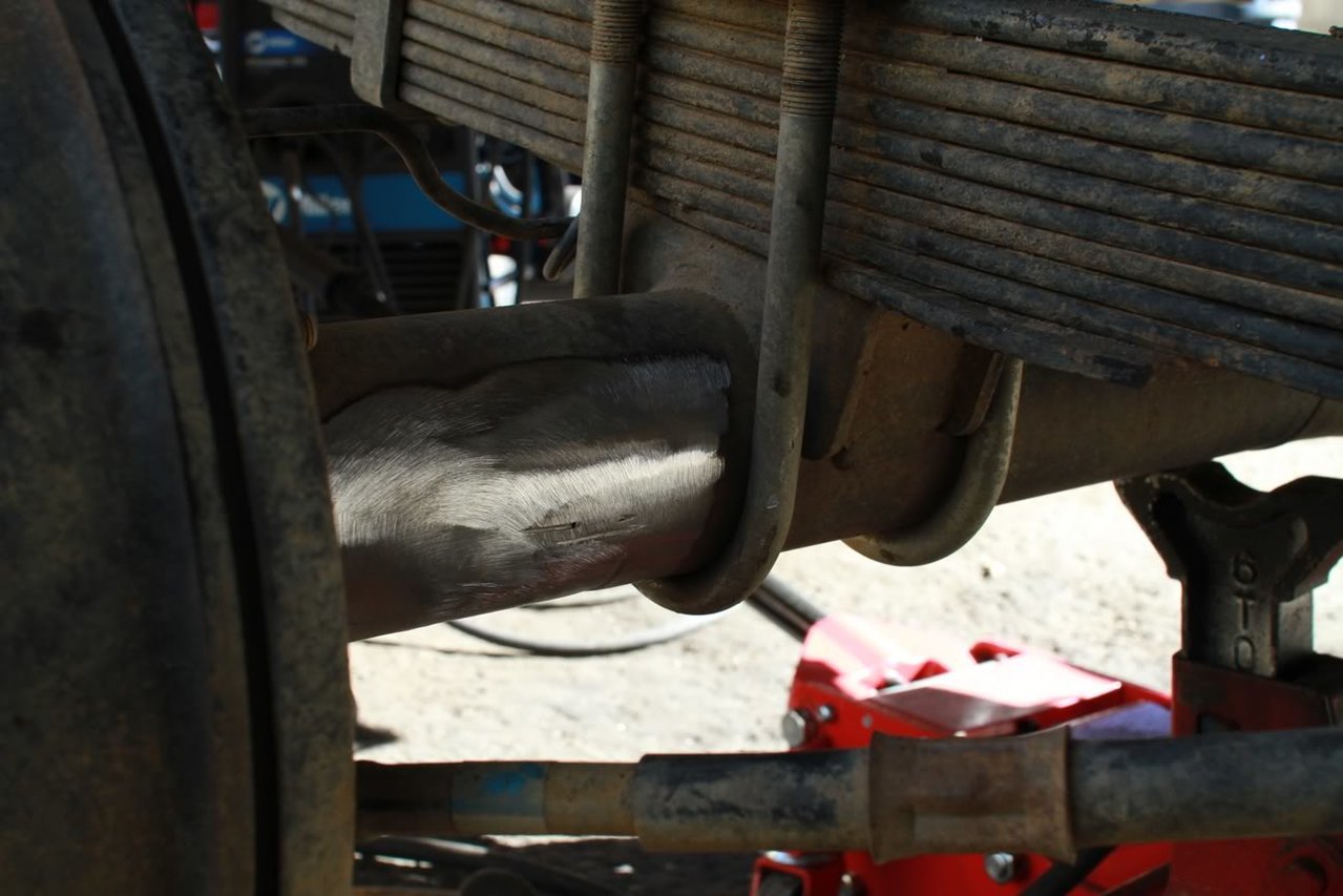

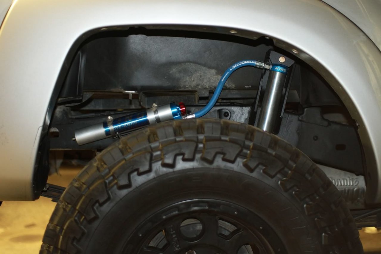

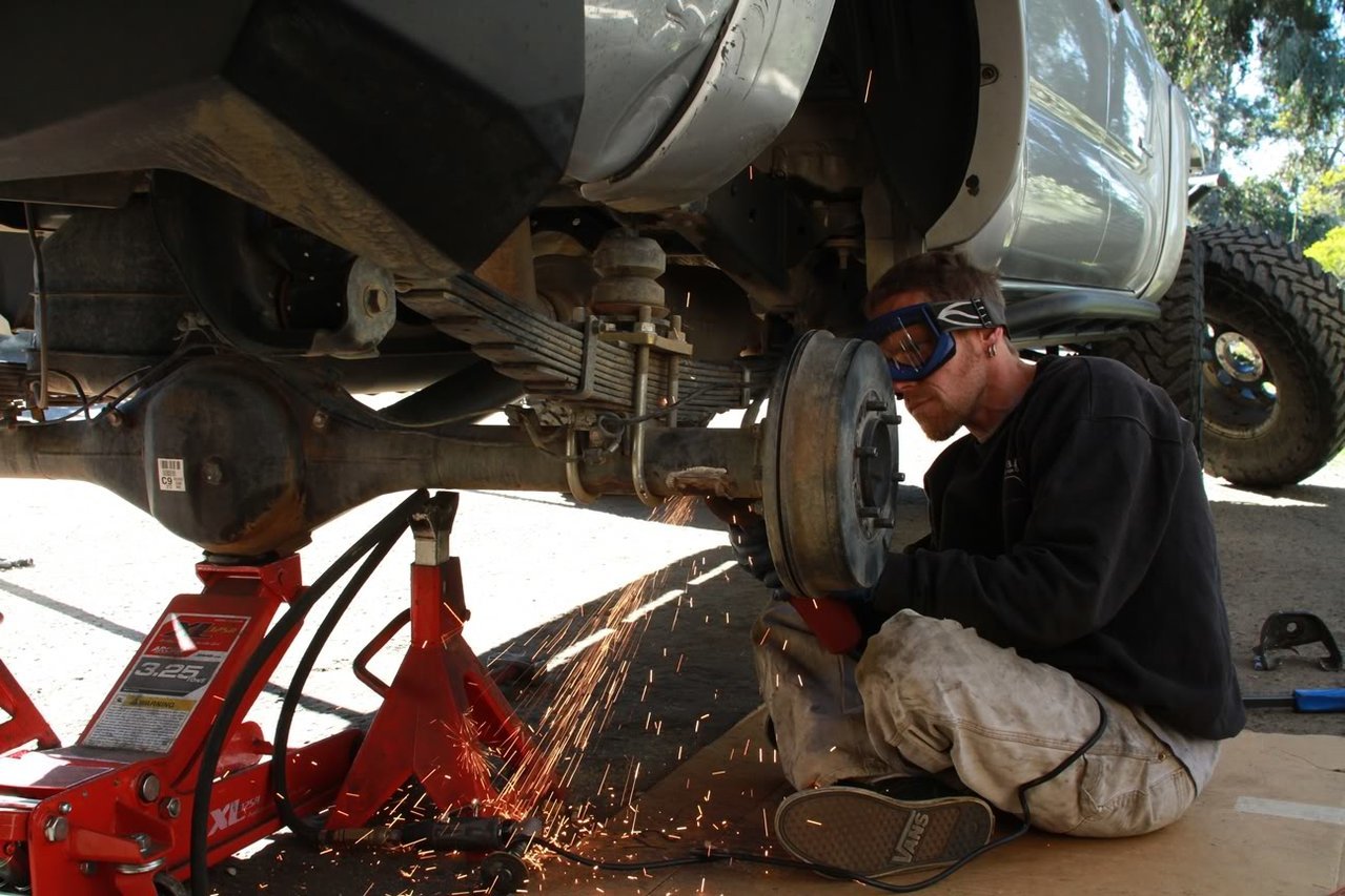

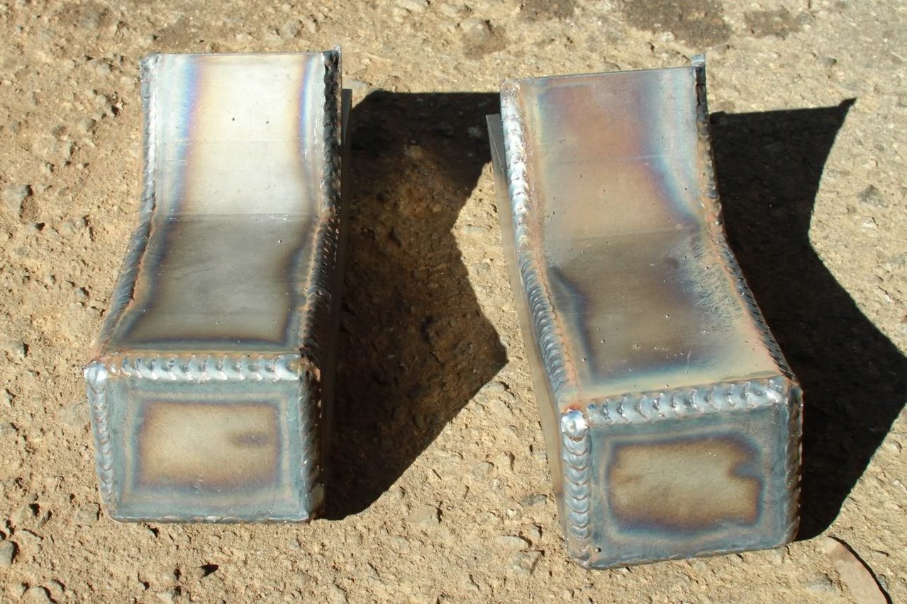

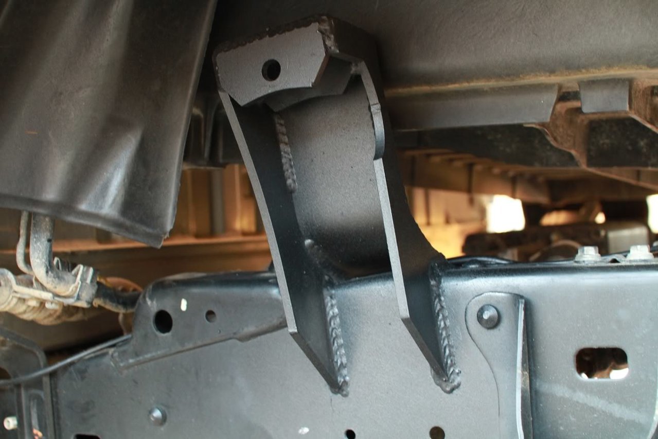

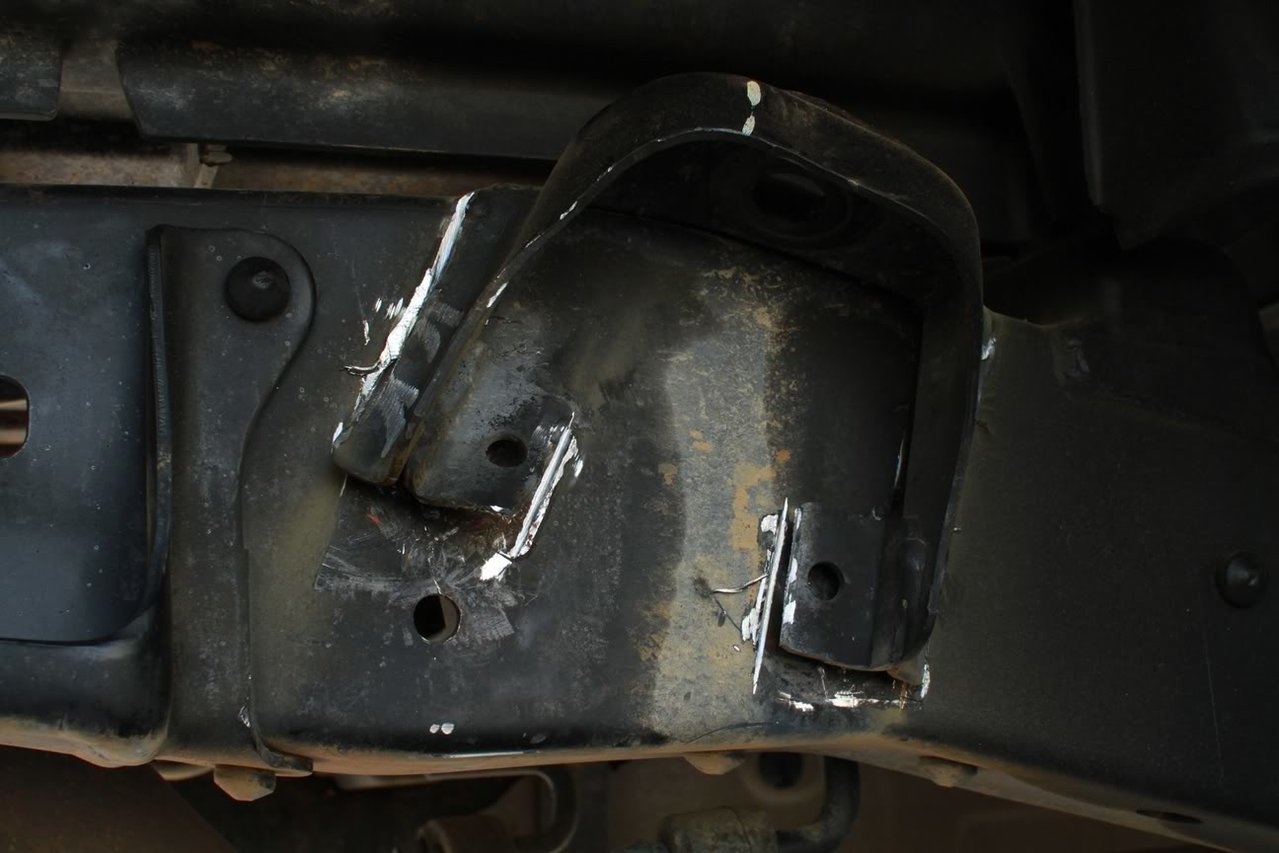

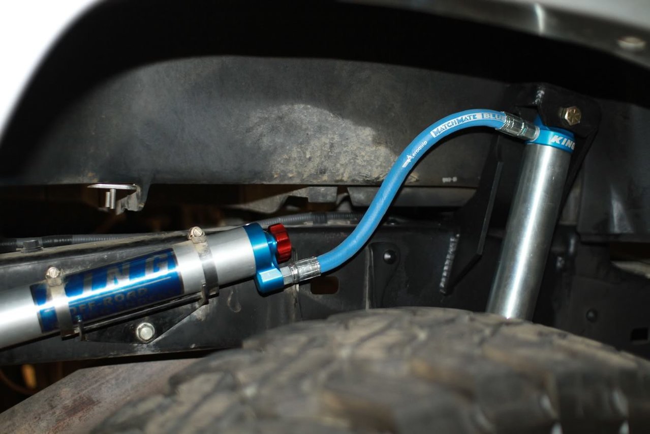

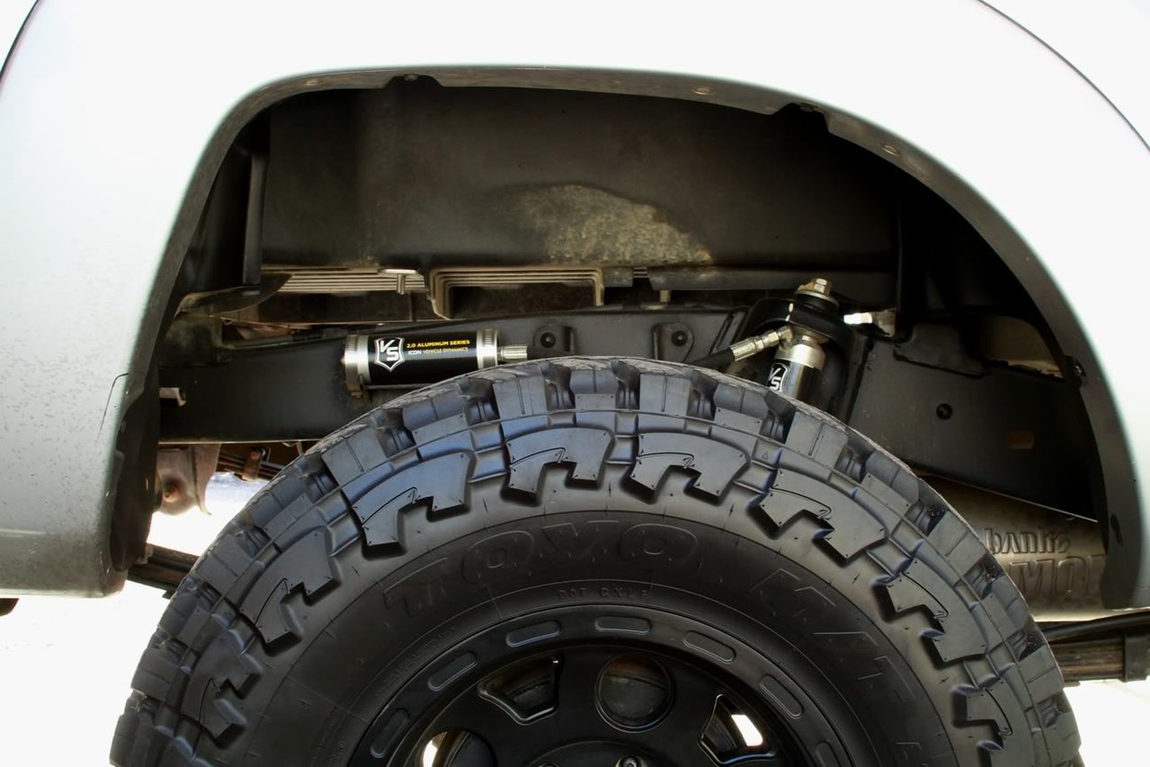

    Upgraded the rear to be.. umm... "more" MT :D

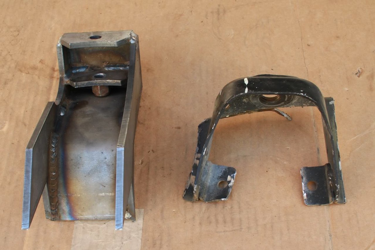

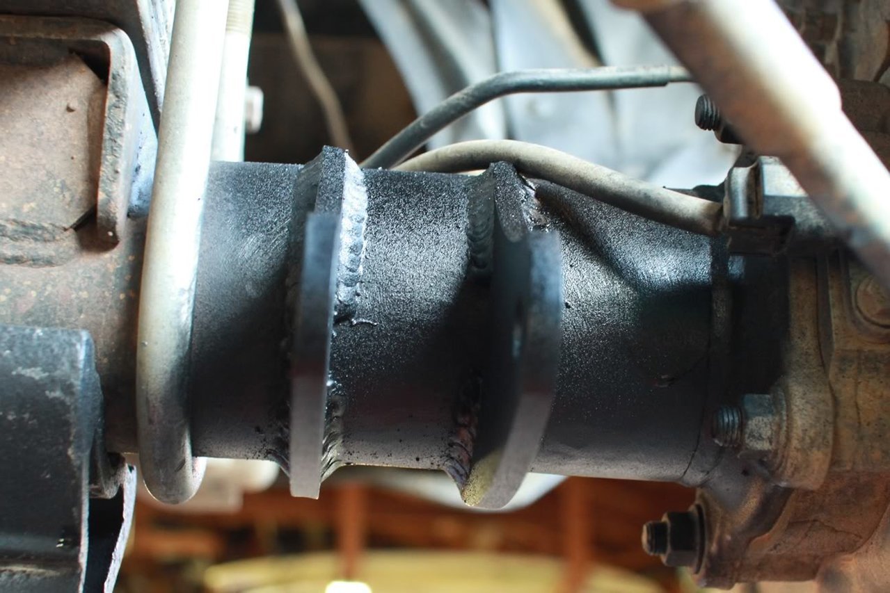

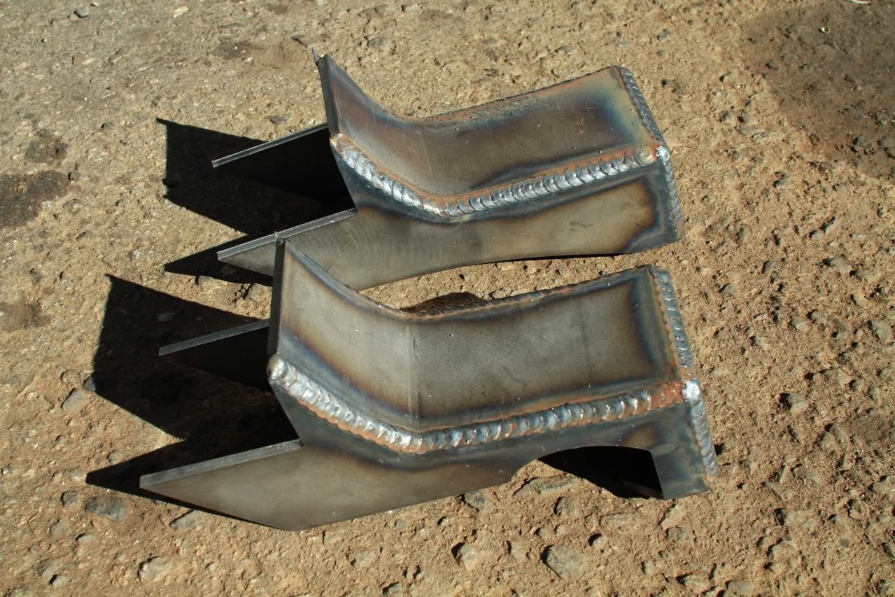

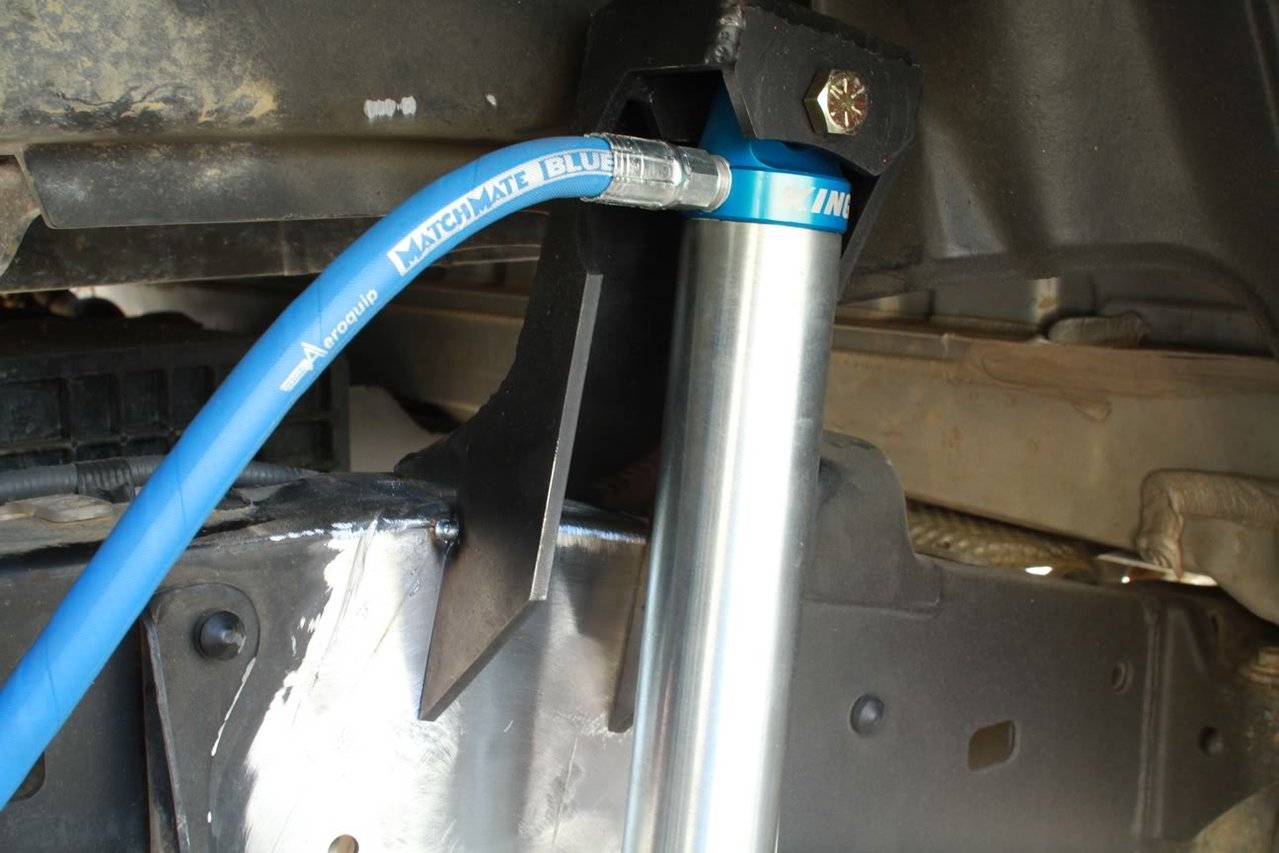

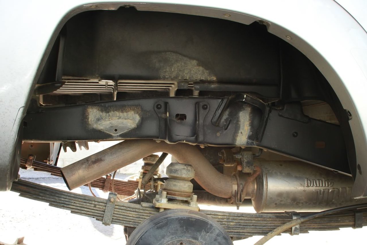

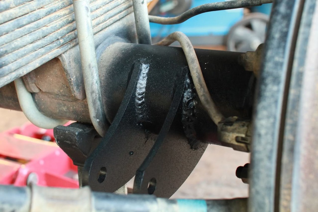

    BAMF diy shock relocation kit - King 12" x 2.0 smoothies, remote resi with comp adjusters
    Speed Freek did an awesome install of this relocation kit and shocks for me. I couldn't be happier with the quality and OEM look of running 12s, these things are solid.
    I bought the kit in pieces and had Jason complete the build:
    Old Icons are out of the way (will be for sale once I get one of them rebuilt)
    Getting the passenger tower off...
    On to removing the stock lower mounts
    Tacking everything in for final fitment and suspension cycling, then finished up the welds and added some paint
    Before and After:

    Nice dude!!!
    Did you do anything to the valving of the smoothie?
  19. Jan 18, 2013 at 2:34 PM
    #79
    NoSoup4You
    NoSoup4You [OP] Well-Known Member
    Jan 3, 2012
    #69909
    1,240
    David
    Palos Verdes
    2008 DCSB DMZ LT 4x4
    Camburg | King | Glassworks | DMZ | Nitro | Banks | Pelfreybilt | Brute Force Fab | Bay Area Metal Fab | Baja Designs | Rigid Industries | STL
    aww damn.. I was about to post my best buff as shit self portrait too :pout:
    Thanks! No valving changes yet .. I have some learnin' to do now :D
    Sonny knew about the BAMF kit and ordered valving for my application, plus said I could get it changed if I need to.
    I guess the valving is also a little lighter than usual since I have the comp adjusters which supposedly almost lockout all shock travel at the firmest setting. I had it right in the middle for the drive home last night and I've never felt a freeway that was so smooth before
