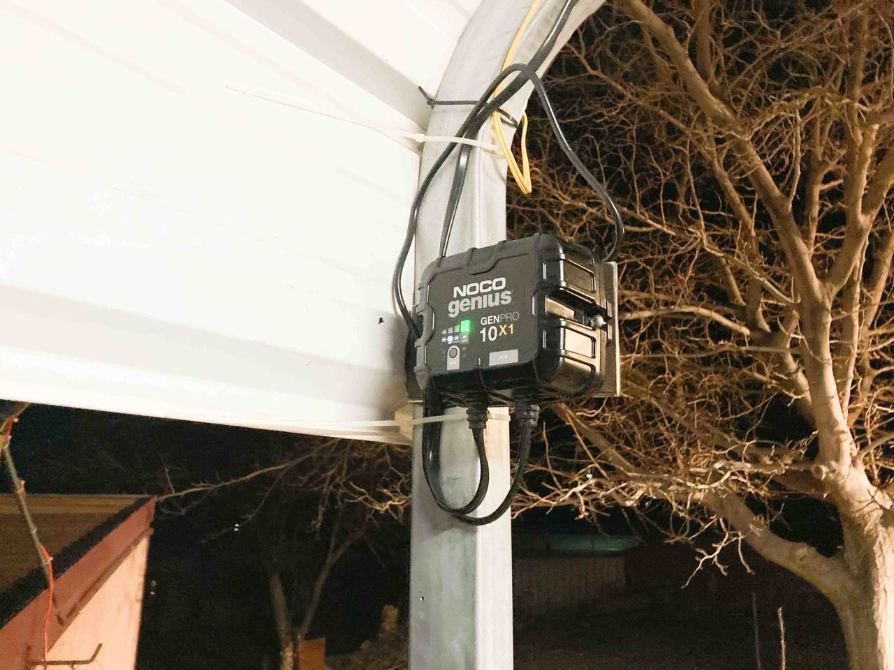

    Thats a near $400. battery. You need to charge it every 10 days to keep it good for the long run. if you don't keep it full from time to time, it will get weak, and fail early.
    The 3rd gens have a crap charging algorithm that is controlled by the ECU. It's not nice on AGM type batteries.
    Get a good AGM style charger. If you live in a cold area, its very important, not so much in warm/hot areas. I mounted a water proof noco in my car port for winter time.
