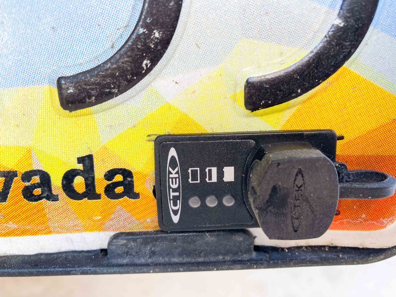

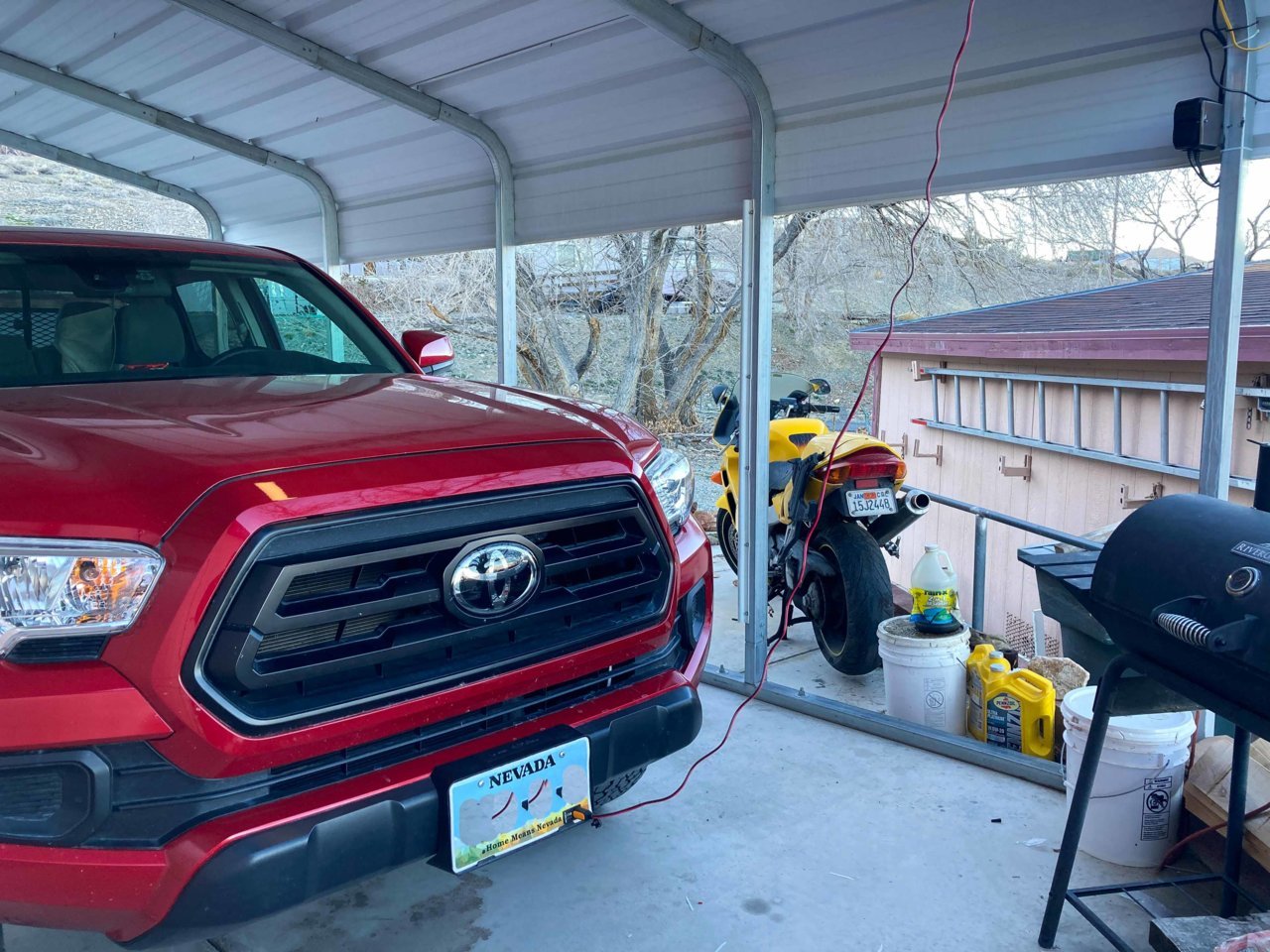

  5. Oct 1, 2023 at 9:41 AM
    #25
    Benny22
    Benny22 Well-Known Member
    Jul 28, 2022
    #402333
    265
    20Tacoma
    I drilled a hole in my lic plate, but you can just hook up a pigtail from your battery, and let it hang behind the grill. The extra top off charge is not needed during summer.
    You can leave the battery in the truck, but don't charge if the engine is running.

  7. Oct 1, 2023 at 10:55 PM
    #27
    Benny22
    Jul 28, 2022
    #402333
    265
    20Tacoma
    I like it, but its a CTEK outlet/plug. When my Ctek failed, I got the NOCO.

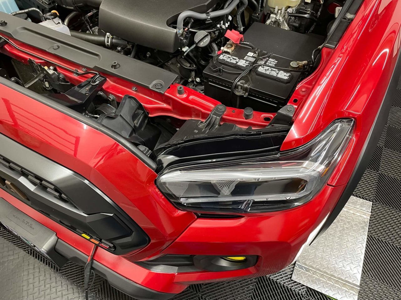

    TRDRed
    TRDRed Well-Known Member
    Jan 8, 2023
    #415070
    1,198
    Pacific Northwest Playground
    2020 TRD OR DC SB OTT Tune
    If you’re referring to this model, it maintains the battery as described above. So there’s no reason to disconnect it until you’re ready to drive. Hot, cold or in-between it’ll keep your battery charged and ready to go. I connect ours whenever I know I probably won’t drive it for a few days or if I’ve taken a bunch of short trips where I had to start it up several times.
    FWIW I have a permanent lead on the battery terminals. Makes it very easy to connect and disconnect. You can see it in my photo above. Looks like this one will work with yours:
    https://no.co/gc002
    Hope that helps!
