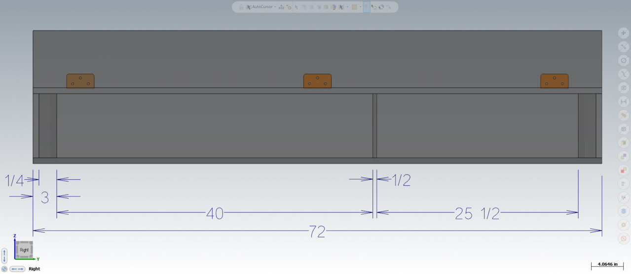

    As any engineer does, I let my drawings lag behind the actual build. I spent a bit of time this morning updating them to make sure they match the real thing. :)
    A couple of notes
    1) The key height to get everything to lay flat in the truck is from the bottom of the box to the bottom of the top piece. (8 7/8") That's the height of the wheel well.
    2) I have the OEM bed mat. That 8 7/8" will have to be adjusted to compensate for that if you don't have one.
    3) The box is made of 3/4" ply. The drawers and dividers are made of 1/2".
    4) Of course, in this wacky world, plywood isn't actually 3/4" and 1/2", it's a stupid 23/32" and 15/32". I kept the drawings at the former to keep the math easy.
    5) I left a 1/8" gap between the drawers' sides/top and the box. This allows the wood to expand with humidity.
    6) Those drawers are snug and create a vacuum when you pull them out. (Like a cylinder piston.) I need to drill a few 1" holes in the backs of the drawers for airflow.
    7) The magic angle for everything related to the legs is 15*. If you set your mitre saw to cut the legs and guides at 15*, everything is super easy.
    8) The long drawer was made long specifically to hold the legs when the boxes are packed.
    9) I picked the leg length to make the box countertops the same height as my real kitchen. Of course, you're free to cut them to a height that's comfortable for you.
    10) Always observe the golden rule! Measure twice, cut once. (I usually measure 3 or 4 times because I'm getting old and forget what I'm doing.)

    I think you got it right. The 1/2" ply on the bottom and "insides" of the leg boxes would probably work. I would agree that you want 3/4" for the handles and top. Those handles do get a good tug when you pull the boxes out of the truck. When they're out of the truck, you need to keep in mind the contents of the drawers. That's the only time the bottom sheet comes into play. However, the truth is that the bottom sheet is entirely suspended from above at the ends and the drawer dividers -- kinda like a suspension bridge. Assuming you're not carrying bars of gold or lead, a 1/2" bottom sheet should be fine.
    Also keep in mind what you put on top of those boxes when you pack the truck. I brought a two cast-iron dutch ovens, a cold-rolled steel DO table, all the necessary accessories, two tents, etc. That cooler is no joke either. Those drawer dividers are doing more than it may appear in that scenario. That's also why I made sure the backsplashes rest on those ridges that run the entire length of the bed -- not just the wheel wells.
    My other tricks for weight savings (and simplicity) were to keep the drawers simple: no drawer slides or handles. But, that's only a small amount. Other than that, outside the material itself, I dunno. Helium bags maybe?
    Thank you! I drew those up in Mastercam. I'm a computer programmer for ... Mastercam. :)
