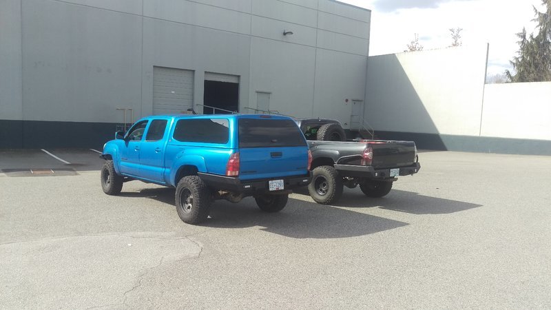

    Did you still have 265/75/16s here?
  7. Aug 14, 2020 at 7:03 PM
    #187
    WormSquirts
    WormSquirts [OP] Armageddon
    Dec 18, 2015
    #172583
    2,909
    Braeden
    BC
    Yep, that picture is with 265s

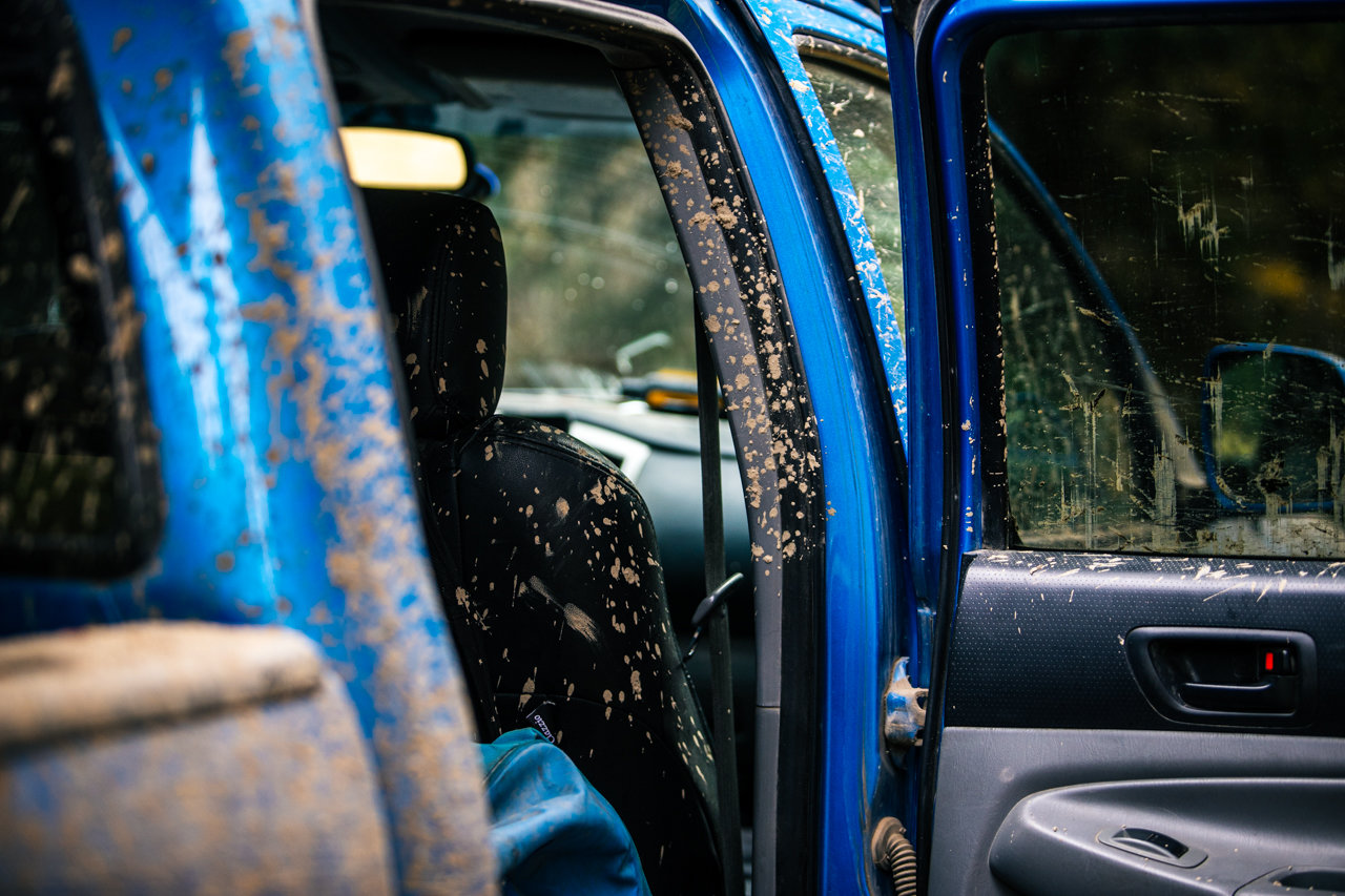

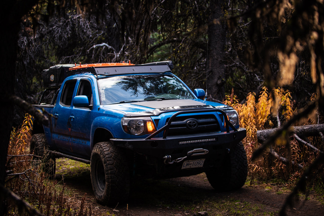

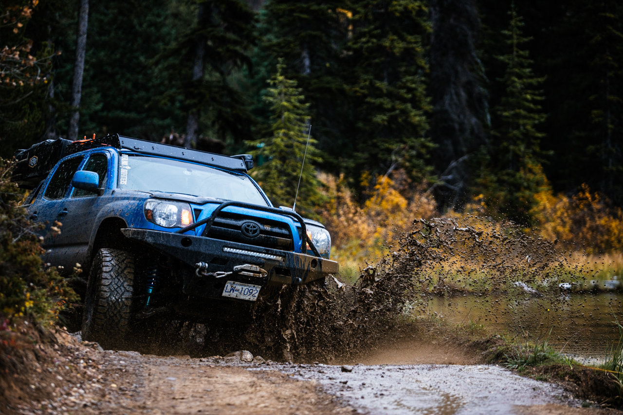

    More pictures.
    IMG_4495.jpg IMG_4533.jpg IMG_4541.jpg IMG_4609.jpg IMG_4736.jpg IMG_4711.jpg IMG_4576.jpg
    hinmo24t, Slashaar, utroda and 5 others like this.

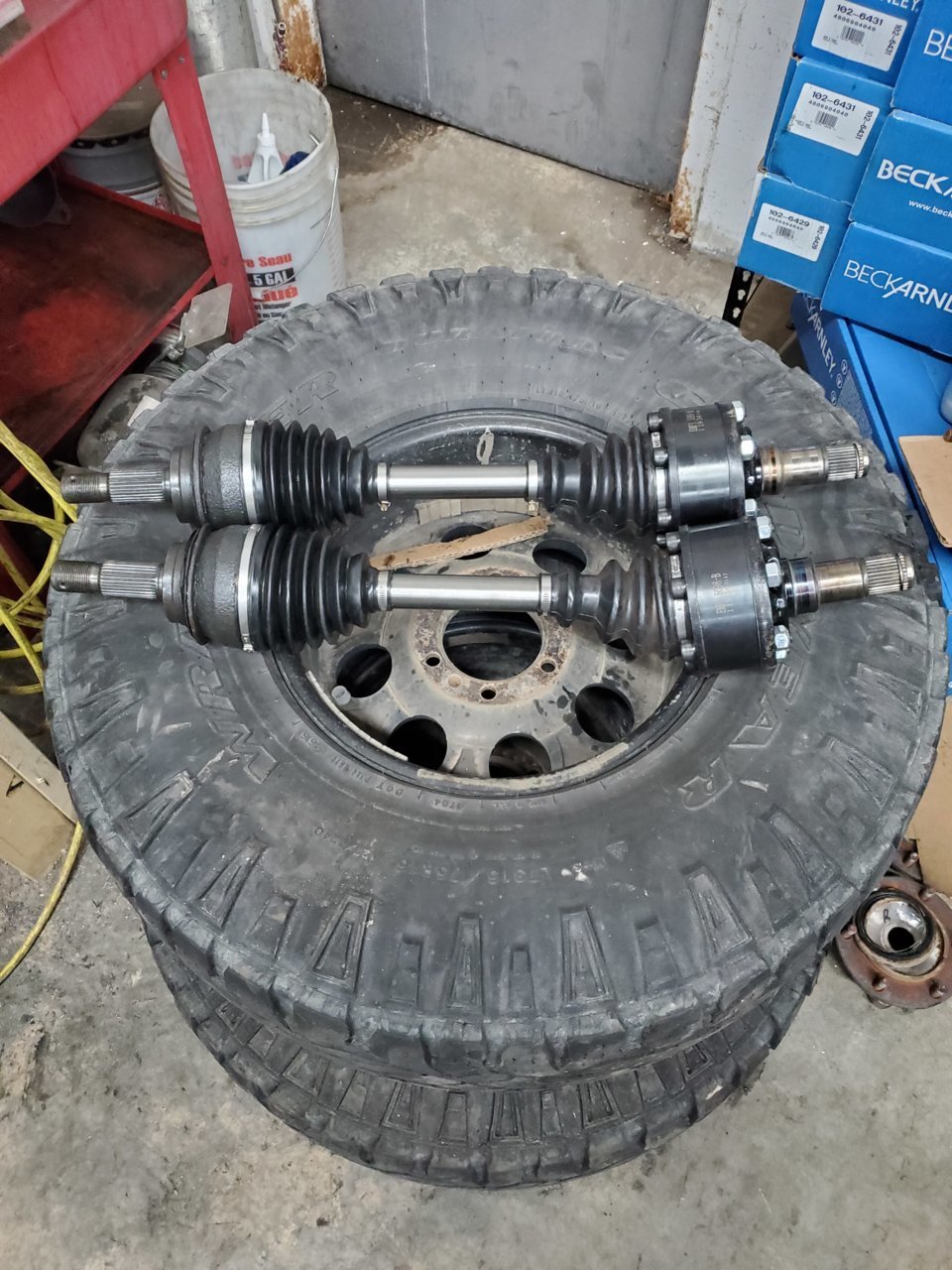

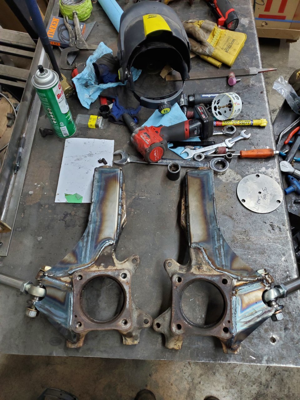

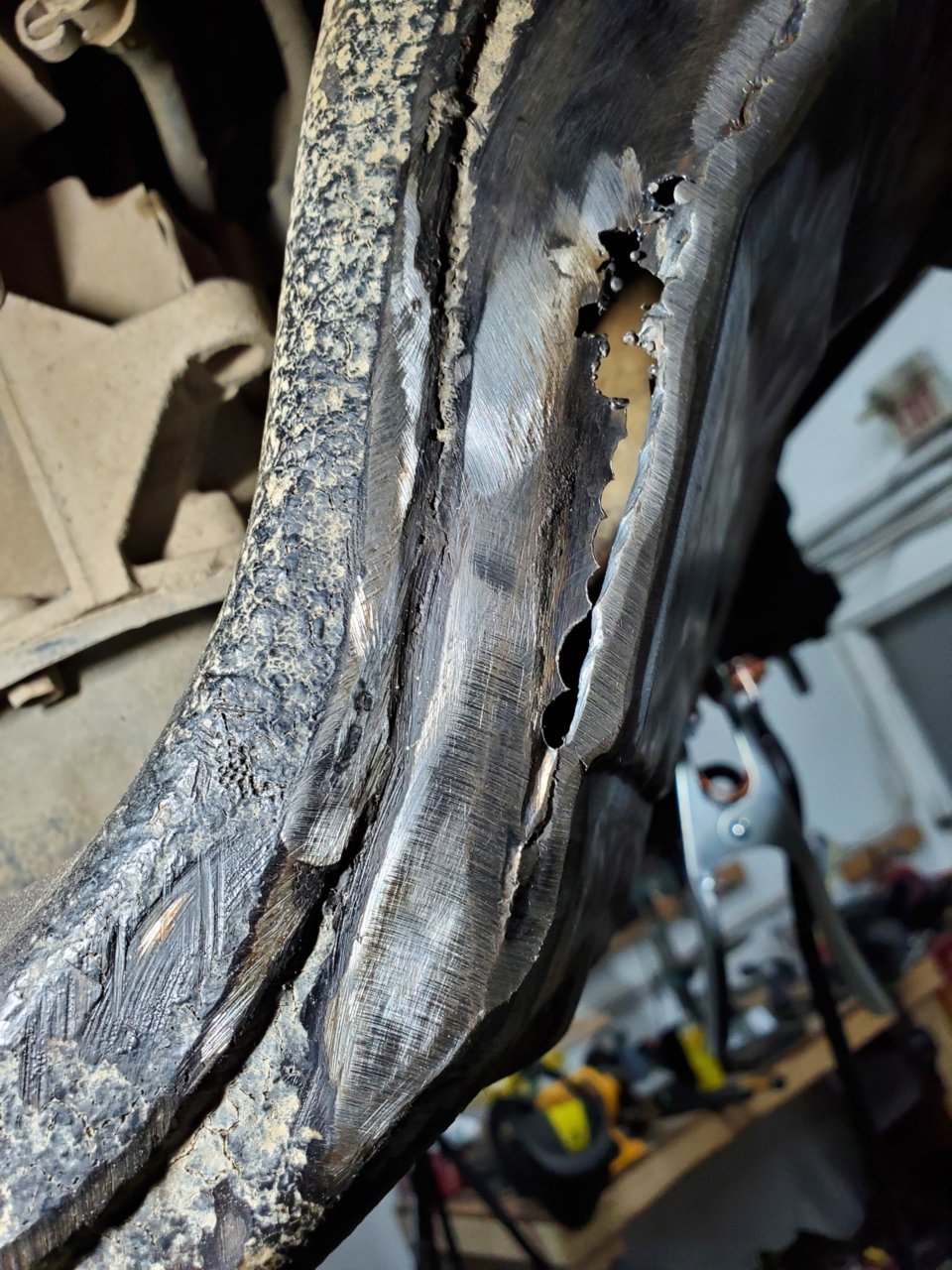

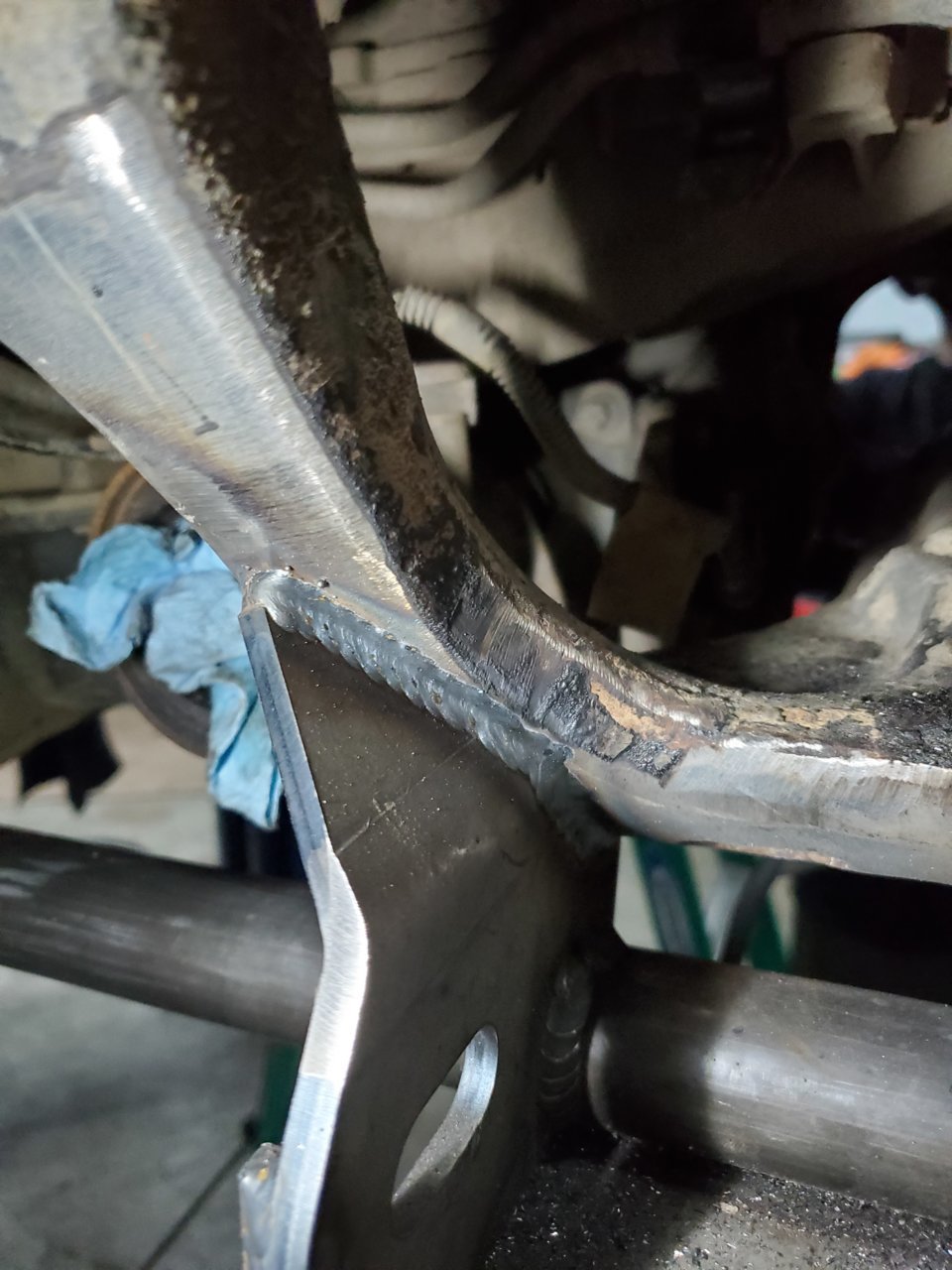

    My truck has been up on the lift for a couple days now and I've been working away on the front end with the help of a few friends.
    JD Fabrication LCA relocation kit, 934 cv's and +2.25 long travel getting installed, along with a new steering rack.
    First was removing everything. I was able to remove the rack without cutting the bolt that everybody talks about, but if I were to ever do it again, I would definitely just cut it. I'll be putting mine back in upside down though, so no worries.
    Then cut off all the LCA mounts and grind it all smooth.
    Then came the discovery that my rear frame cross member is literally paper thin and nearly impossible to weld to....
    I ended up spending a bunch of time filling in all of the holes, and then plating over them.
    Then I welded out the sub frame kit. I'm not a welder by any means, but I'm learning and glad for more experience. I have a few good beads, and a few less good, but I don't think it's going to fall off!
    Also got the spindle gussets with double sheer heimed steering all done

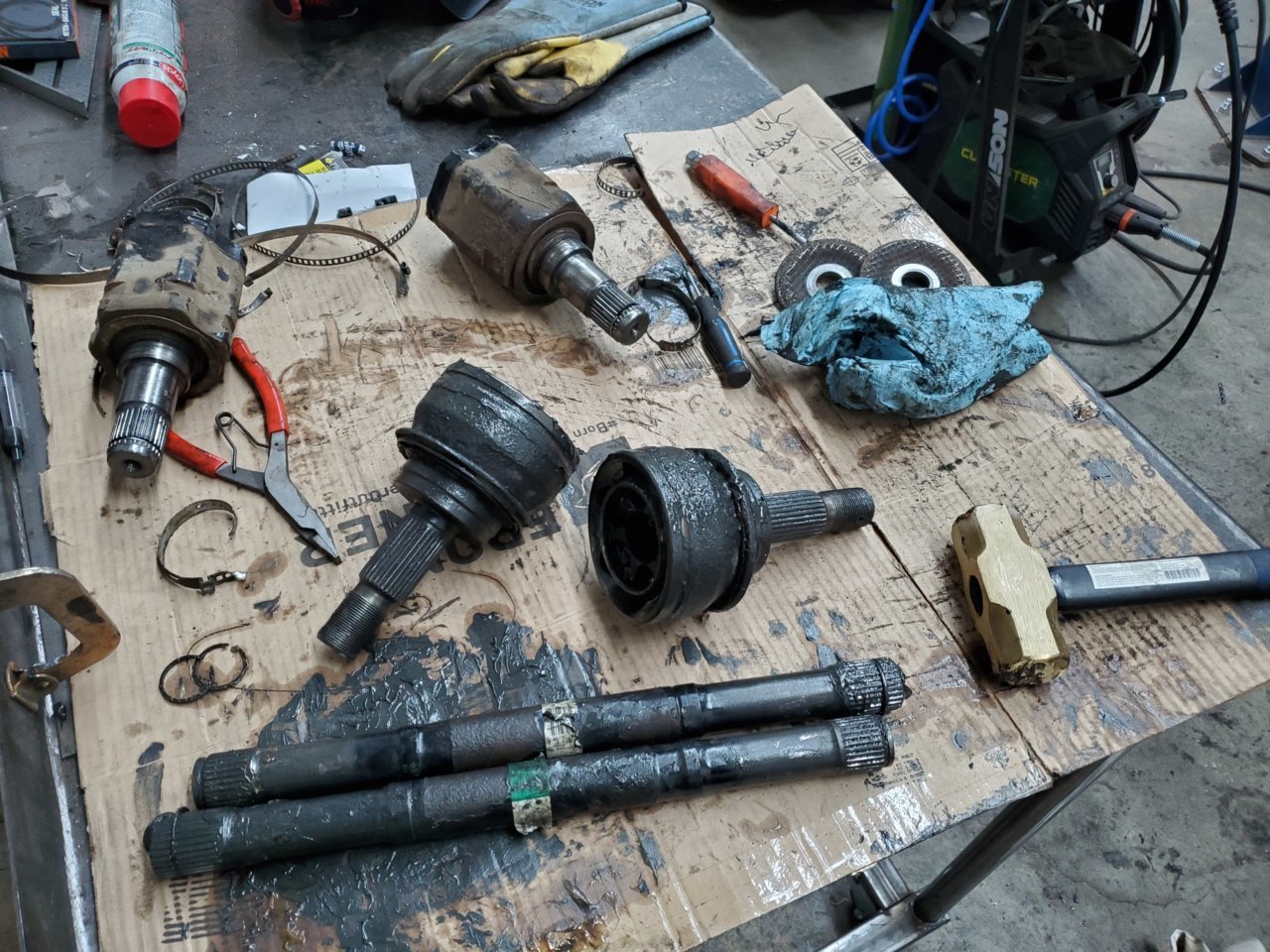

    And one of the things I was a bit stressed about, was getting the outer CV joints off of my stock axles. Everything I've read said to cut the axle off super close to the star, and then completely disassemble the joint, then press the axle out of the star with a 20 tonne press to sheer the hidden c-clip.
    But instead I found a random thread where I guy recommended just hanging the axle in a vice and pounding on the star with a brass hammer while holding the outer CV shaft out of the way.
    I elected to go that route, and the both came off without too much drama! Was very happy to get that out of the way and build up the new 934 axle assemblies. I hate dealing with cv's and how greasy everything gets.
    We did get a few other things done as well and got everything painted with a couple coats. Pretty much just have to bolt everything on and bleed steering/brakes tomorrow!
