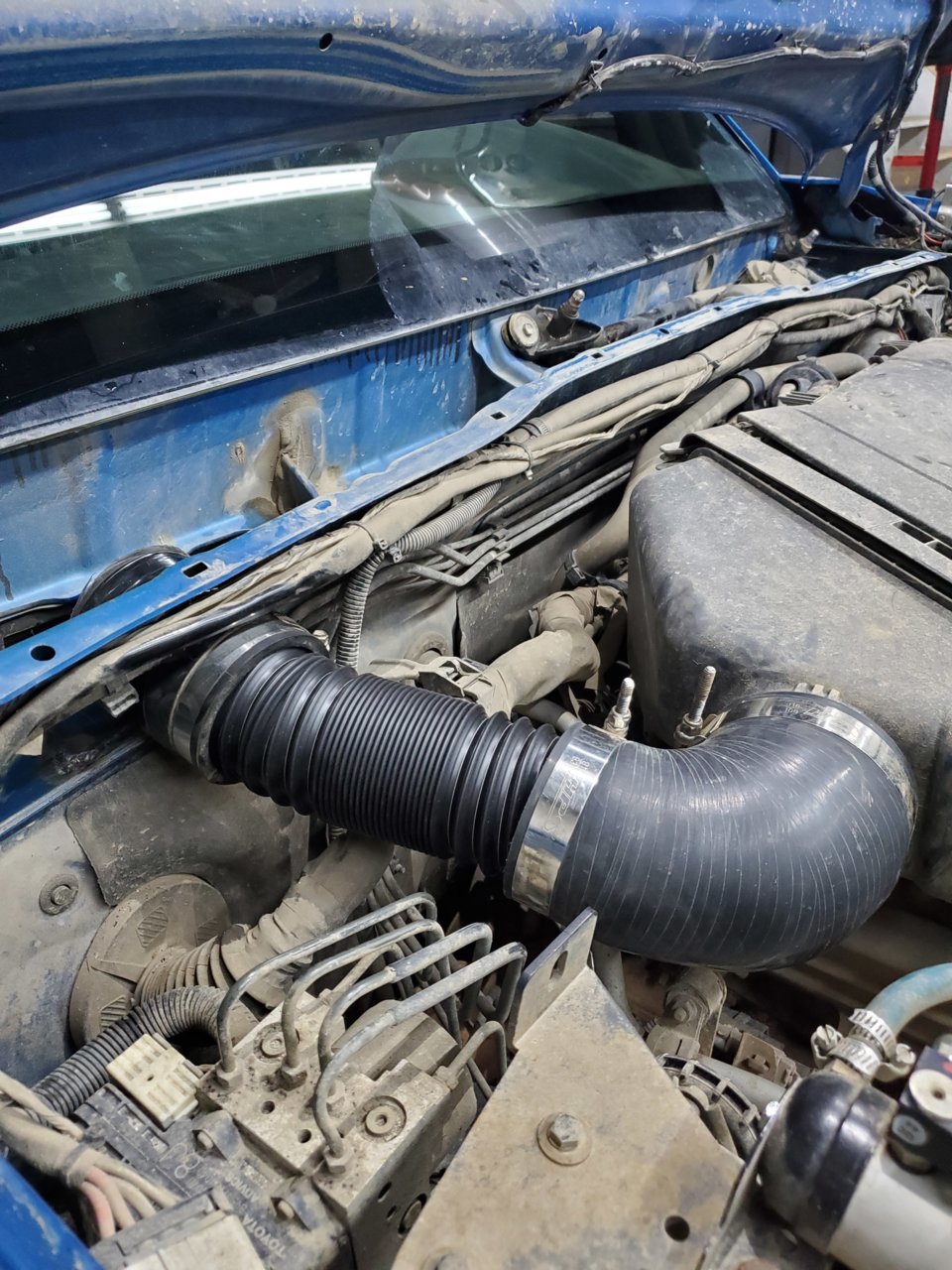

    My dash had this insanely annoying rattle for a long time. Finally figured out what it was. My air intake relocation had cracked the cowl and was vibrating like crazy. Tried to make it tighter and didn't work. Changed it up to a different tube. Instead of a solid aluminum tube, I switched to this flexy plastic intake tube. No more rattle!!!! It's amazing! The rattle was seriously bad.
    I have some ideas that would have made this way way better, but I already made the hole in the cowl too big, so I'm stuck with this setup. As long as it works and doesn't make any noise.

    I used flexible hose for mine and it’s been great since I first installed a couple years back. What all did you do to fit 37s? Been debating it since these 35s are lookin a little small these days lol

    Yeah you definitely did it right the first time!

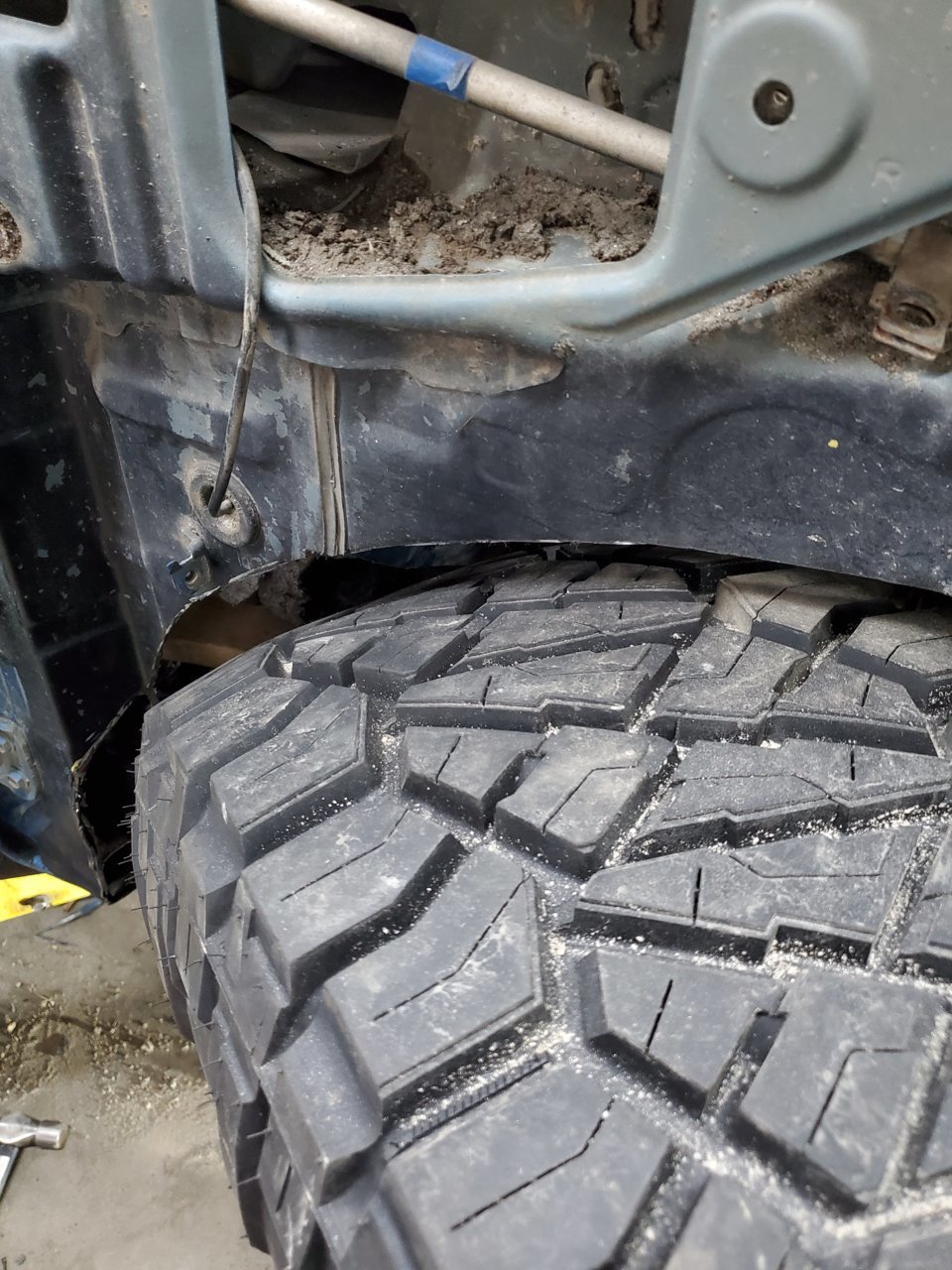

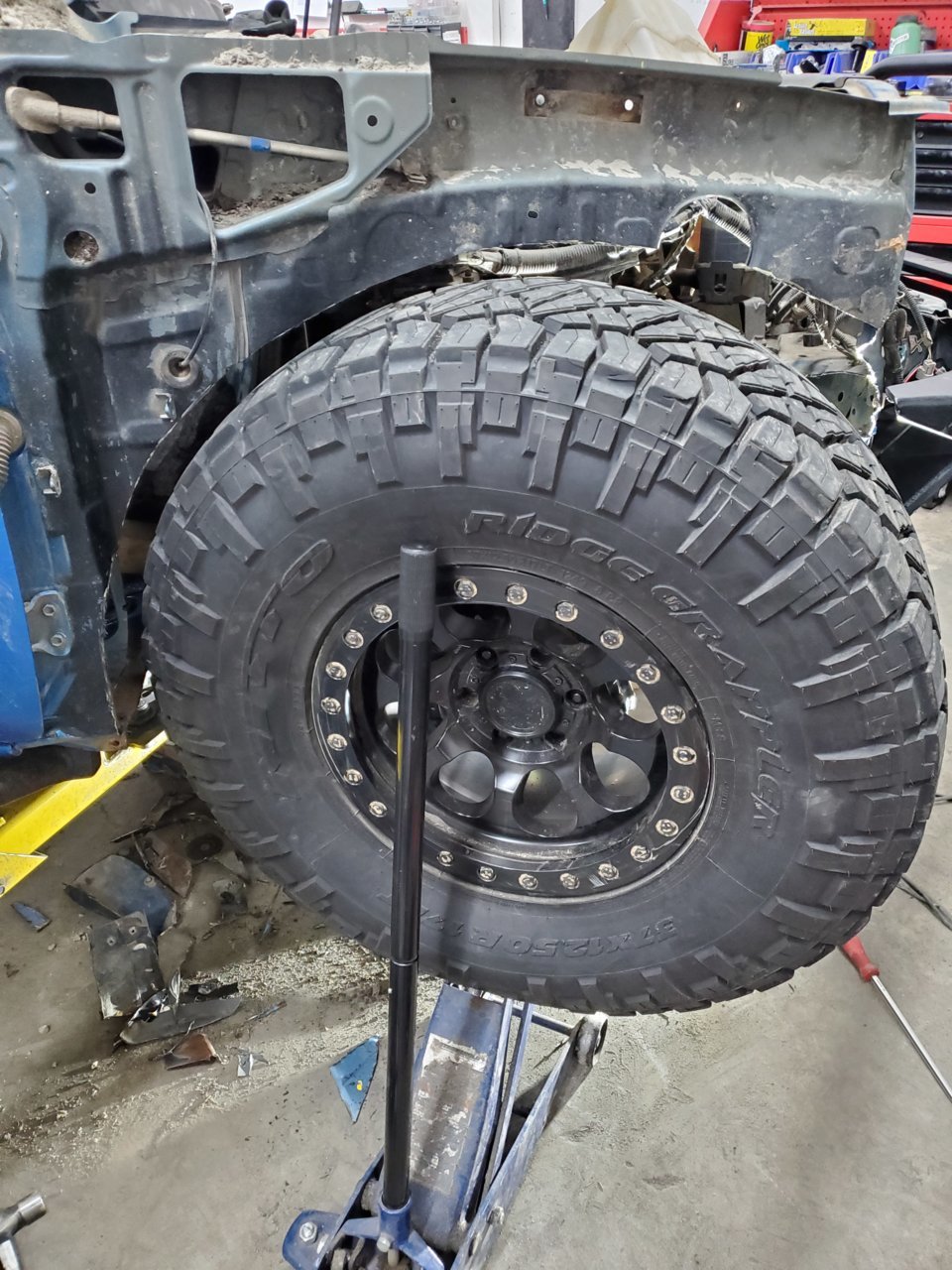

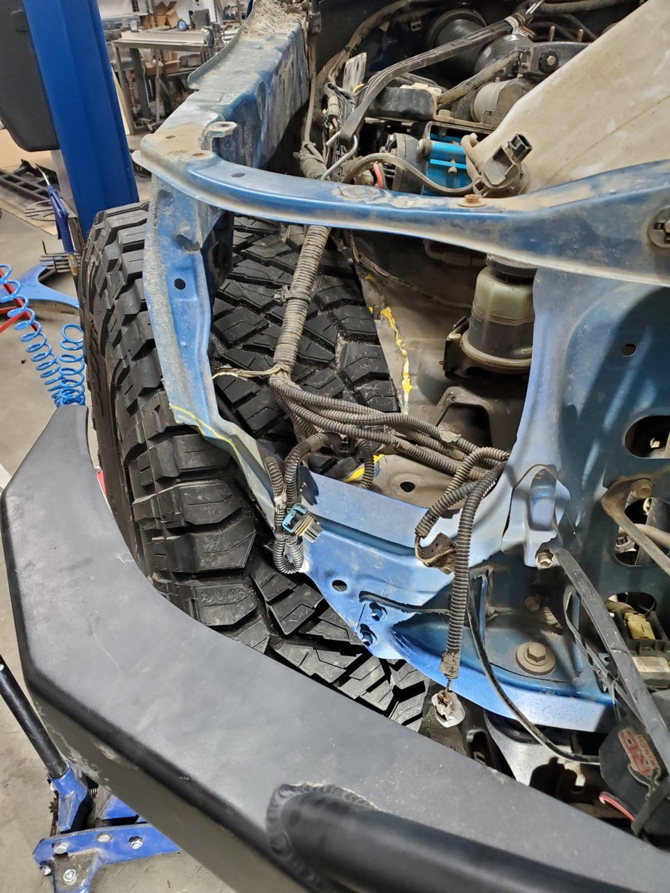

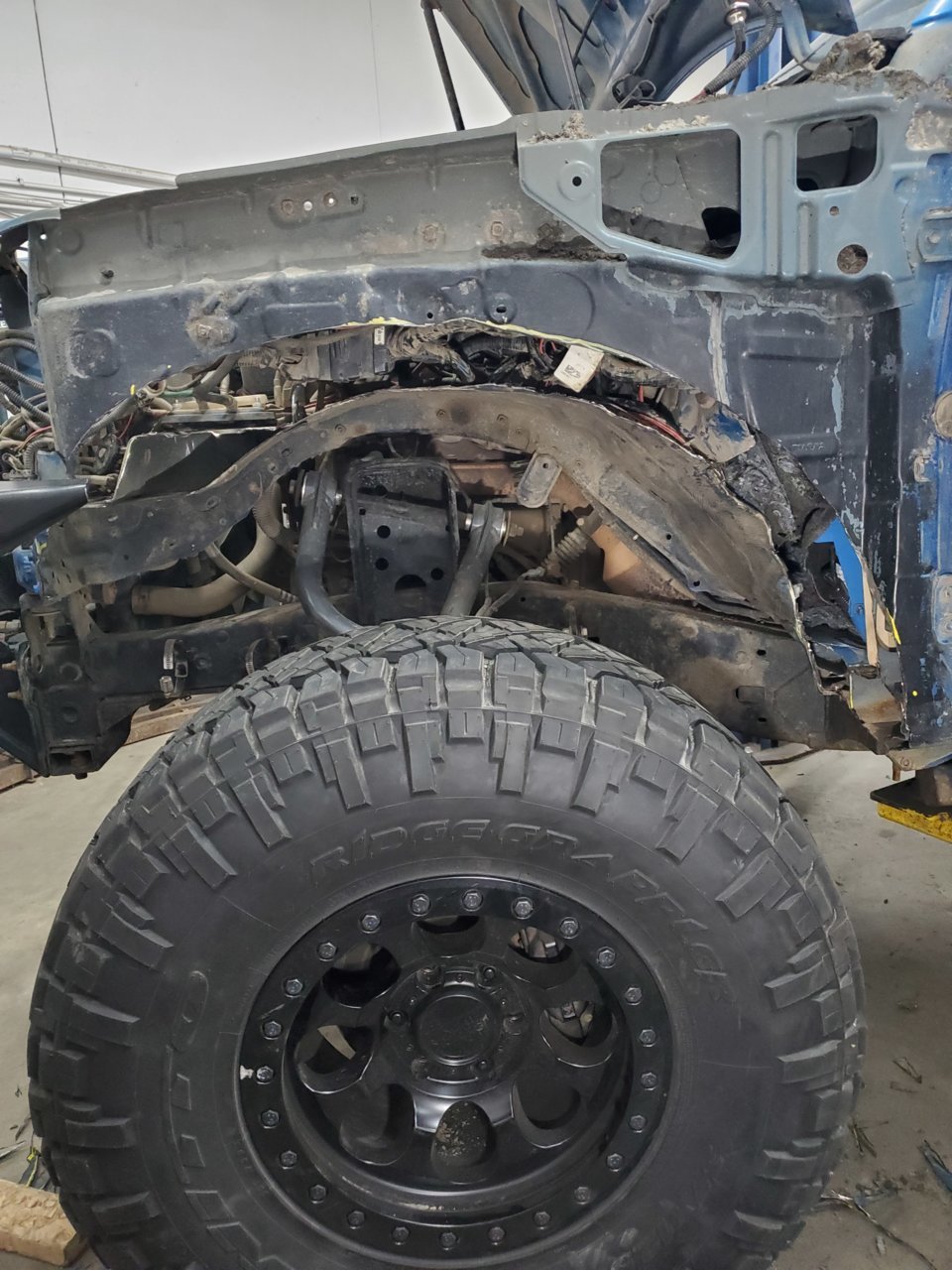

    Tubbing for 37s has begun. Posting lots of stories about it on the instagram if you're interested.

    Just looking at your pics with my 4" kit and more aggressive offset I'm going to be cutting higher at the outside part but not going to have to cut nearly as much inwards towards the engine. It looks really good man! Can't wait to see it all flexed out and stuffing those tires!
