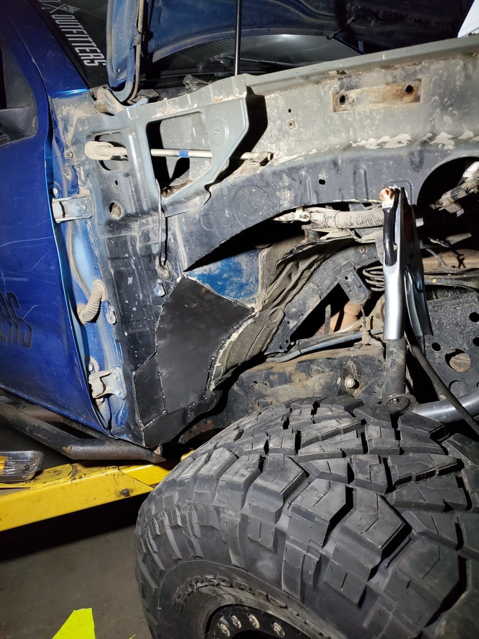

    Just finished the driverside fire wall section

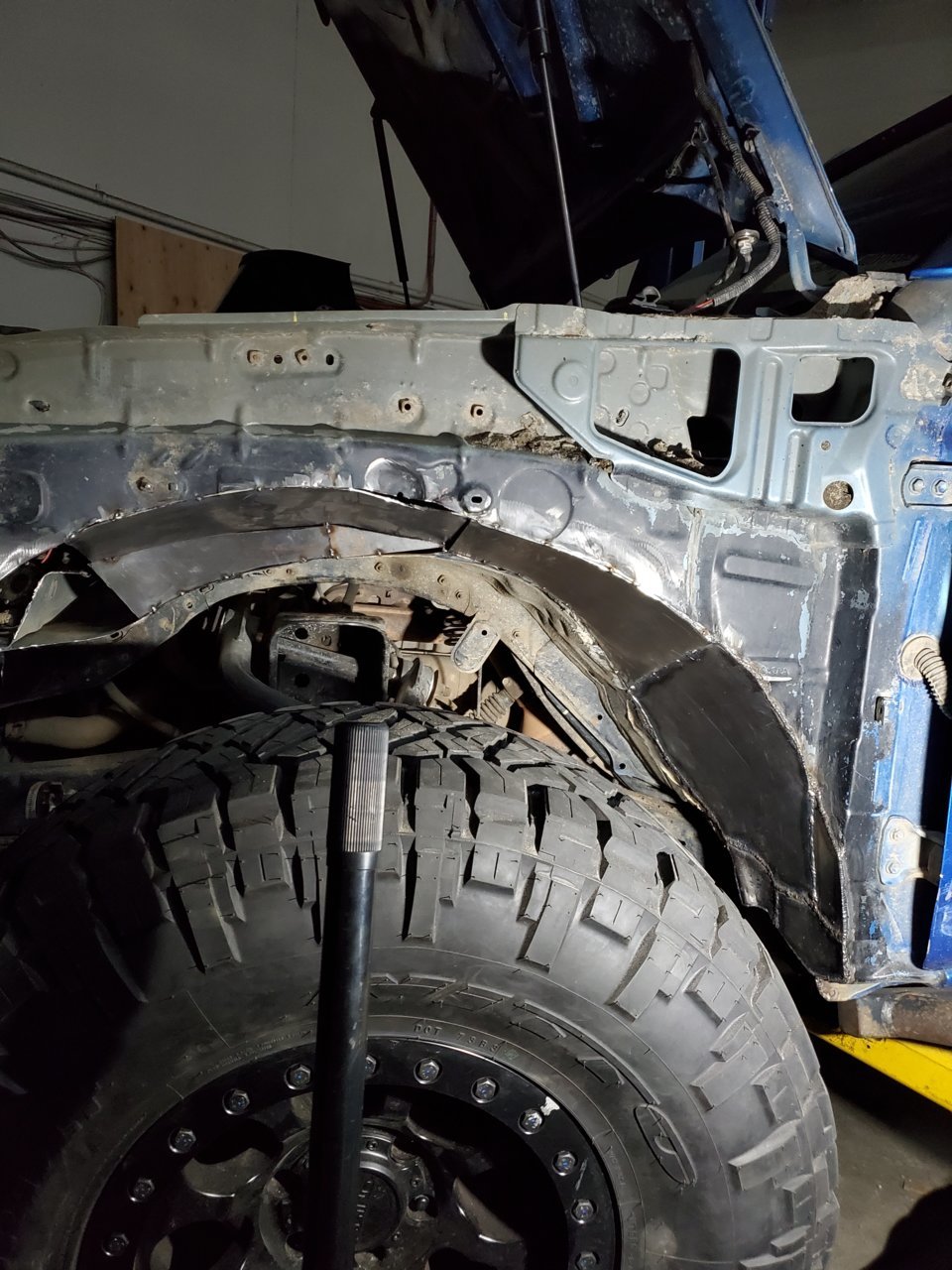

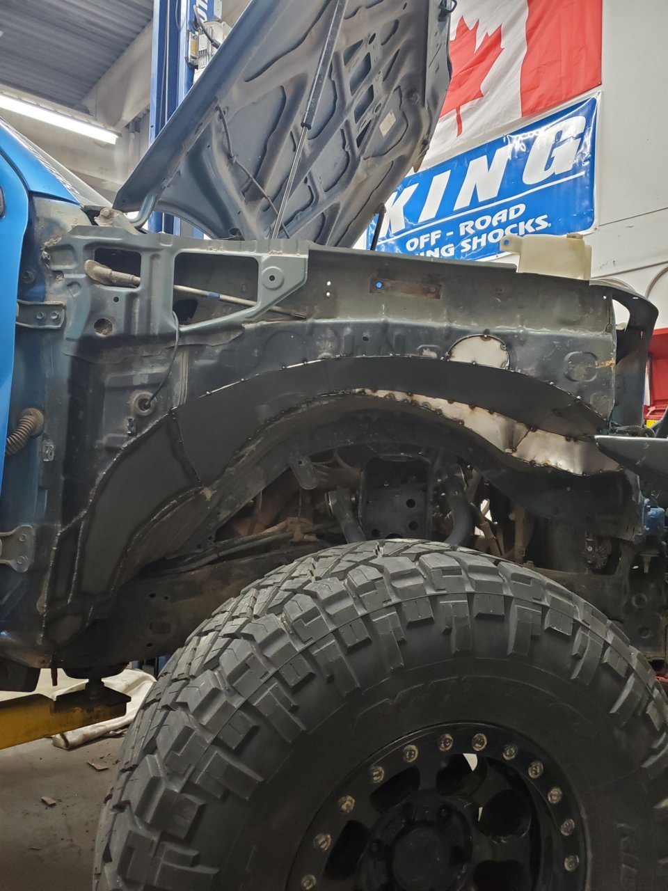

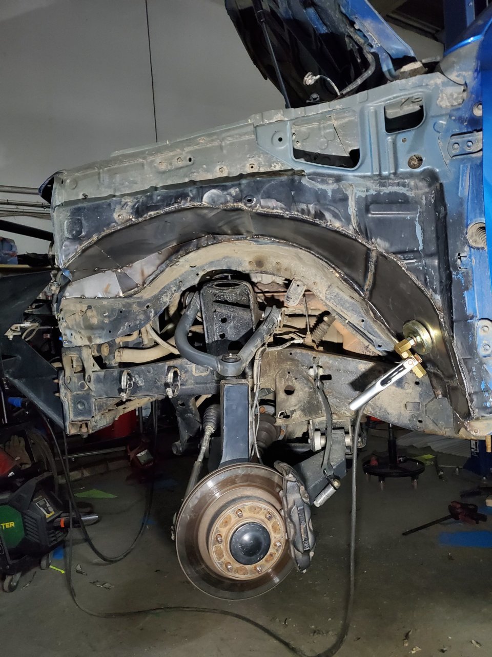

    Finished here for the night. Passenger side cutting was super fast now that I knew how much to cut. Plating everything is definitely time consuming. Gotta weld so slow. Never really worked with sheet metal before20210117_223915.jpg 20210117_223927.jpg

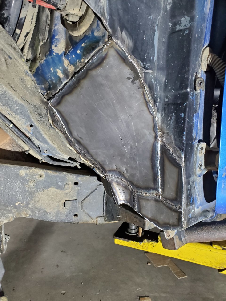

    This spot almost ripped my tail light right off.
    Today's progress. Everything is fitted up and tacked in. Driver side is almost fully welded. Just gotta spend the time welding the rest all up, then figure out how to remount everything, and sort out a new washer fluid Resi, and cut the fenders up, probably past the clip holes.

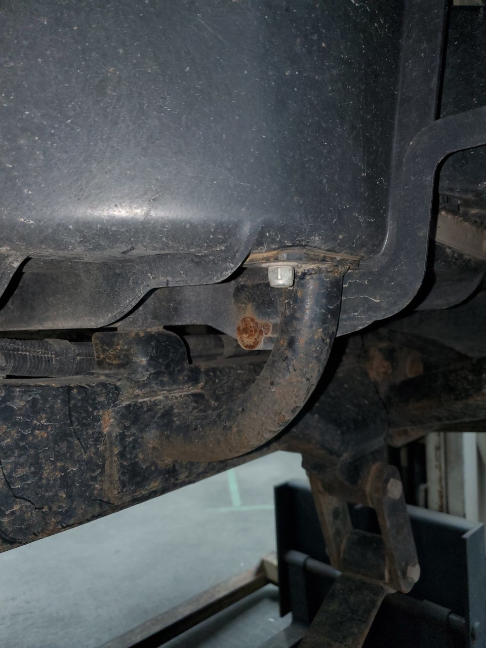

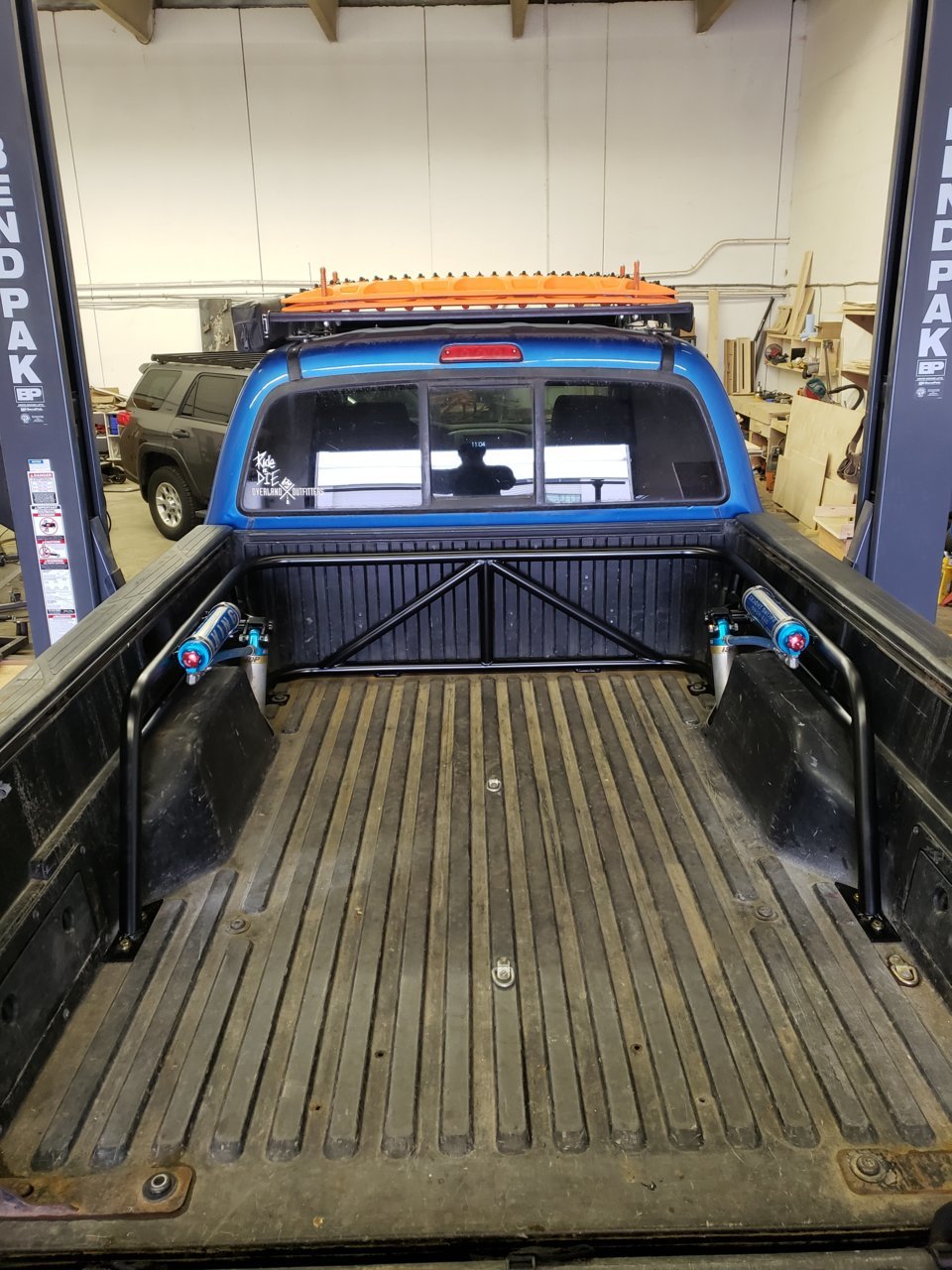

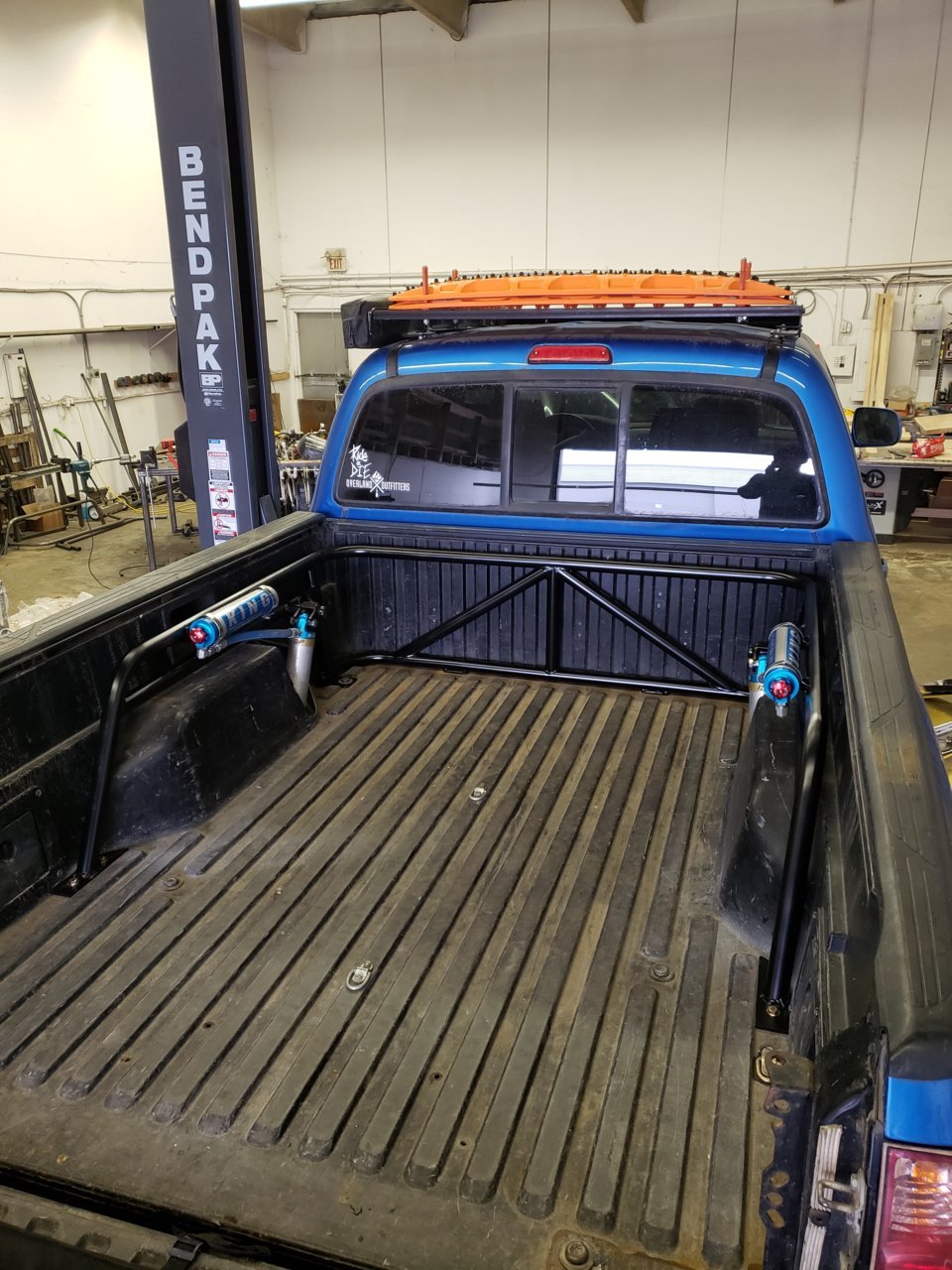

    The 4 bolts on the tailgate side of the cage, they aren't factory points are they? Just run bolts through the frame?
  15. Jan 19, 2021 at 5:37 PM
    #255
    WormSquirts
    WormSquirts [OP] Armageddon
    Dec 18, 2015
    #172583
    2,910
    Braeden
    BC
    Made a mounting point coming off the frame. Only one bolt actually meets it, the other bolt just sandwiches the bed with a plate on the other side.
