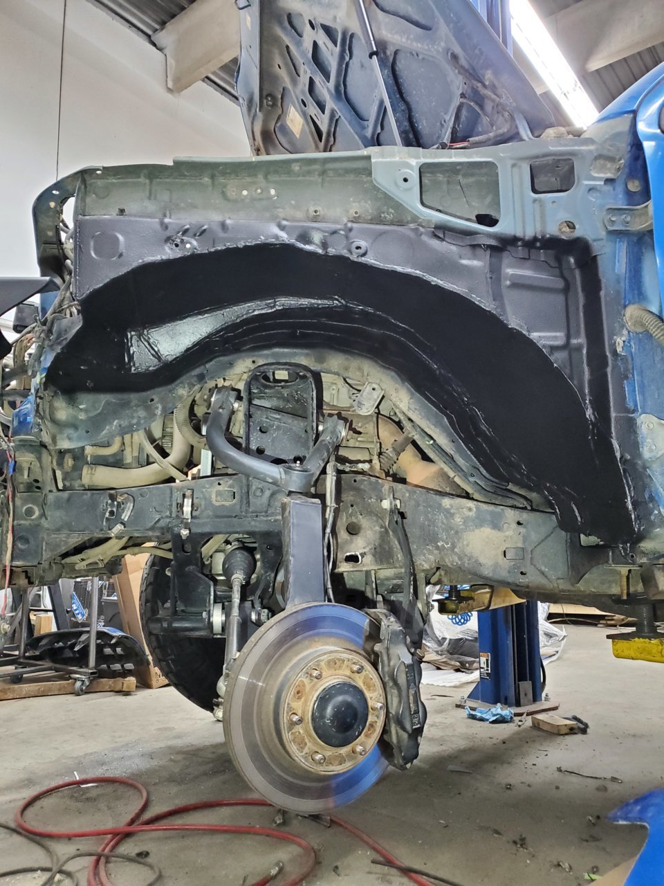

    20210124_003603.jpg Tubbing is finished, fenders are cut back more. Front bumper is cut back. Now I just have to fit everything back into the engine bay somehow. Also need to figure out the best way to support the headlights and front of fender
