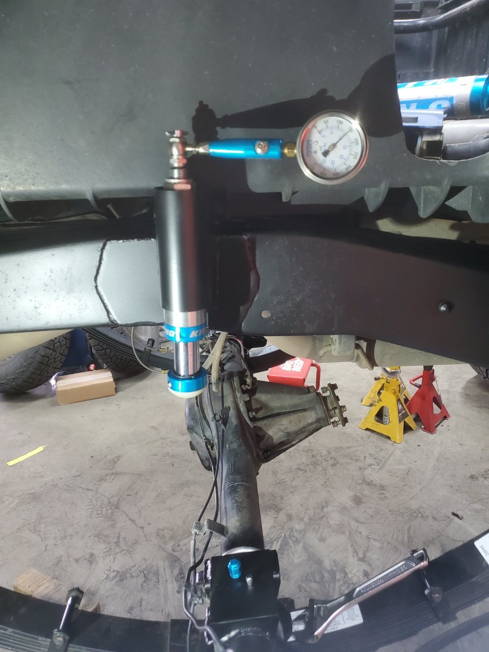

    Been plugging away at the SUA swap. Took about 3 hours for a friend and I to pull the bed, cut off all the 63 swap stuff, grind the frame smooth, and get the Sua mounts bolted on... After that things really slowed down haha. 20211024_150359.jpg 20211024_150507.jpg
    Rusty frame issues as always, but working through it all. Going to have to modify the bed cage a bit, but waiting for more shock tabs to show up. Gotta get the truck rolling first thing in the am though cuz a customer truck needs to go on that lift.
    Also had to get my new driveshaft shortened cuz the axle moves so far forward at full droop.
    20211025_184631.jpg 20211025_184700.jpg 20211025_185458.jpg 20211026_234222.jpg 20211026_234247.jpg 20211026_234239.jpg
    The bed cage almost work d perfectly, but the upper Mount needs to be around 2" higher and 2" further back, so I'll have to re do that. But that's only at full bottom out, so I can do that next week, and drive it in the mean time.

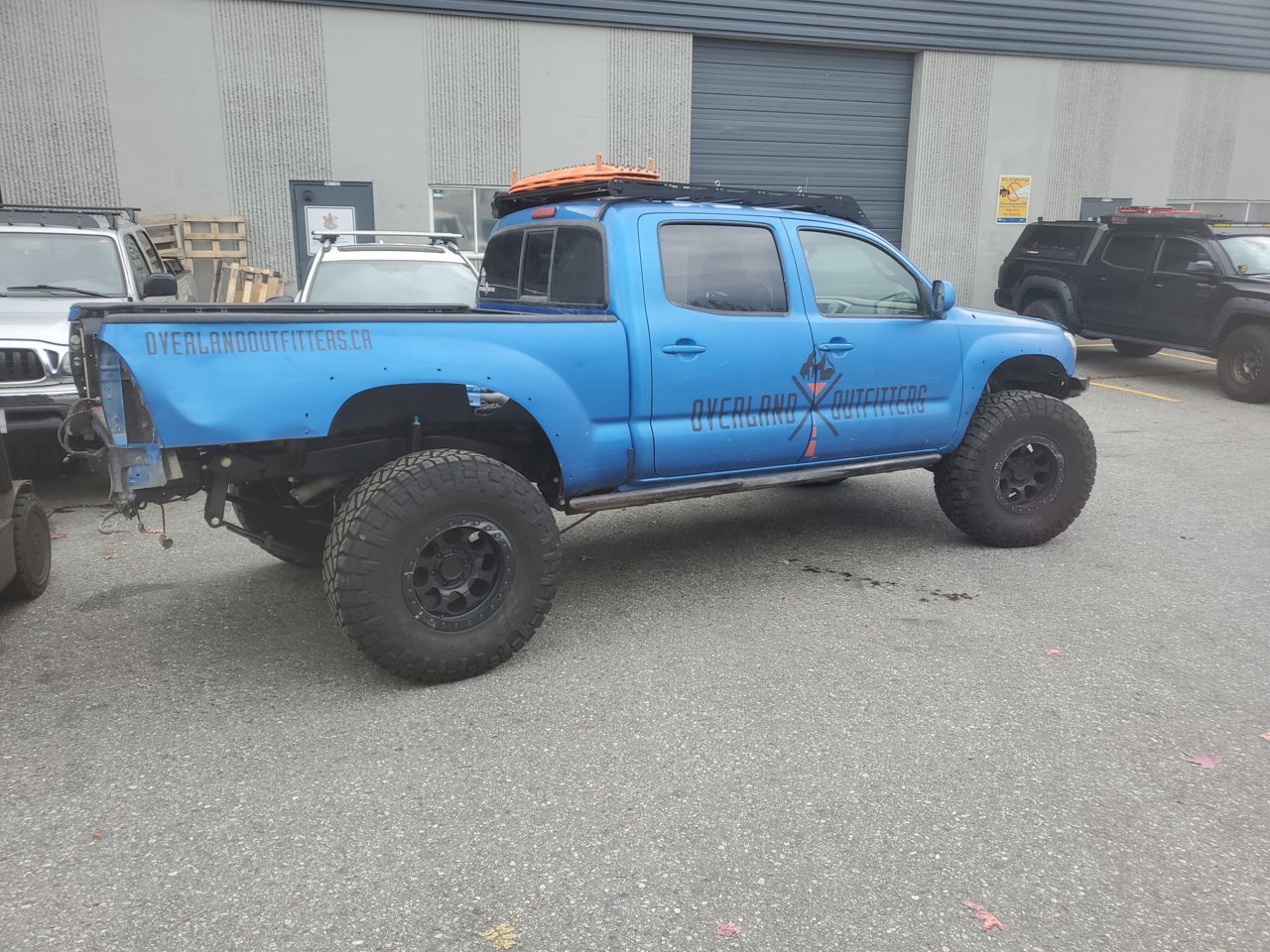

    On her own weight. Much happier with the ride height than I was with the 63's! Still need to sort out the upper shock mounts, and my bumper doesn't fit any more as the supports hit the hangers and shackles... Never ends does it.
