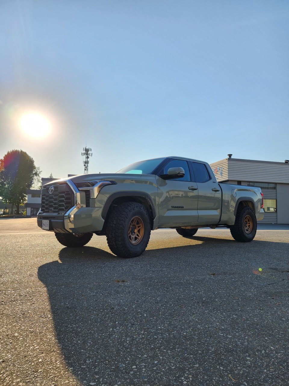

    I don't daily it any more because I needed a real truck for work stuff:
    I was constantly putting the RTT on and off basically every week. So I drove lots with a completely empty bed, and also lots with the RTT. For camp trips, depends where we are going, but usually have camp gear, spare, two mountain bikes, paddle board, and 20L water.
    I only take my spare on Wheeling/camping trips, and usually just leave it at home for around town.

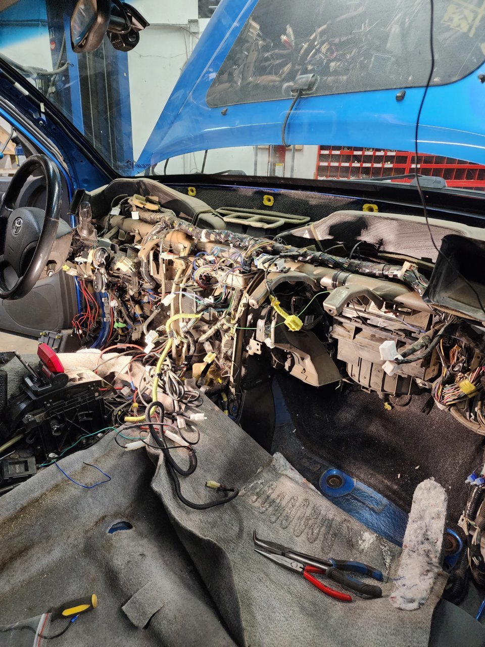

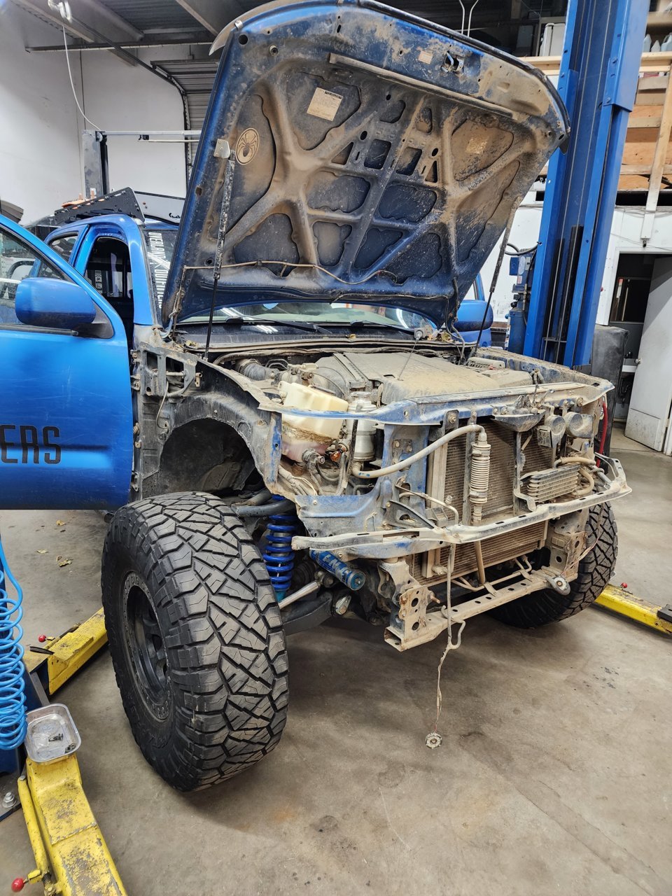

    I recently got to go to the desert with the JD fab guys, and experience what real prerunner life is like...
    So basically I will be completely rebuilding the tacoma. haha. Now that I have the Tundra, I can really dig into the taco without needing it for work all the time. I will need to do the build in 3 stages or so, just because I don't have enough room in my shop for it to sit for a year straight.
    So the plan is the following:
    full cab cage, seats, harnesses.
    back half with 8"shorter wheelbase, tube bed
    Fibreglass
    engine cage
    Patch up the holes in the frame
    Install the front bypasses I have sitting around.
    Clearance for 40s
    I have some ideas for the front suspension I'd like to try, but we will see how much time I have.
    LS swap. am looking at L92's and LQ9's, with either a 4l80e or 6l80e
    Holley Terminator X
    Ford 9" fabricated housing
    fuel cell
    4link with trailing arms
    This will all be spread out over a few phases, so I'm expecting to do a lot of things twice, but it's just the way it's going to have to be unfortunately.
    The goal with this truck is that it will be streetable that I could drive it 4 hours or so without it being too painful, be able to rock crawl on our local trails decently well, that it will whoop in the desert hard enough that I can keep up with the JD guys good enough that they'll invite me out, and finally, that I can still "overland", which means RTT, fridge, room for camping gear, and I will attempt to also fit all of our mountain biking stuff + two mountain bikes.
