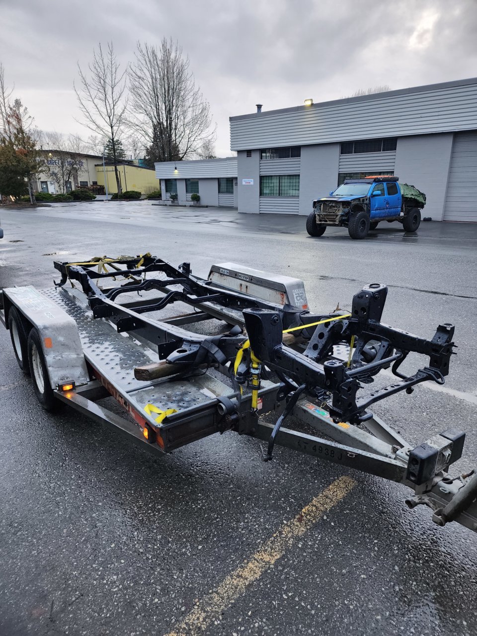

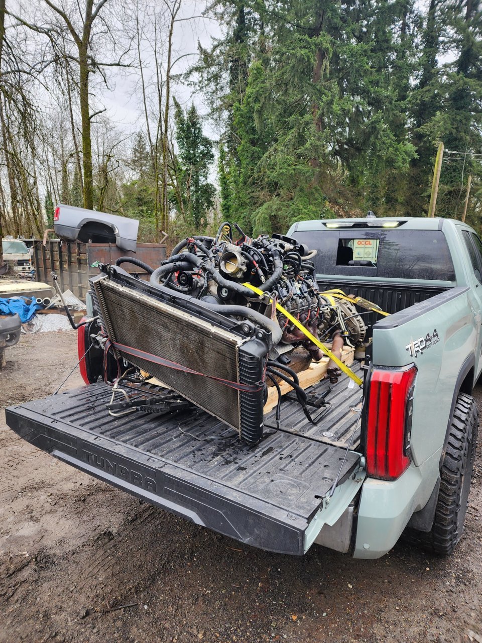

    Picked up a brand new frame and the ls today. The frame was a super good deal. It is for an access cab, but I'll be back halfing anyway, and doing some body mounts is no big deal. I figure since I'm relocating the front cab mounts anyway, I'll probably move the whole cab back 1-2" for a bit easier clearance for bigger tires. Will have to check on head light clearance though!
    Very excited.

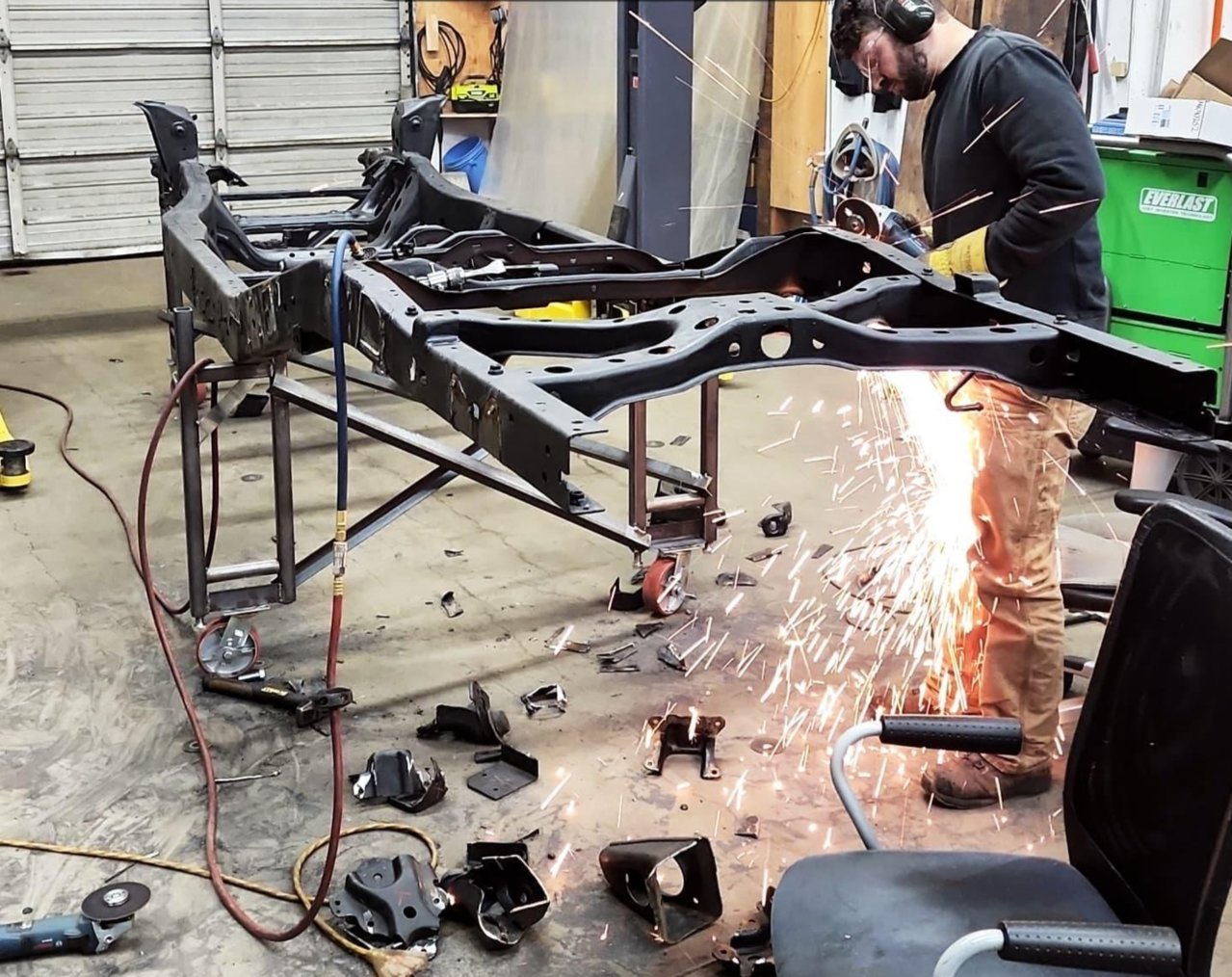

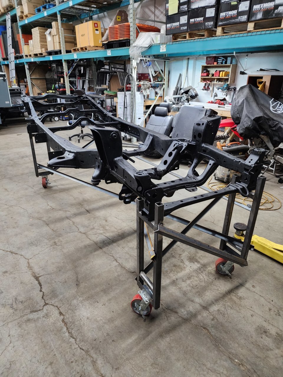

    Made a quick frame dolly so I can move the frame around easily in our small shop.
    My friend and I got almost every mount rough cut off in 1.5 hours tonight. Little bit more to go, then clean up and the frame is ready to weld stuff on. Sure goes quick when there's nothing in the way.

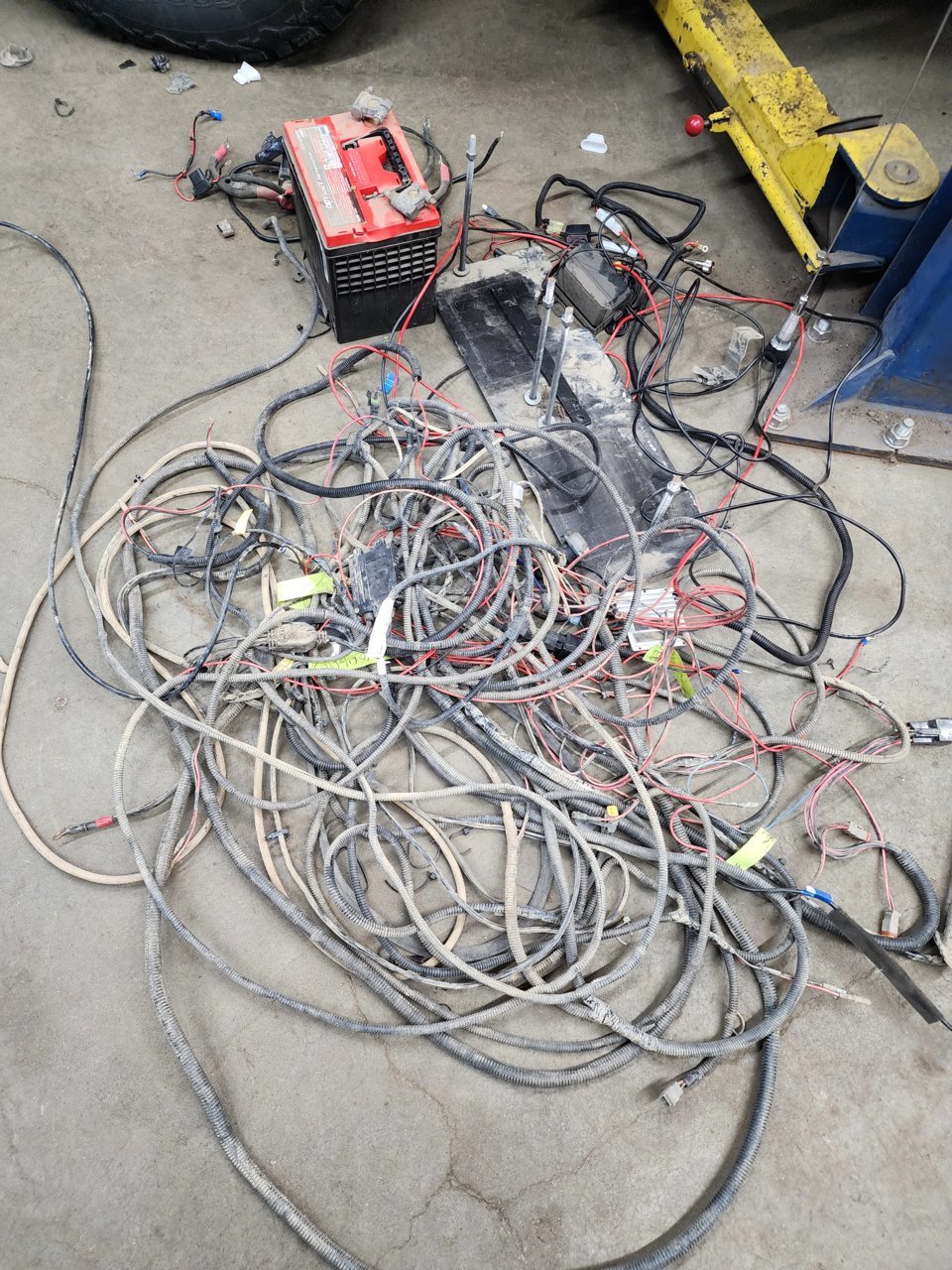

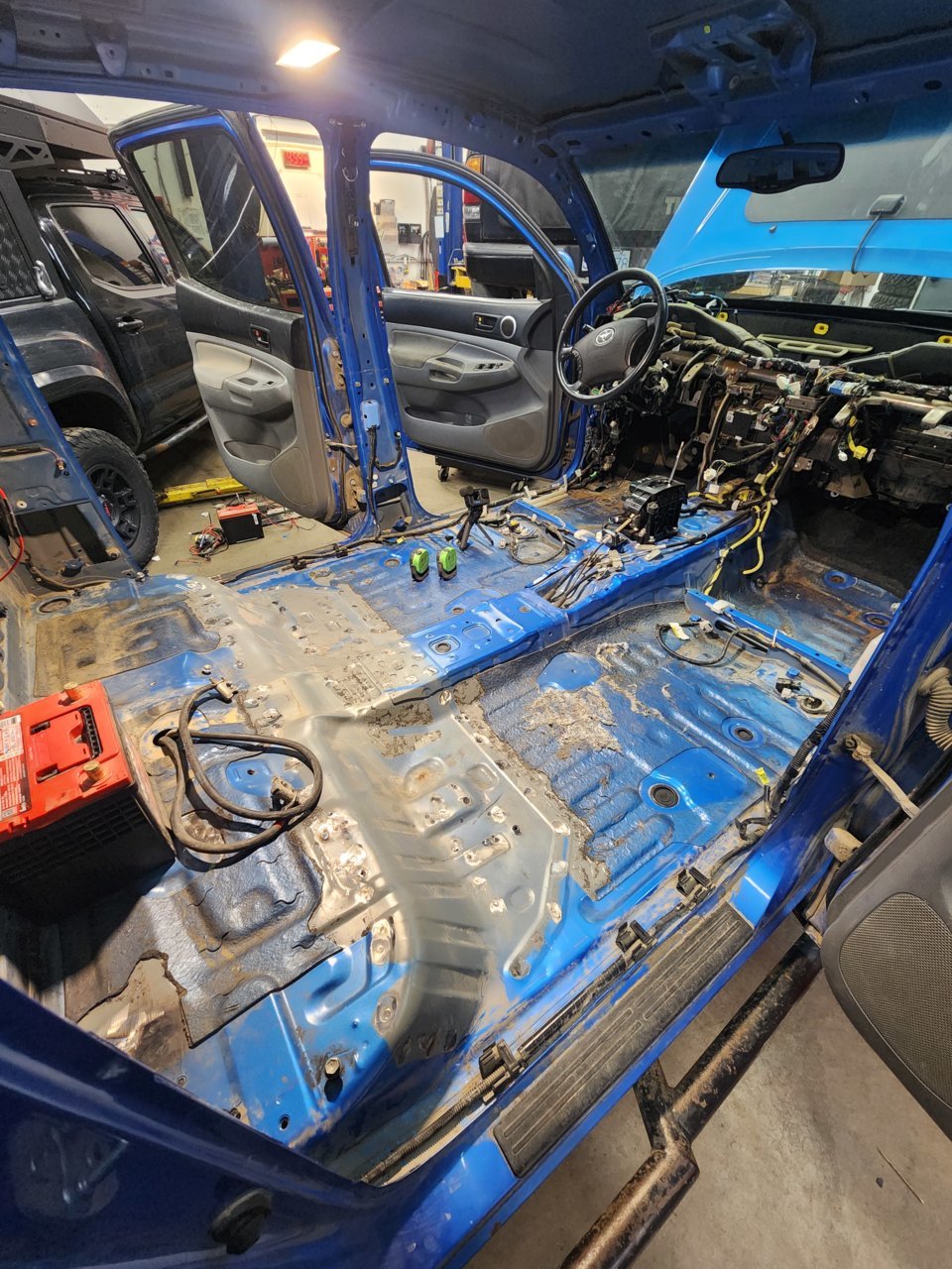

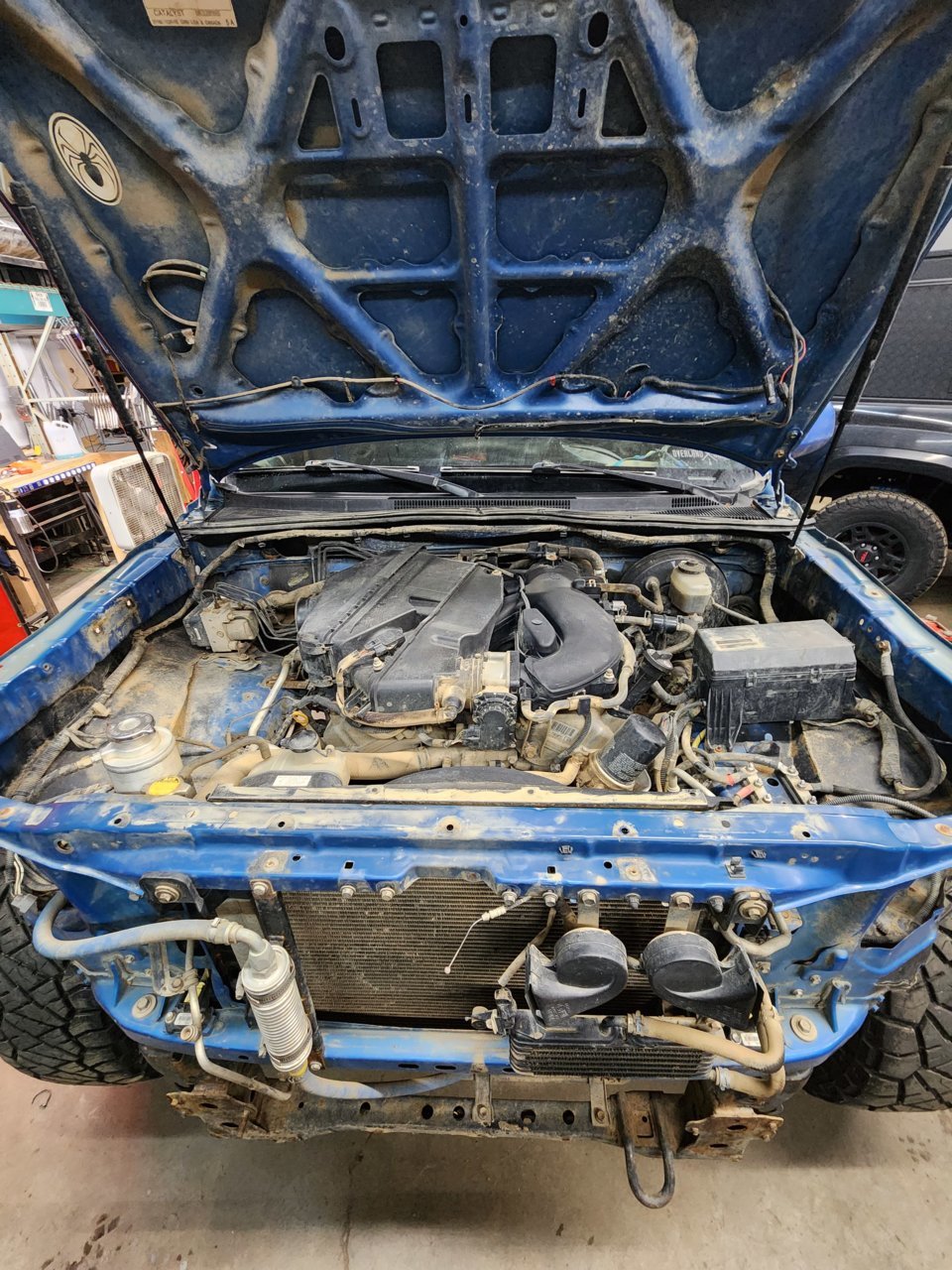

    Got some progress in this weekend. Slowly chipping away at it. Got all of the mounts off the new frame, all necessary rivets removed, and everything ground down smooth. Also pulled all extra curricular accessories from the truck. It's basically stock now! Have a few more things to pull tomorrow like the sliders, etc. Then I'll start stripping what I need to off the new engine.
    Truck still drives currently so I can move it in and out of the shop so it's out of the way during the week.
    Still sorting out what tcase to use, probably np241.
    Anybody have wiring diagrams for the airbags? I want to completely remove all of the airbag wiring.

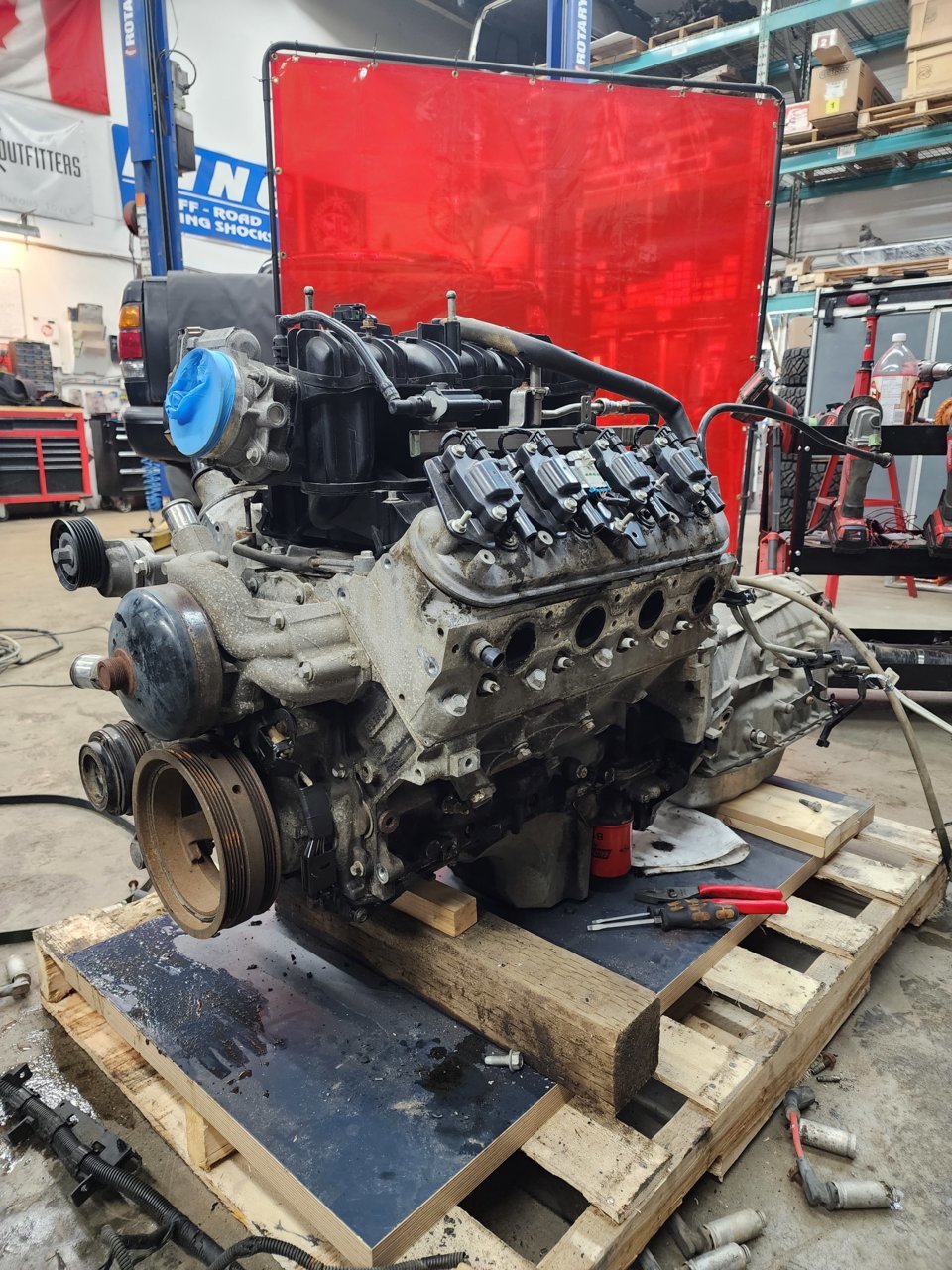

    Started pulling the engine apart today, gunna go buy a motor stand and pull the heads and pan off, clean and check everything. Gunna throw a cam in it as well I've decided. Not sure which one yet though. Looking at the btr truck Norris cam currently20230123_175322.jpg
