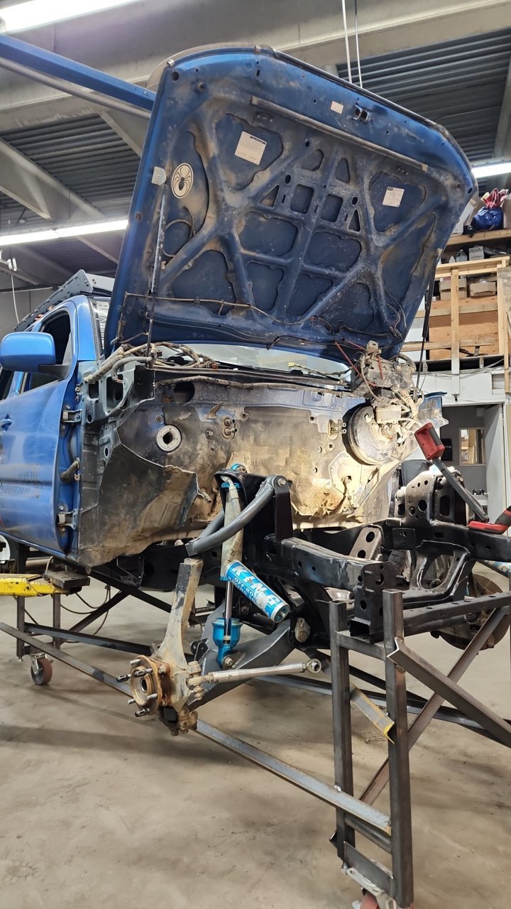

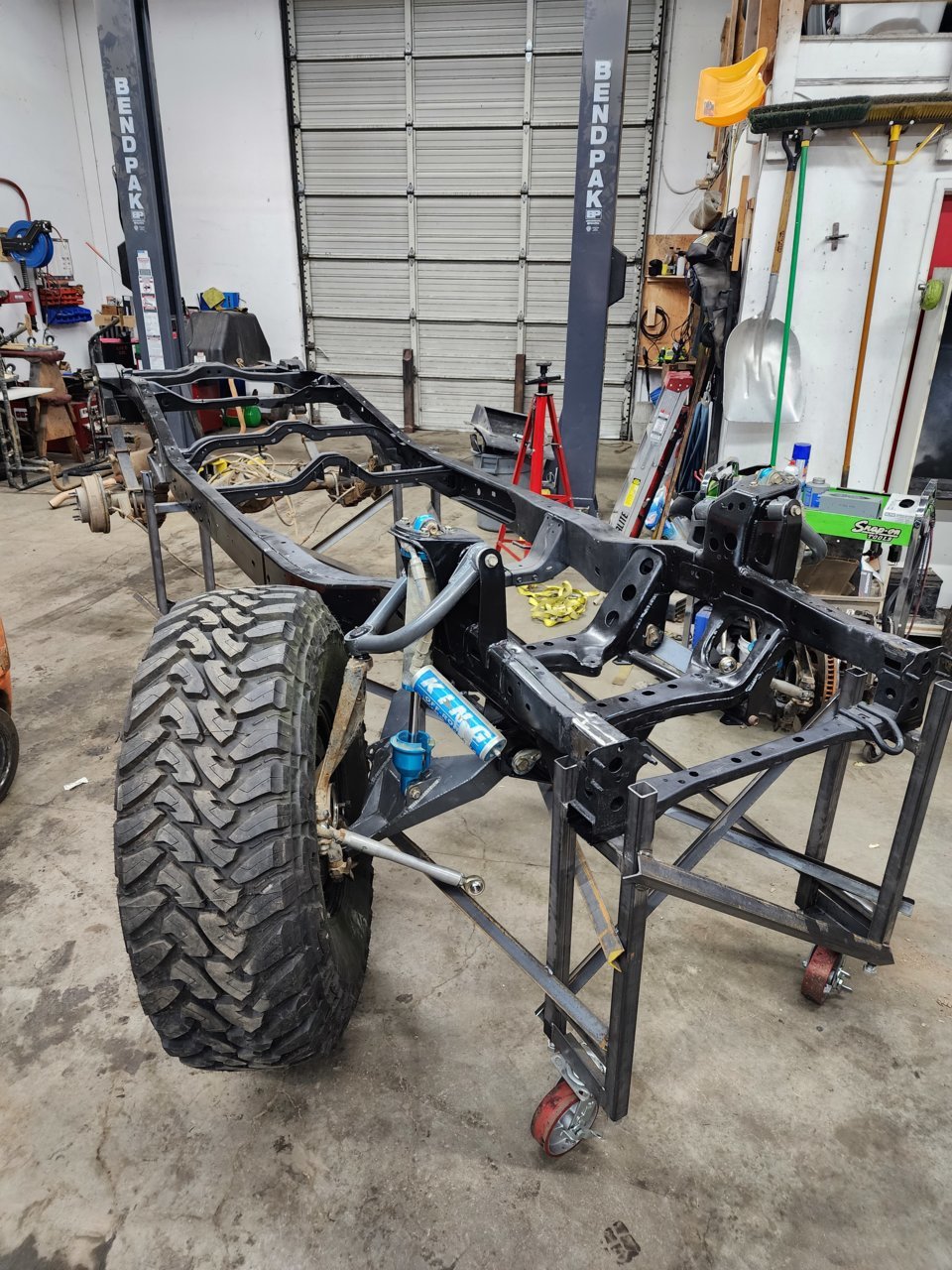

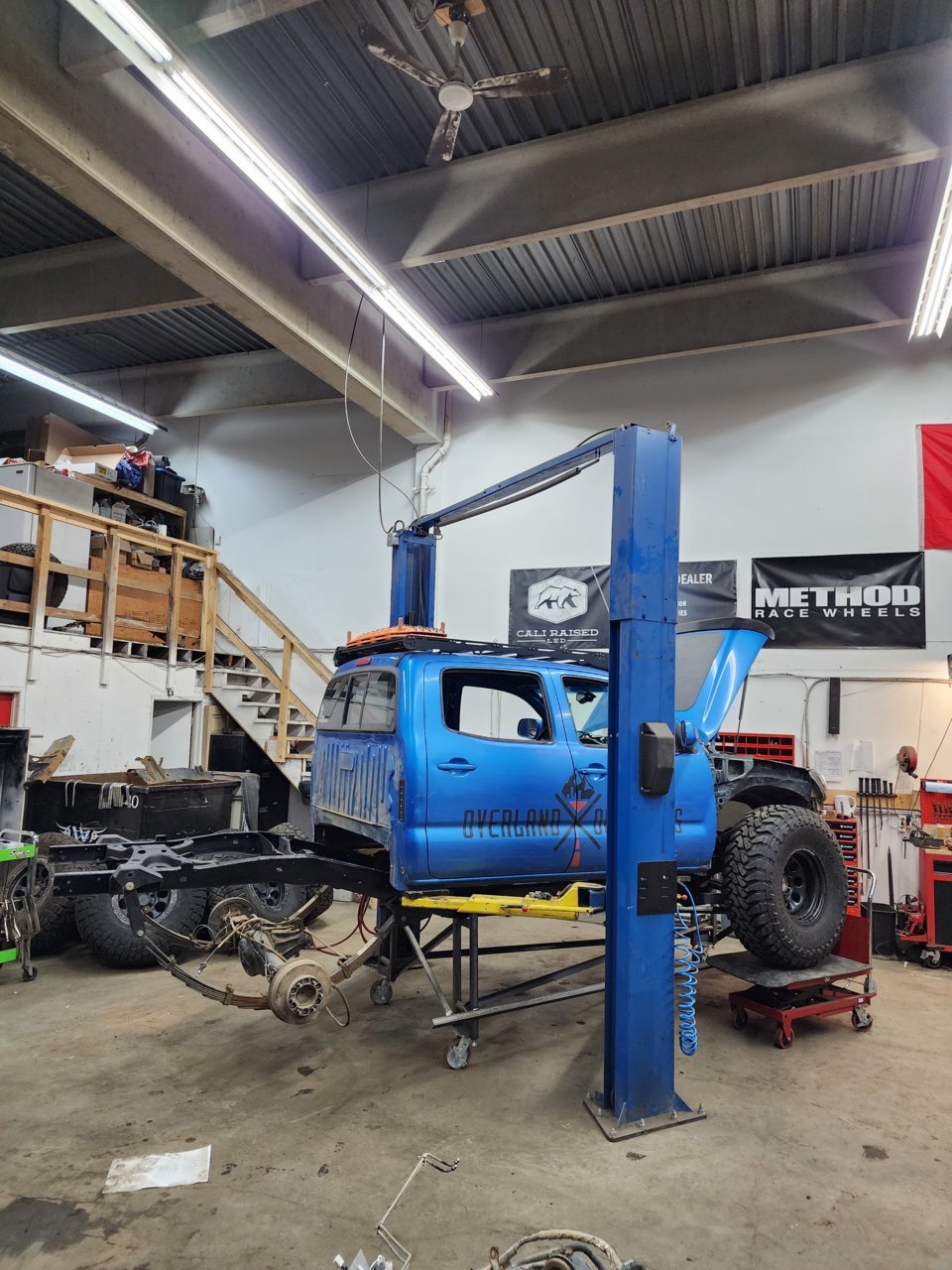

    Got the cab off, and the old frame is chopped up and stuffed in the recycle bin.
    New frame has suspension loosely mounted so I can cycle with the 40" tire. I just have a bit of the wheel well / core support left to locate the headlight. Am moving the cab as far back as I can while still clearing the headlight. Need to cut out a frame crossmember to tuck it back a bit further, though the cab might hit the frame where it swoops up.

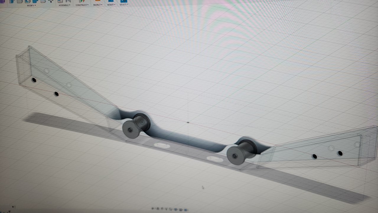

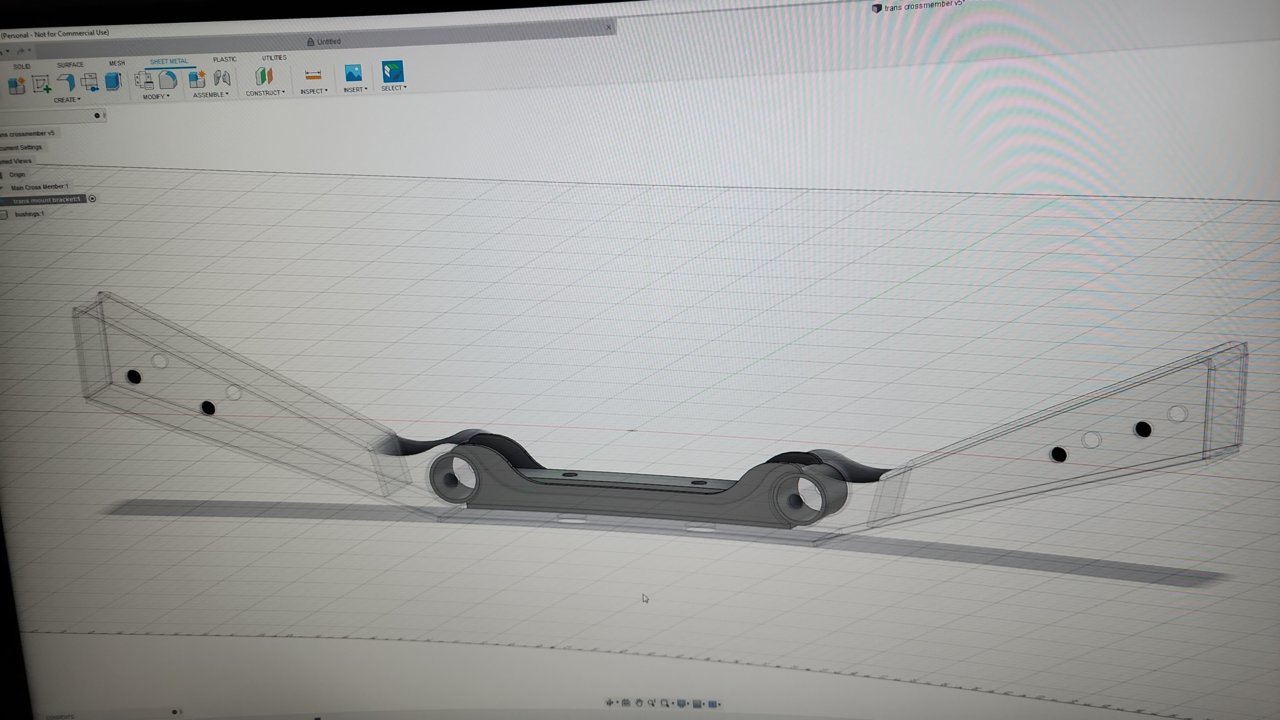

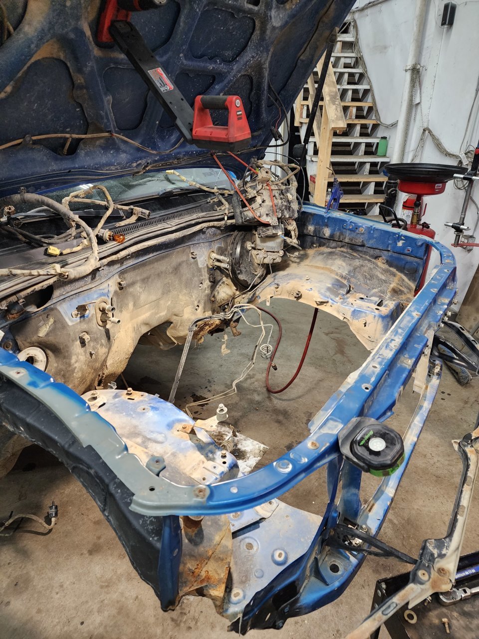

    Got the cab mounts made and the body located on the frame, so could cut the front end off
    Gotta put the trans on the motor and get those located so I can get the engine mounts tacked, as well as get final dimensions for the trans crossmember I've been designing as my first cad project. Aiming for flat belly if I can, but as long as I can get ride of that anchor of a crossmember, that's a win. The trans will bolt to the mount which will bolt to the crossmember, which will bolt to frame mounts welded to the frame that I haven't designed yet. Very excited for my plasma table to arrive!

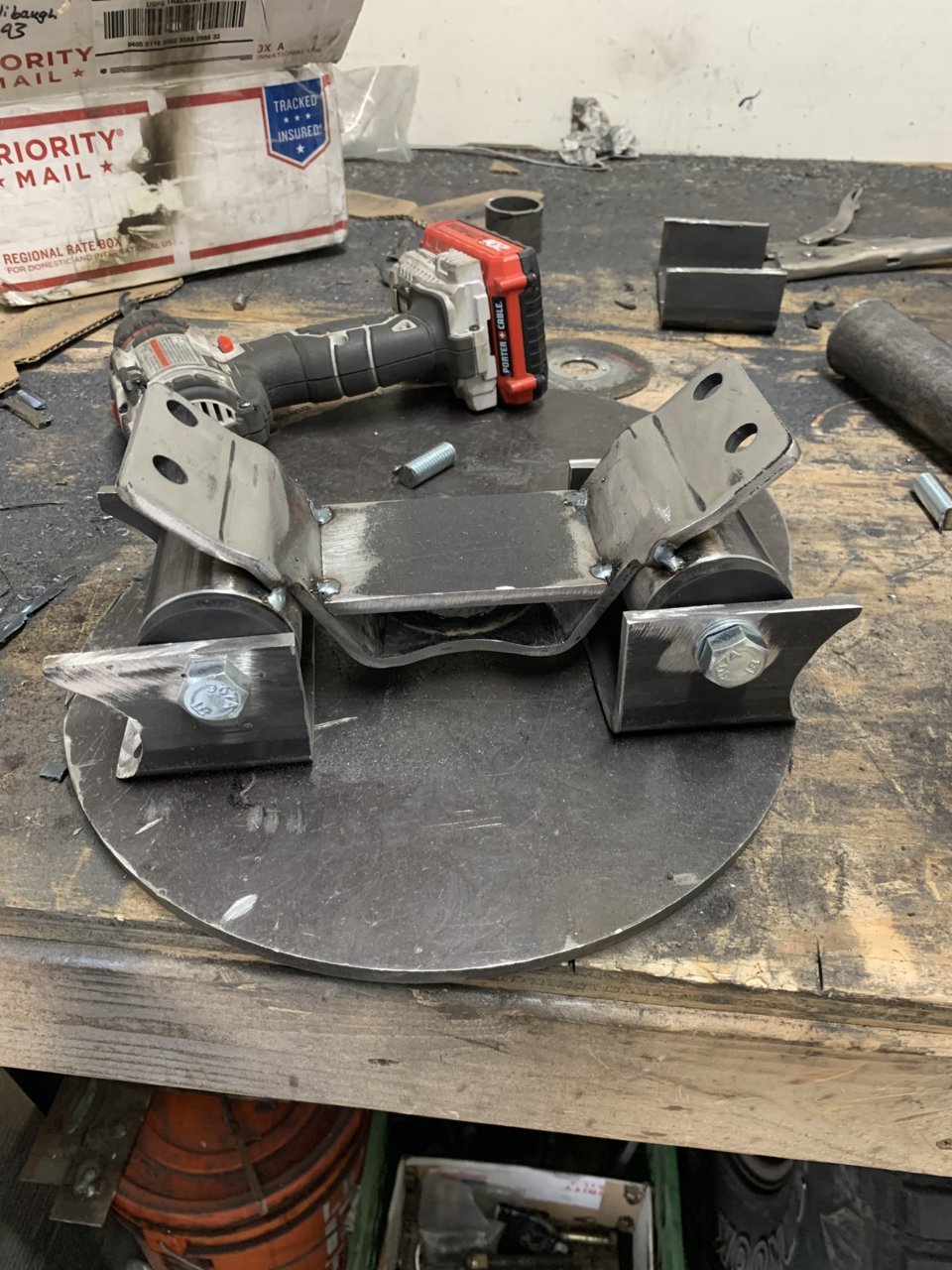

    It can be done!

    Hell yeah!!! that's awesome! nice work. What a difference that must make offroad for clearance. insane. really cool to see such a similar design for the actual trans mount too, bit of proof of concept.
    I hope that I can clock the np241 up like that with the blackbox underdrive. I think I should be okay. Stoked to know it's possible. I really want to plate all the way across so there's nothing to get hung up on, but I also don't want to trap all the exhaust heat in there, so probably not the best idea.

    It really does make a huge difference, I rarely even scrape there anymore, there are only a handful of scrapes there over the past three years of running it like this all the way from the dip back up after the IFS crossmember to the back of the Tcase. I would try to leave it open if possible, not sure that plating everything over has that much of an advantage anyway, havent seen any scrape marks that would indicate that I ever was hung up in that gap.
    That should be a good case/crawl combo, what tranny are you mating it to?

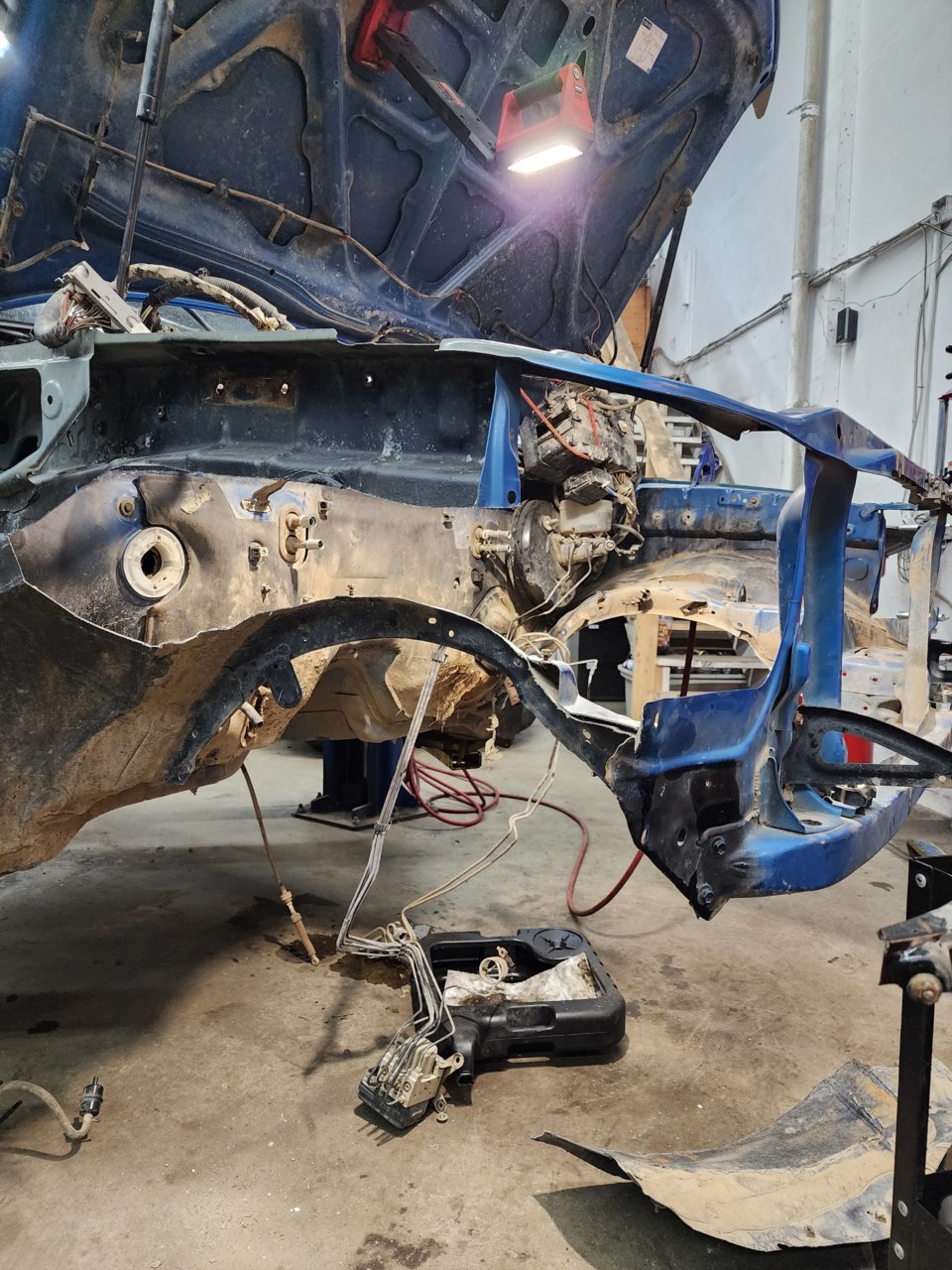

    Got the rest of everything pulled out of the cab.
    All TPMS and airbag wiring is removed from the harnesses, just gotta pull out all the abs stuff now. There's probably a few other things I can pull out as well, but that will work for now.
    Ready for sound deadening everything!
