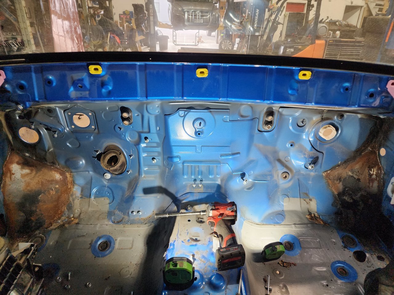

    wondering if this truck will even look like a tacoma after its all said and done also hope you dont mind me asking, what inspired you to go this deep? I'm loving this build...

    Honestly I never intended to go this deep. I just wanted to do a cage, but was always dreaming about more power. Then I bought a tundra, and suddenly really needed more power in the tacoma. every tacoma I drive now feels dead. so then I started on that, but the more I looked at my rotten frame, the more I realized it would be stupid to put all that money and time into a build with a rotten frame. As soon as you're swapping the frame and motor, you're pretty deep already, so no easier time to just go all the way.
    I am kind of half-heartedly shooting a video series about the build and just put out the first one that shows a bunch of the frame rot and stuff:
    Appreciate you following along! I really don't know what I'm doing at this point, a lot of this stuff is over my head, so I'm really enjoying learning a tonne!

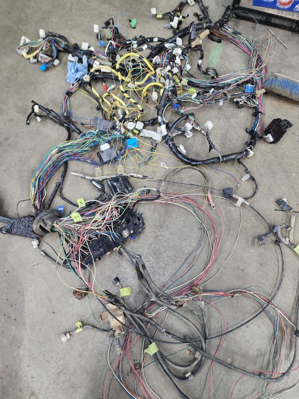

    Half way through tubbing mine I started to have second thoughts. That wiring pic gives me the same feeling. :rofl:

  6. Mar 7, 2023 at 10:30 AM

    cool pic right there....

    I mean, on the plus side, it is WAY easier to tub now! On the downside, the tubbing is already done anyway... Maybe I should just take it further back just cuz I can haha.
    Windigo and erok81[QUOTED] like this.

    Exactly. If I want to tub mine anymore I need to take the dash off. You have super easy access now. I don’t envy the project but I do the completely open cab. :rofl:
