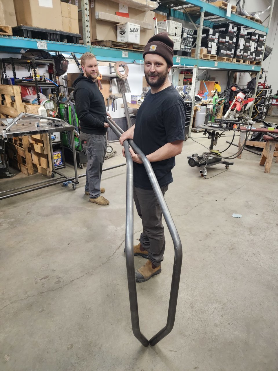

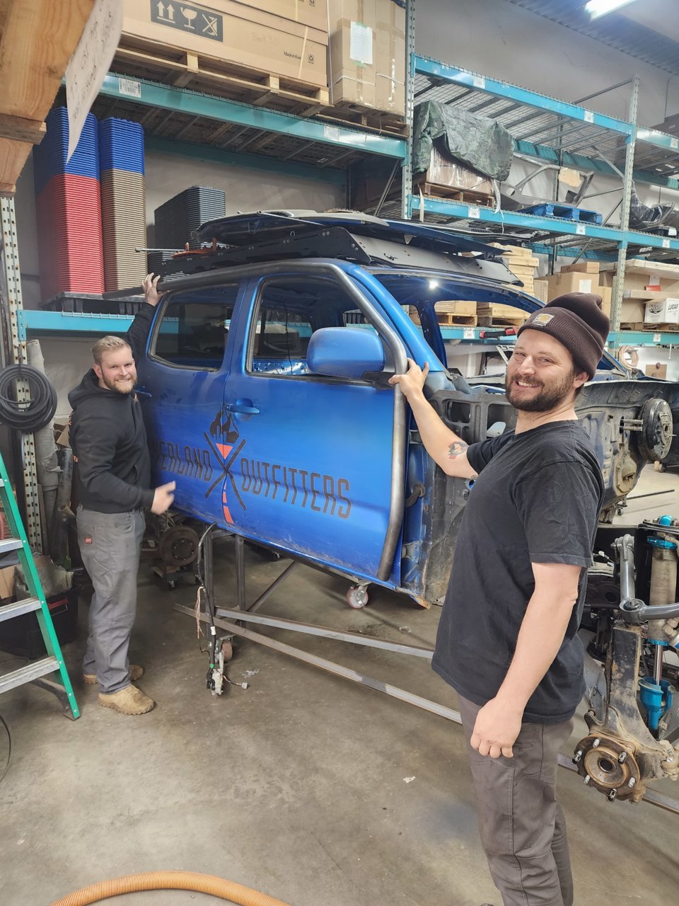

    Hurt my back and couldnt do much on the truck for a few weeks, but my friend who has built many cages was up here for a week and on his last day we decided to tackle the main hoops/a-pillars of the internal cage. Got them both done in around 5 hours or so. The rest should go together a lot easier. Had another friend come over to help as well. Super rad.
    Just need to cut the holes in the back of the truck, and in the floor to get them in before I start tying them all together
    Also got the new plasma table setup this week which I am extra stoked about! Gunna be a big shop upgrade I think.

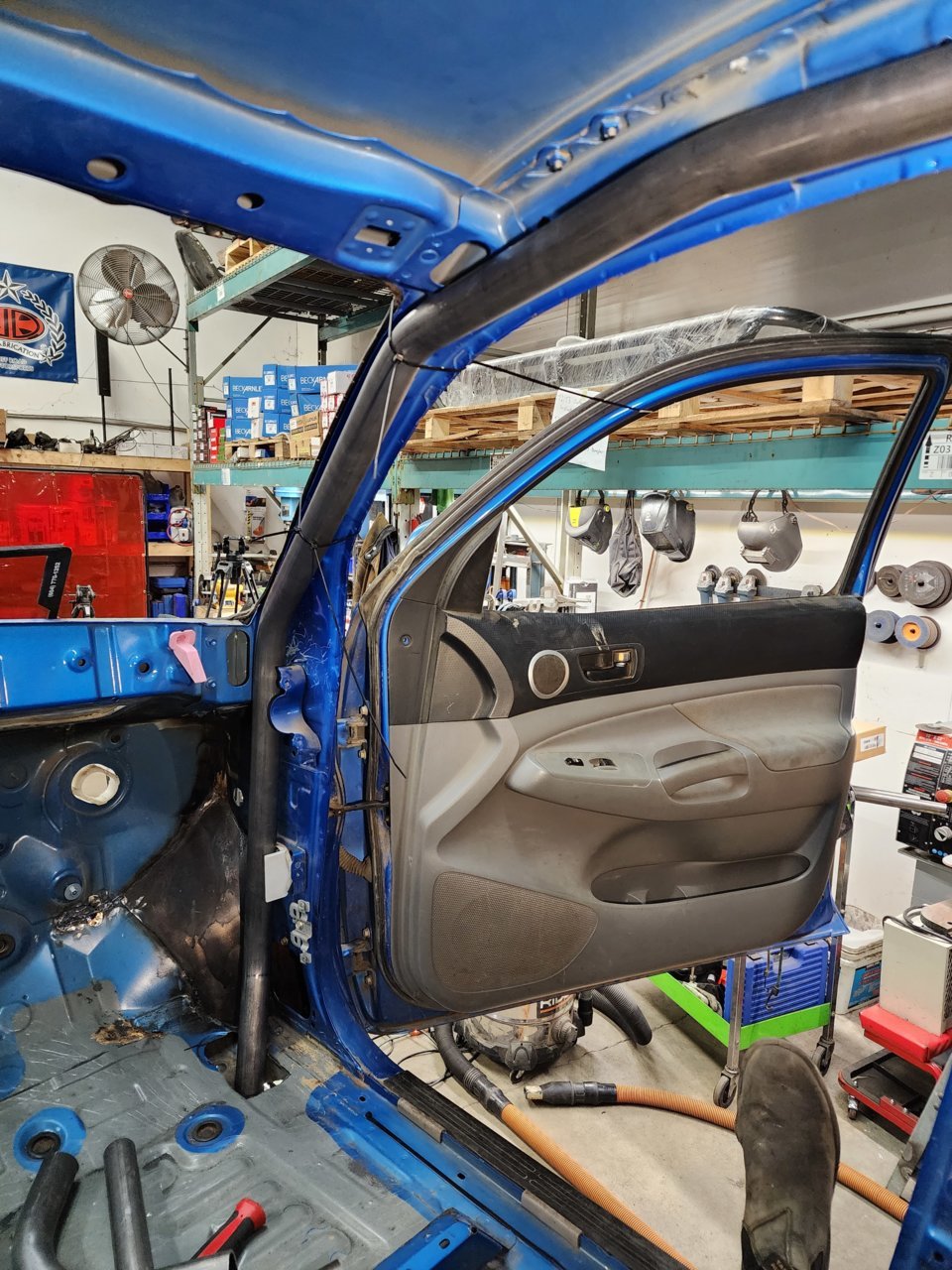

    Got both a-pillars in. Also cut the holes for the front engine tubes. Gunna do some sound deadening before adding the back and roof tubes.
    Really want to do anti-intrusion bars in the windshield, but the cops around here can be pretty crazy, so I want to try and keep the truck as discreet as possible... As much as a linked long travel, ls swapped, wide body Tacoma could be anyway

    Neat. I just got my internal cage from 4x but now i'm on the fence abut getting it put in because that means my entire interior needs to come out AGAIN. Might just wait until the truck is running and driving.

    I don't think you have to pull the interior for the 4x innovations cage, it just kind of sits around the interior. I'm curious what the head room is like for that cage.
