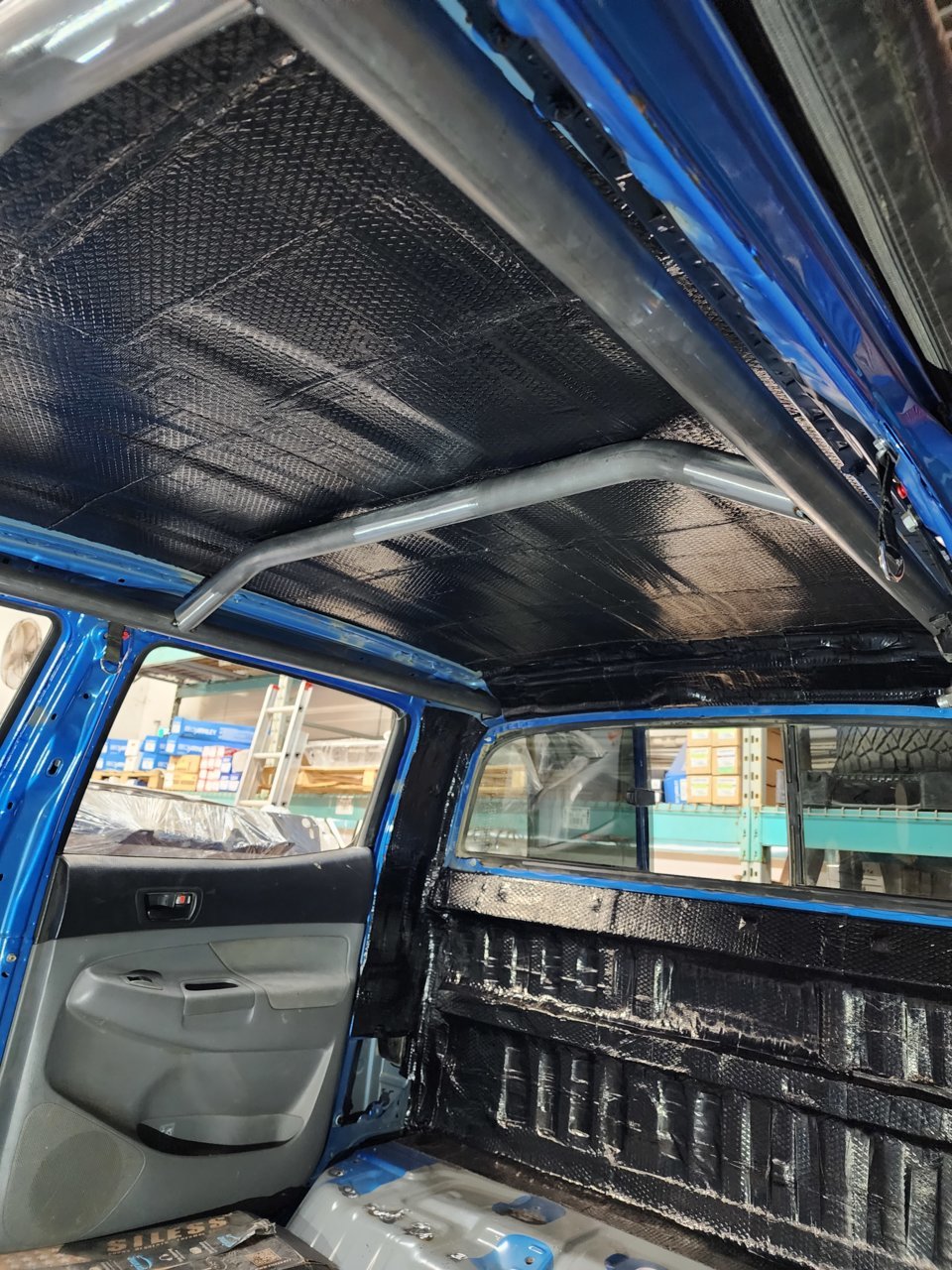

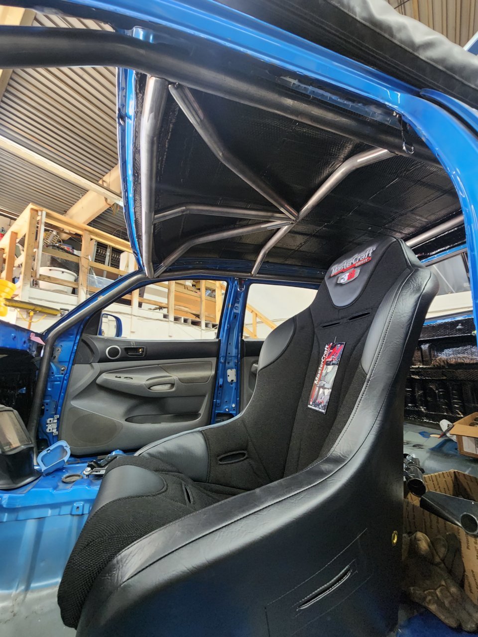

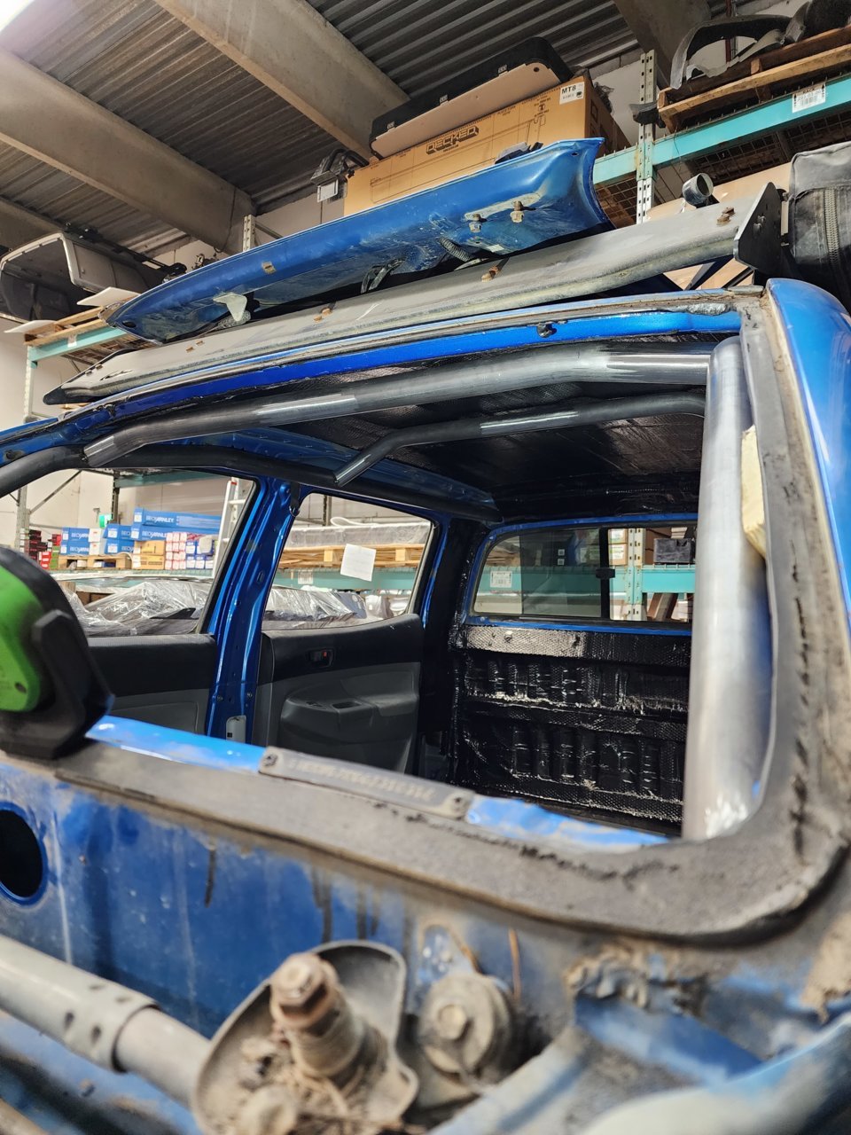

    Slowly poppin in tubes, try to do a couple a week after work. Gunna have to start on the motor mounts soon though once the roof tubes are done before I can do the c pillars and back wall.
    The 911 Motorsports tube jig is a game changer. I am completely inexperienced at bending tube, and I haven't wasted anything yet. Pretty awesome.
    Threw together a quick little reel on IG of the process.

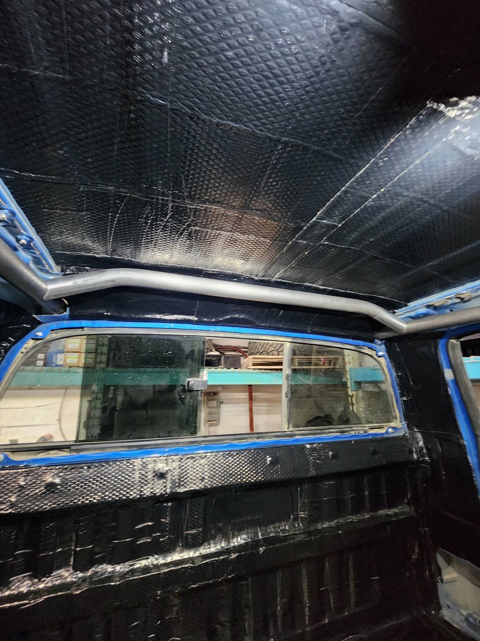

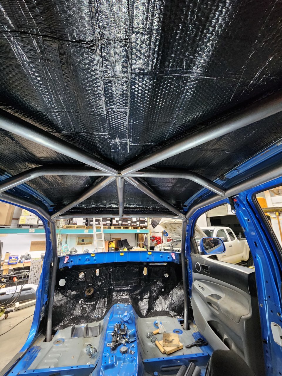

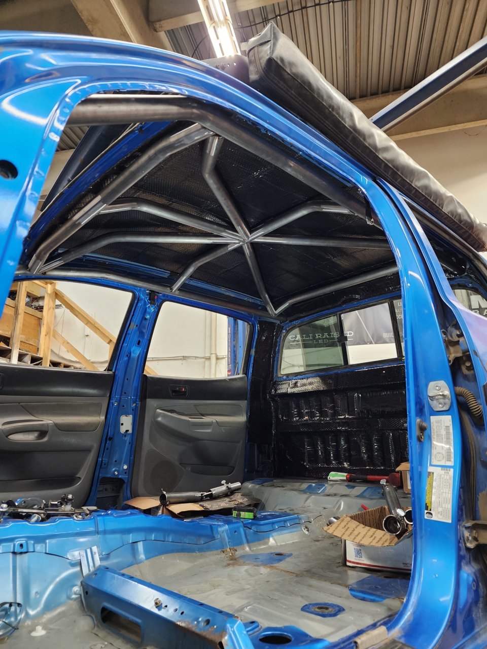

    Got the roof all tacked up

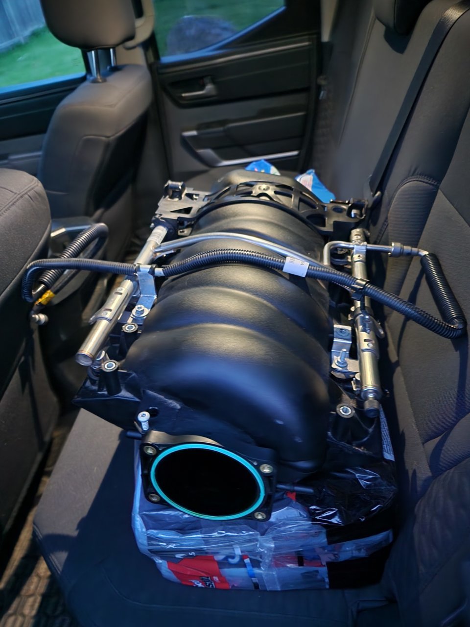

    Also managed to find an ls3 intake with fuel rail and injectors for an insane price. Super stoked on that!!! Basically brand new.

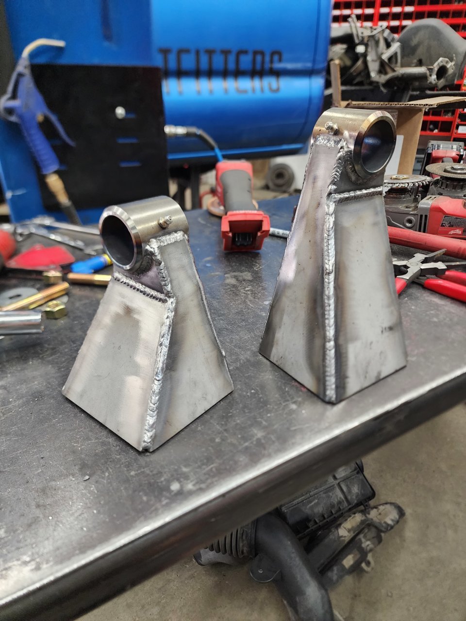

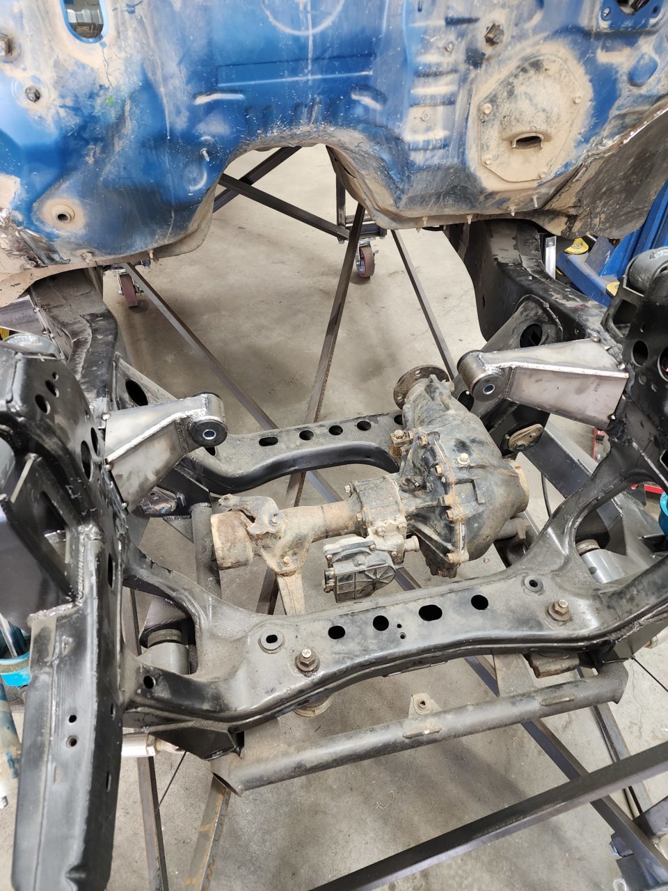

    I've been using fusions cam side for making gcode for the table and it works well enough for me, but I have nothing to compare it to.

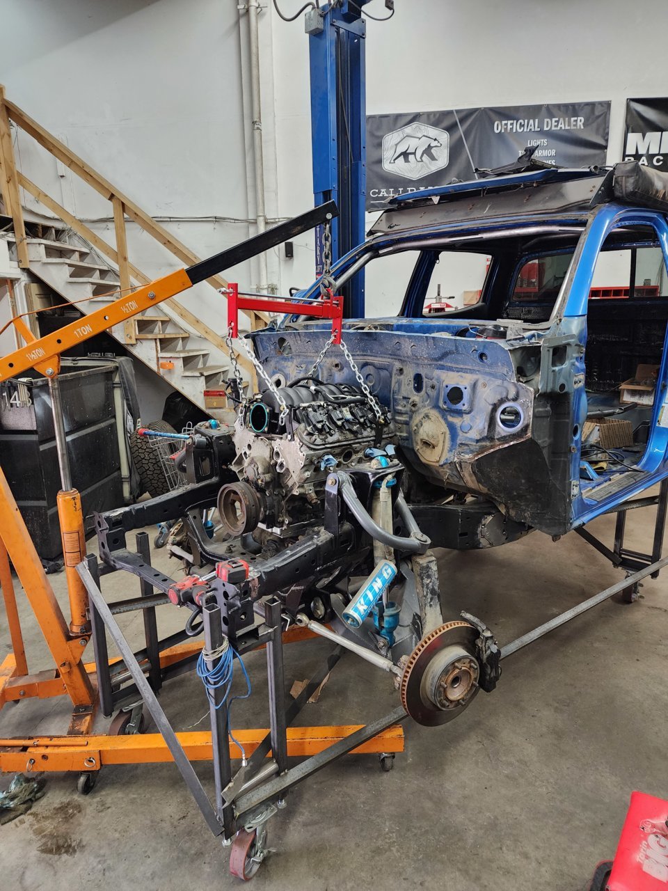

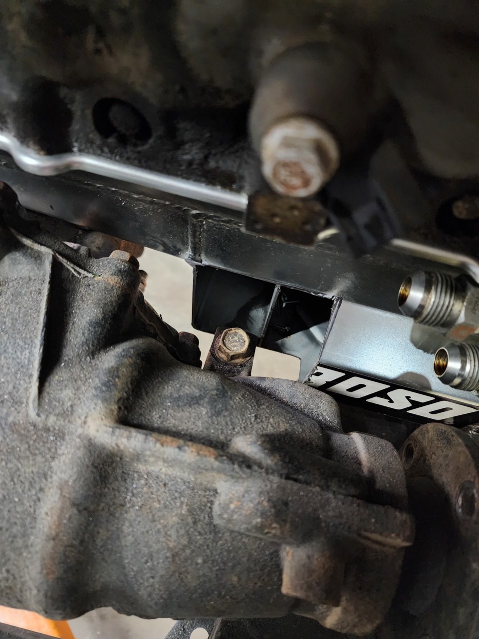

    Got the engine located this weekend, and designed, cut and welded some motor mounts today. I feel like fusion takes me way longer than it should, but I'm getting better with it.
    Welds could use a bit more consistency too.
    Had to notch the pan in a couple spots as well, so will need to get that welded up as well!
    20230514_163057.jpg 20230514_175353.jpg 20230513_170223.jpg 20230513_170145.jpg
    Now I can get the engine back on the stand and tear it down properly
