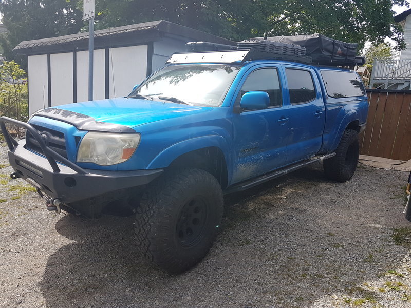

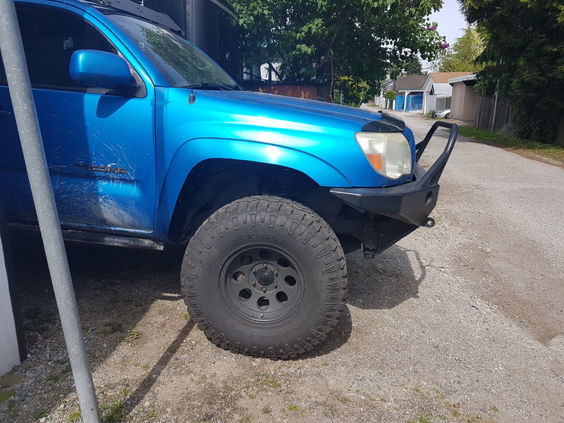

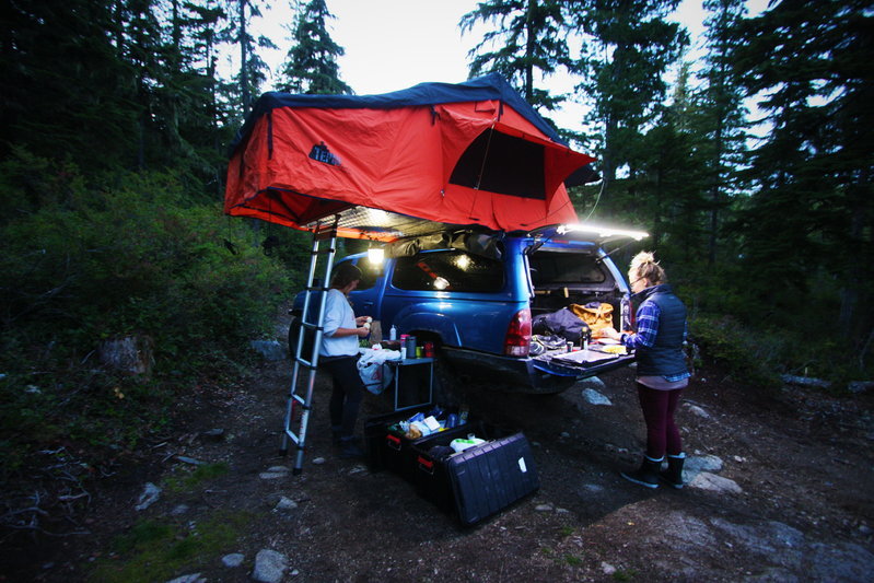

    soooo this happened.... :anonymous:
    now it's time to :sawzall:

    o no, what happened. all i see is a dent in your door, which obviously makes a good story i hope. i see you got the rear awning in place, nice. your trip down here was too short. i got a few more sick spots to show ya.

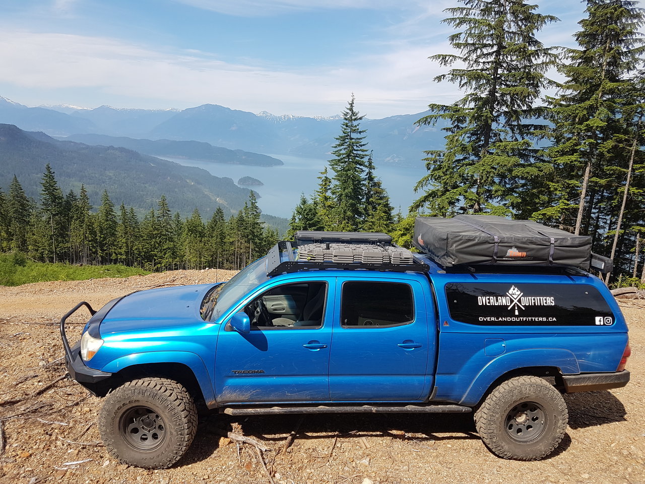

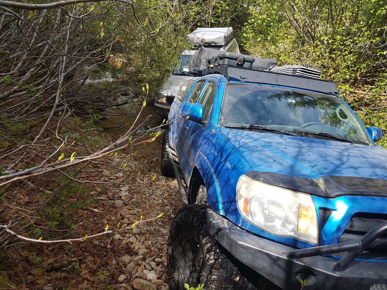

    to bad to see they're clearcutting steep slopes out your way in that second photo, other than that atrocity, nice setup. Good to see someone using the truck to its fullest potential in the way Toyota pickups were originally intended to be used.

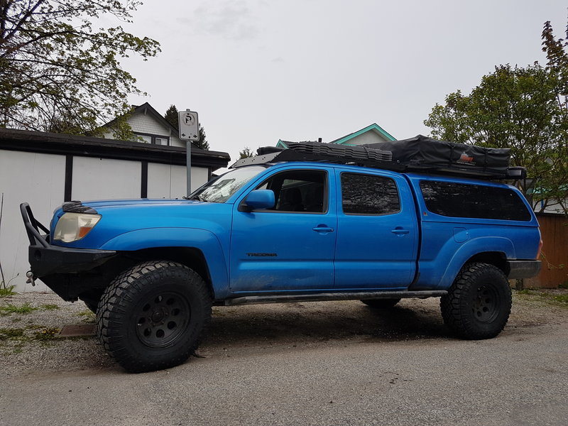

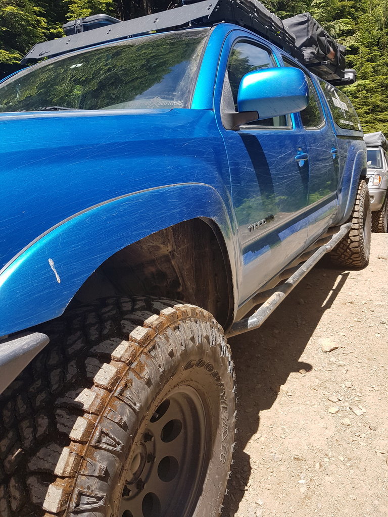

    finally cut the fronts to clear the 35s... I'll get around to the back eventually. I chopped off 2 1/4" to start and see where that gets me. I also painted inside the wheel wells black so it looks a little nicer.

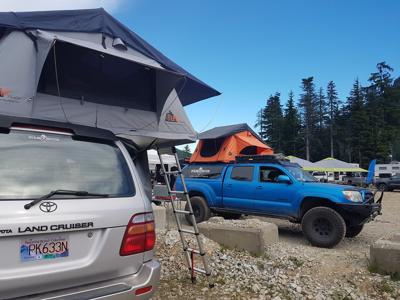

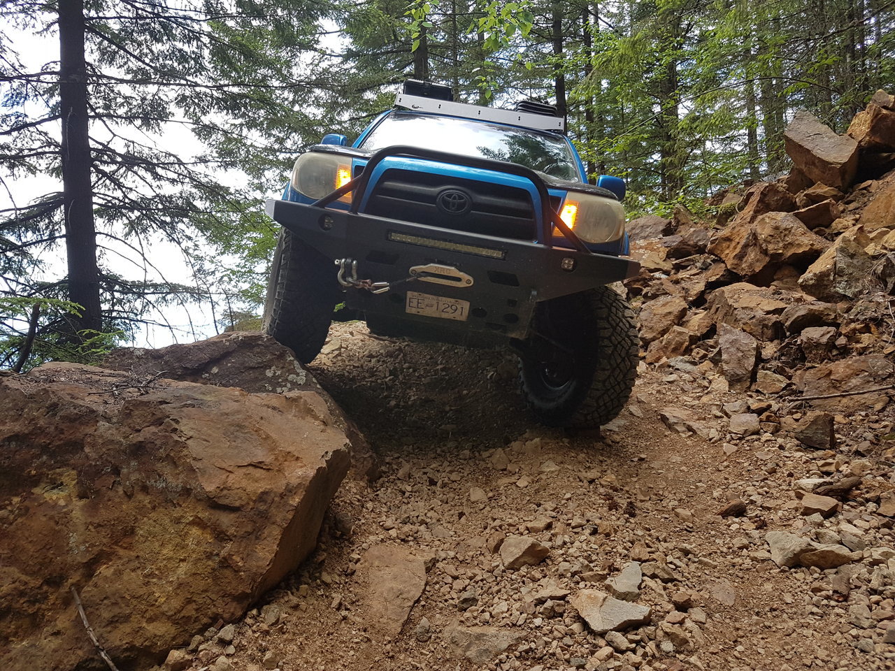

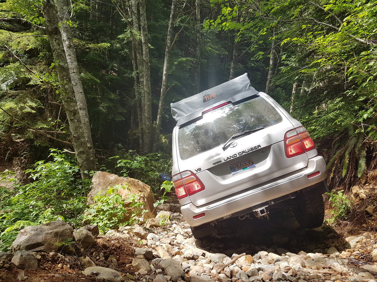

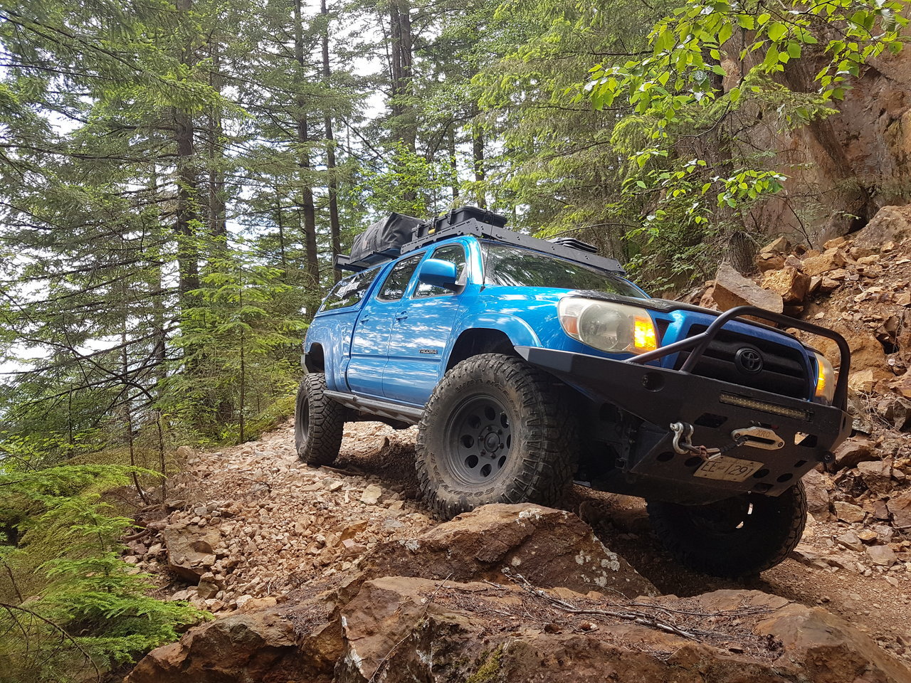

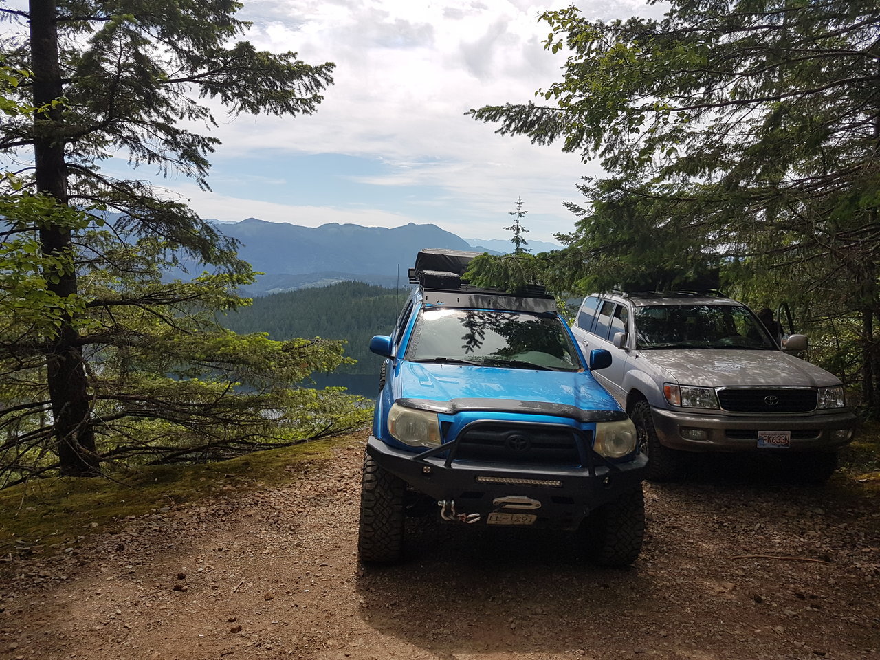

    Here are a couple from this past weekend with my friend in his LC100
    Nobody can say I baby her!

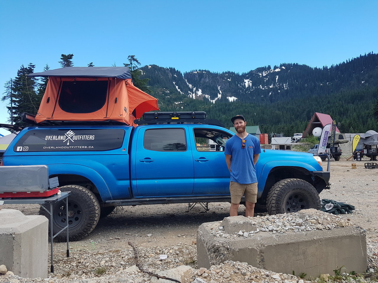

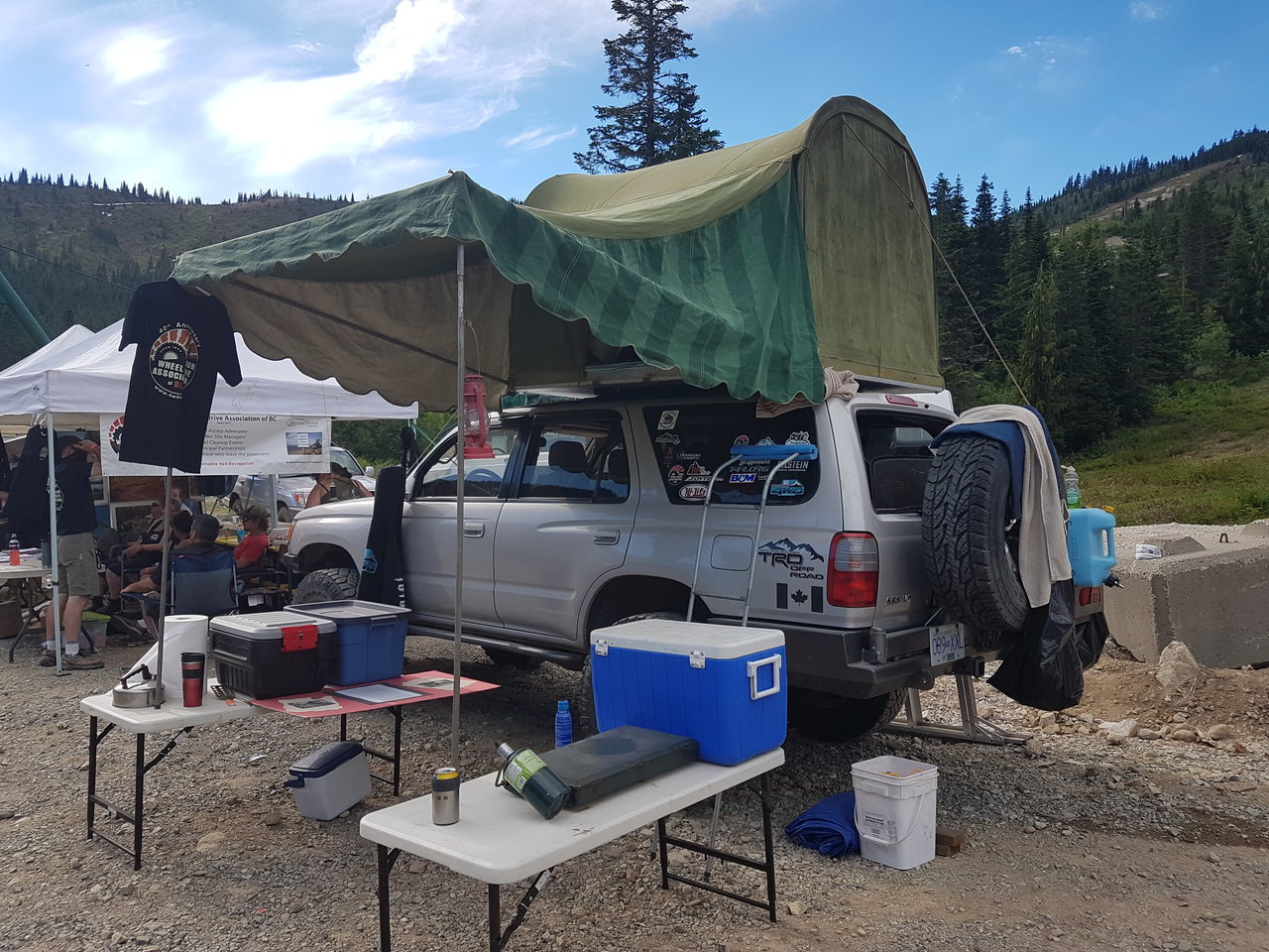

    Our setup/booth at the BC Overland Rally!
    And this old relic! OG!!! I think it's from the 50s or something. forgot to take a picture of the little description bit.

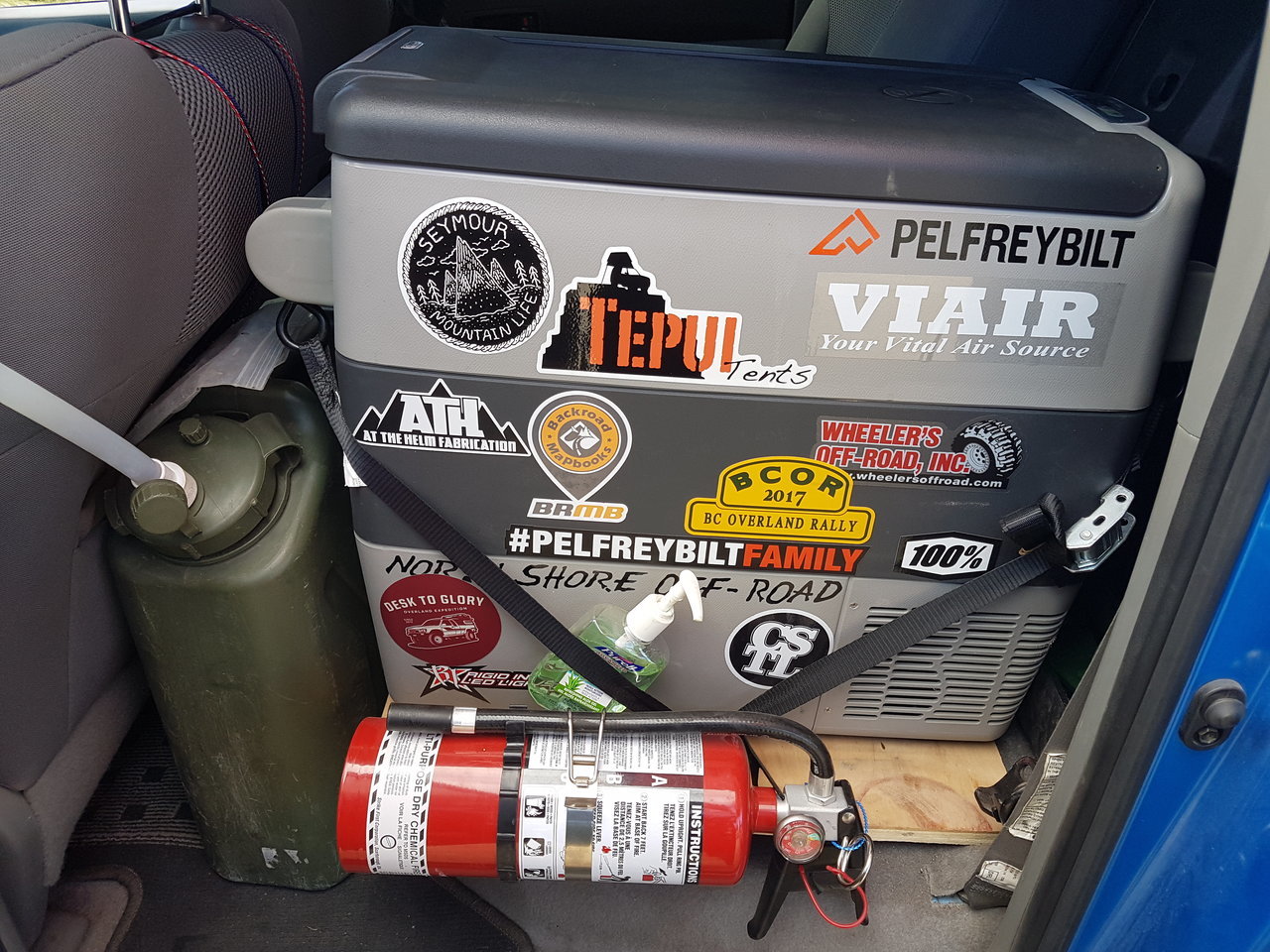

    Thanks man! I guess I haven't posted a picture of my fridge set up, but I took out the seat behind the driver for a fridge platform. I have considered building out the other side as well, but use that seat for another passenger somewhat frequently (and a 4th in a pinch)

    It's some work, but not terrible. My rear's clear without cutting, though I'm going to cut to match when I get the time. Fronts was a pretty hefty CMC, plus about 2 1/4" out of the front fenders. The only other thing is you end up ripping out your fender liners, so rerouting your air intake is essential. I put it into the cowl by where the cab air intake is. I'll get some pictures later on, but there's a thread on here about it somewhere that I'll try to dig up.
    I also had to replace my LCA's just to be able to adjust my alignment and get the wheels moved forward. My original bushings were completely siezed and I just cut them off. But if yours aren't seized you're golden
