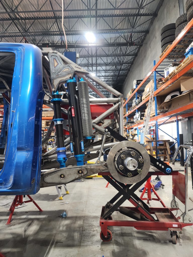

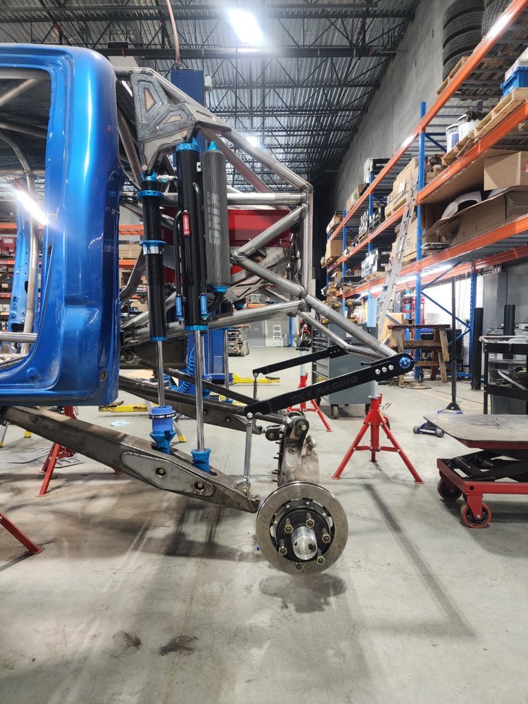

    Alright, made the mounts on the link
    I also shortened the links. Now at ride height the arm is at 10° up. 35° at full bump, and -17.5° at full droop.
    I think I'm happy with that as I don't have to move the bar location.

    Assuming the heat treatment level and the arm length are proper, I think you'll be very happy with that geometry!

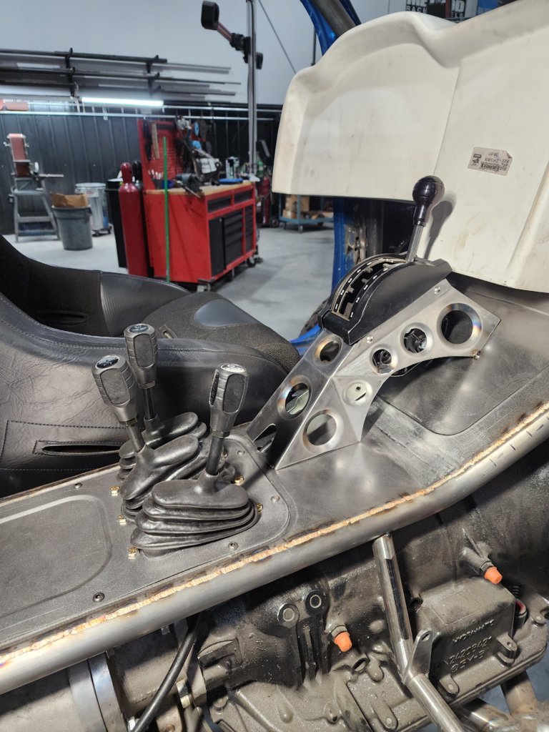

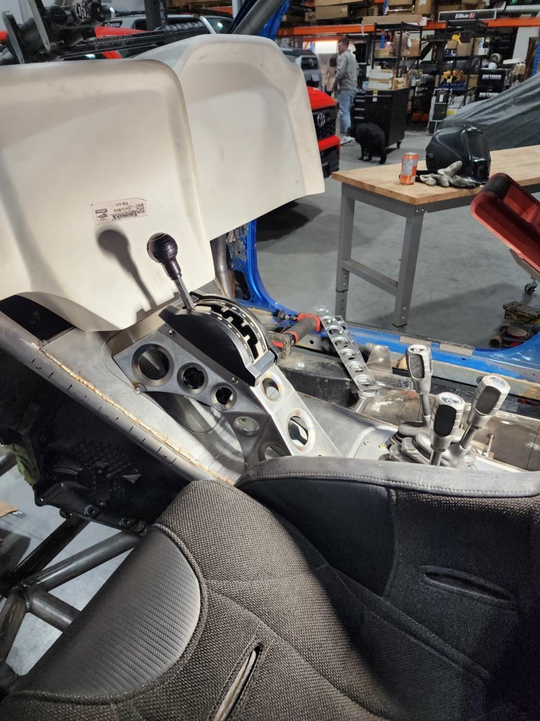

    Finally got my shifter mount design in fusion done and built it last night. Pretty stoked. Need to mount the hand brake next, then that's the console done

    yep, heavily inspired by MCD1 on James' truck. I tagged them in a photo on IG and Morgan sent me a voice message saying it was sick and I did a good job, so I'm pretty pumped on that haha.
    Now I just gotta make another mount for the hand brake
