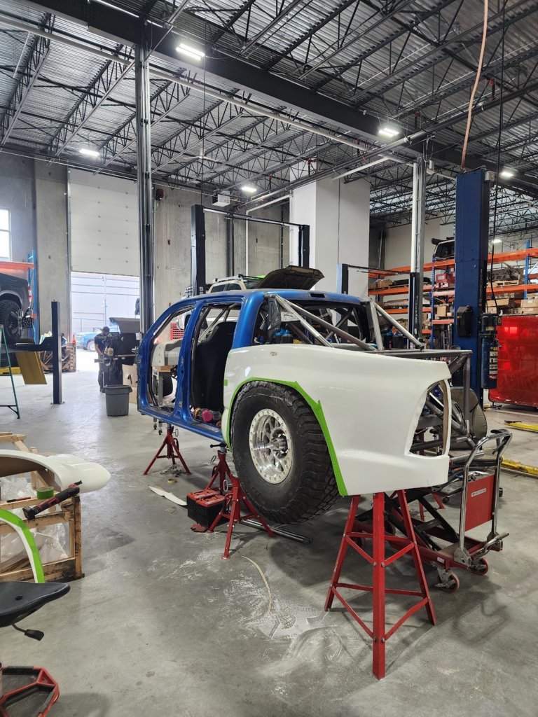

    My fiberwerx one piece front and bedsides arrived a day early and I couldn't help but get a bedside mocked up and trimmed

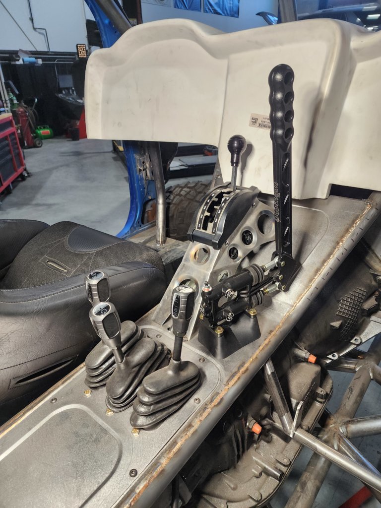

    Looking great! What kind of custom dash do you have going on there in the background? :spy:

    Its the fiberwerx flagship dash. Excited to get a bunch of Haltech and Rugged Radio stuff stuck into it! I wish so bad that fiberwerx had a +6" bulge long bed bedside, but they only have that for the short bed, so I had to go with a +4" and I just had to cut the shit out of it and kick it out pretty far in the back. But that's fine cuz the one piece front is super wide, like 86" so it should match up decently. I am running long bedsides and cutting them around the cab since my wheel base has been shortened by around 8"

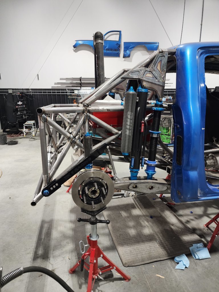

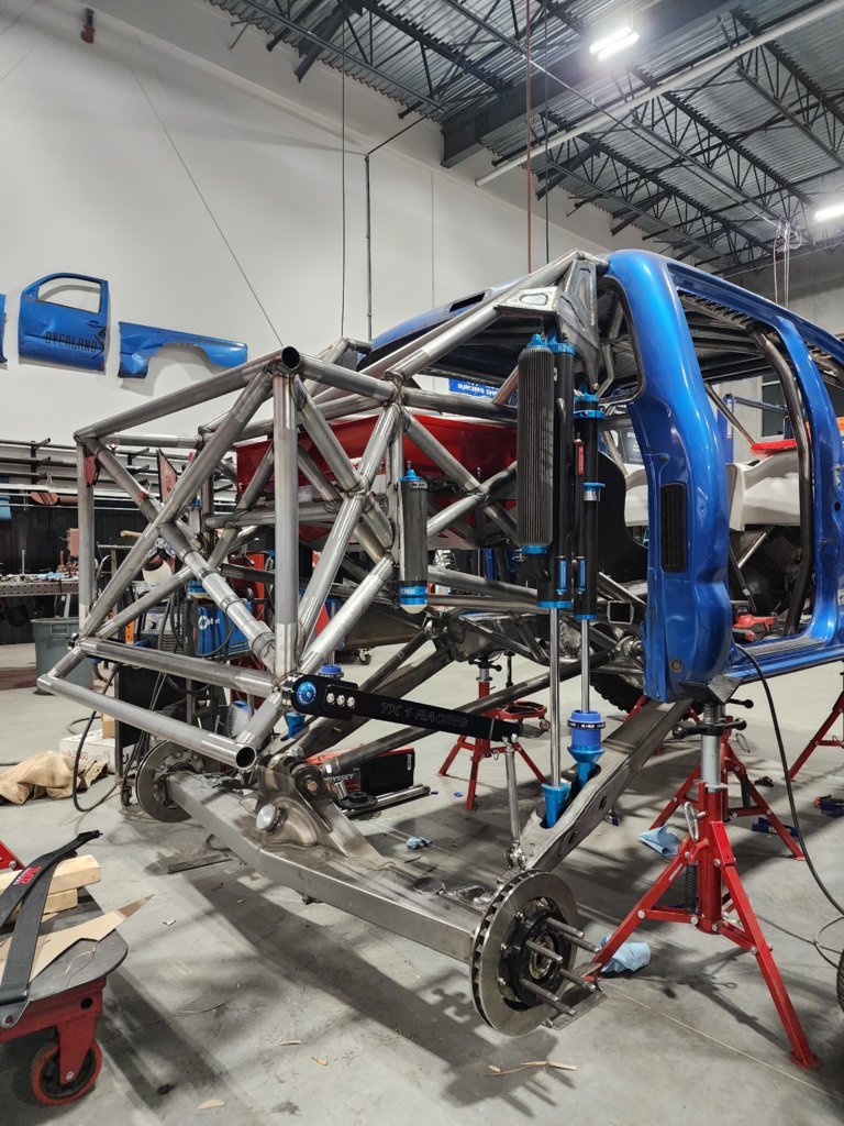

    Have you articulated the rear axle to test clearance as well? I know you're not building a crawler, but landing a jump a bit sideways or bicycling a turn can flex out the rear pretty quick. Depending on the geometry, some setups can get a bit of outward movement on the compression side when articulating. Would be a bummer to trim the glass for full (straight) compression and then blow one out because you tested out the swaybar a bit too hard.
    Speaking of swaybar, disconnect the drop side for this test, and look at your tire clearance on the sway bar arm and link on the compression side. You may have already done this, but it was the one thing I forgot to do, and sure enough, tire rubbed on the swaybar link at full flex.

    I've flexed it out, but not with the swaybar, so I'll have to do that. Its hard to test though because the link anti-wobbles bind before it can fully articulate, and I'm not sure where in the travel it will actually sit at full articulation. I doubt one side would ever be fully compressed in articulation, especially with the swaybar. More likely it pivots around ride height, so I don't think it will get fully tucked like that at max articulation. I really don't know though. the tires do hit the bypass resi if one side some how managed to be fully compressed in articulation, but I just can't see it ever happening in reality. More likely it will be dropped down a few inches, in which case it clears fine, and the swaybar arm is tucked in tighter than the shocks are.

    Yeah, anti-wobbles make it tough, especially with poly, since your kind of guessing how much farther they'll go in a dynamic situation when they squish.
    If your swaybar is inside the resi, you should be good. It was hard to tell from the diagonal photos. Would love to see a shot of one side directly from the rear if think about when you're in the shop. I like how you flared out the rear of the chassis to hit your swaybar width and get everything in-line

    I looked at it again earlier after reading your message. The sway bar is just inside the Resi, but because it's linked to trailing arm and mounted pretty low it stays below the top of the tire no matter what so it won't be a problem in my estimation. I know your sway bar is mounted pretty high up more in line with the top of the tire.
    I'll try to grab a rear on photo tomorrow!
