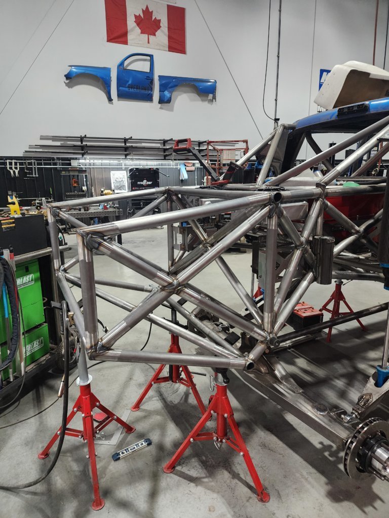

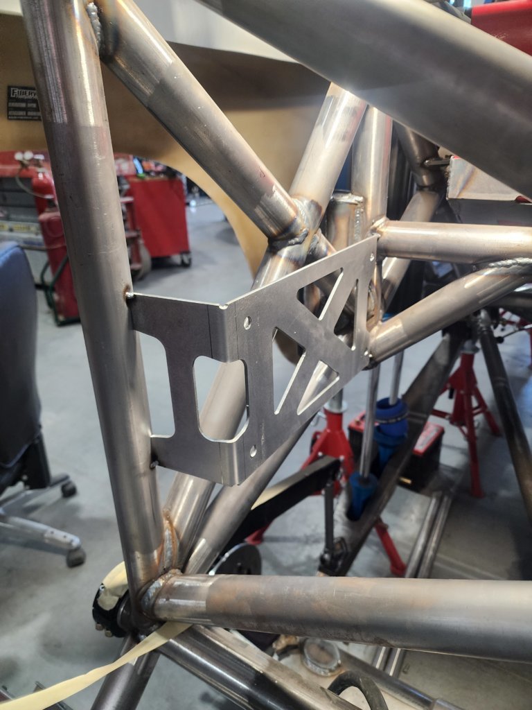

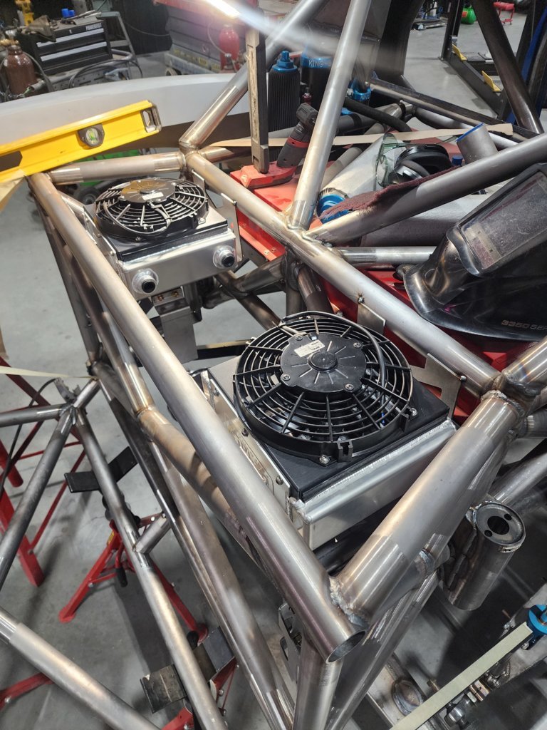

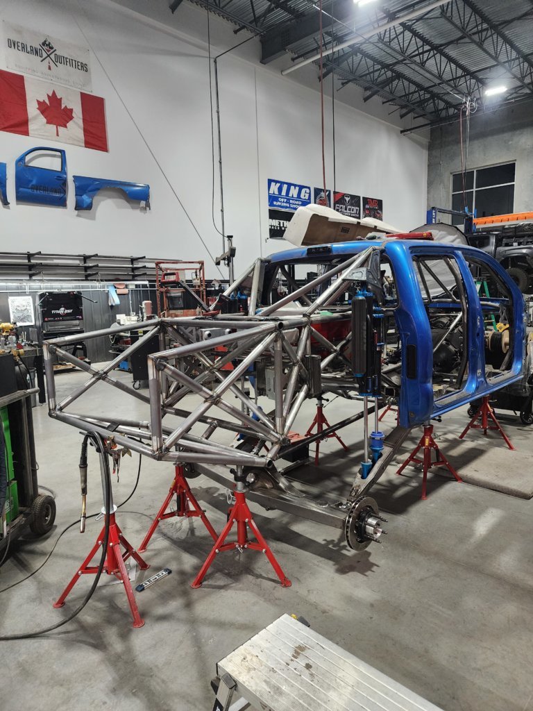

    Battery boxes and trans coolers!
    Need to figure out how to make a tailgate and hatch that seal up properly once I finish the side tubes for the storage compartment at the back.

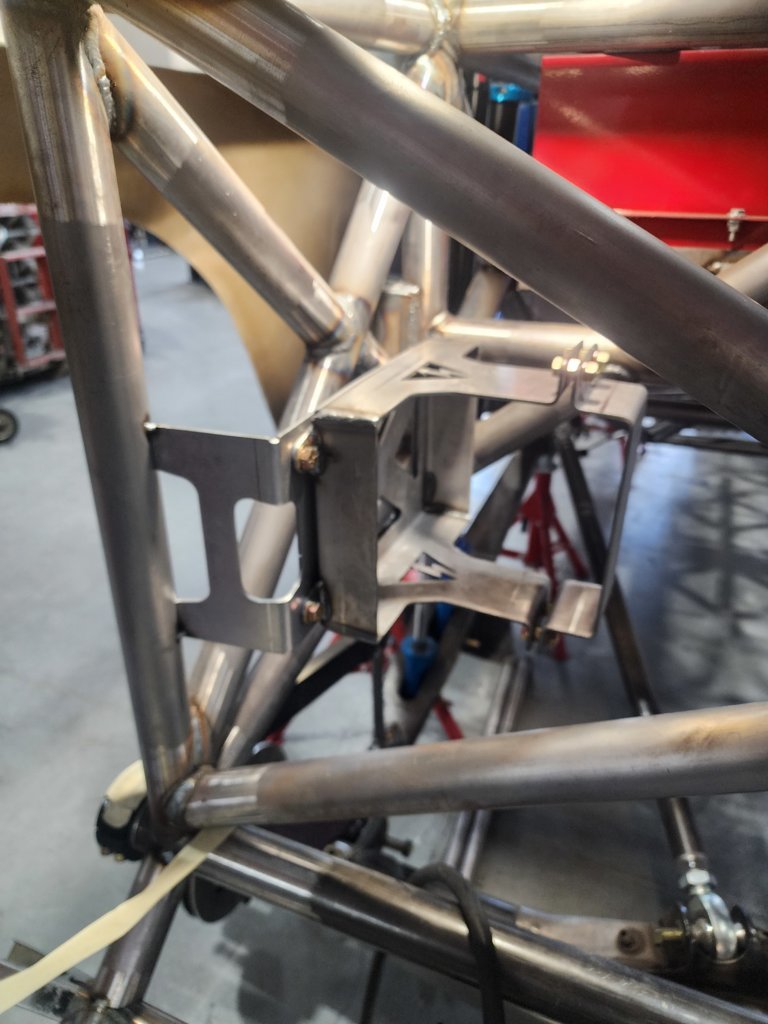

    that last photo.....could just be the shadows, but are you using half inch plate for that trailing arm tab? :eek:

    It's plated 1/8", sandwiching a big 3/8" puck inside, and then wrapped with 1/8". They were made by JD fab and came with the housing, I just welded them on.

    This is the best pic I could dig up

    Love it. Similar qualities to solid plate, but takes a whole lot less heat to stick it to the axle.

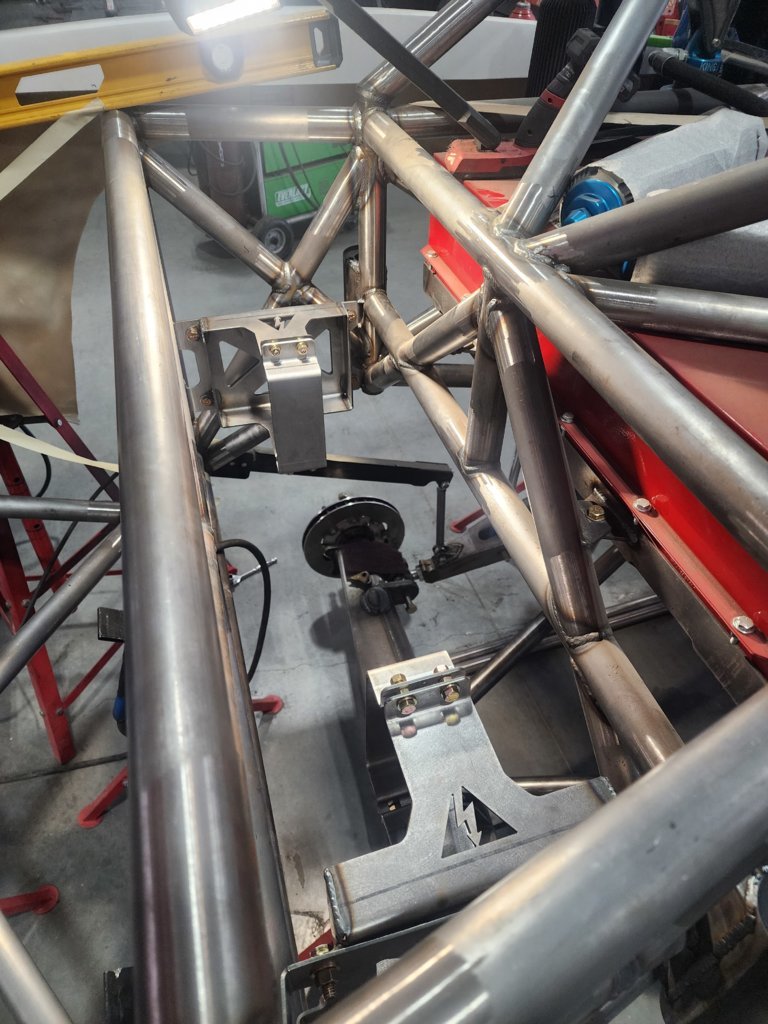

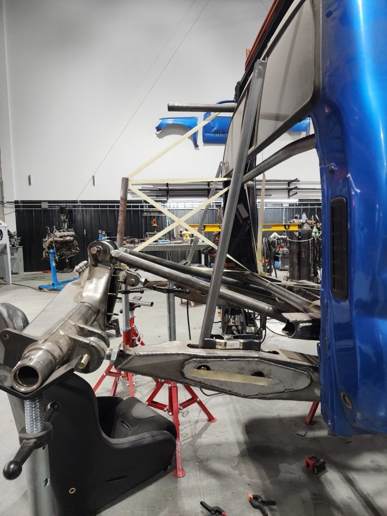

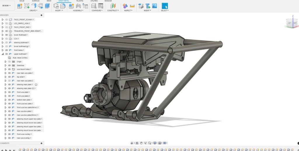

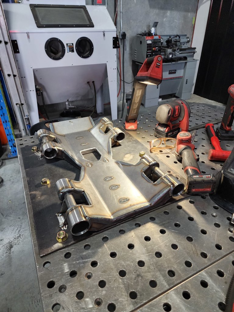

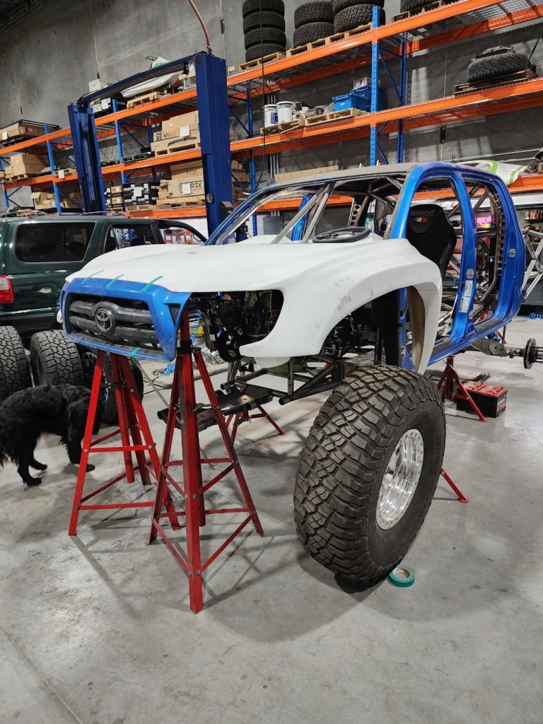

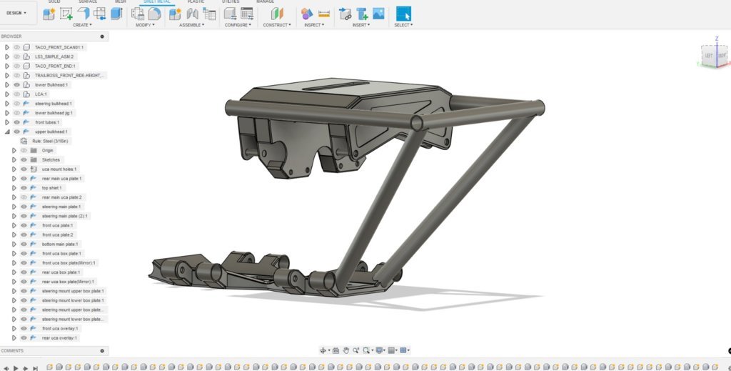

    Got the lower pivot mounts built and tacked to the truck a bit ago, been working on the UCA and steering mount design for the bulkhead. I'll build that next, then start designing the j-arms, lca's and knuckles. So much time spent in Cad.
