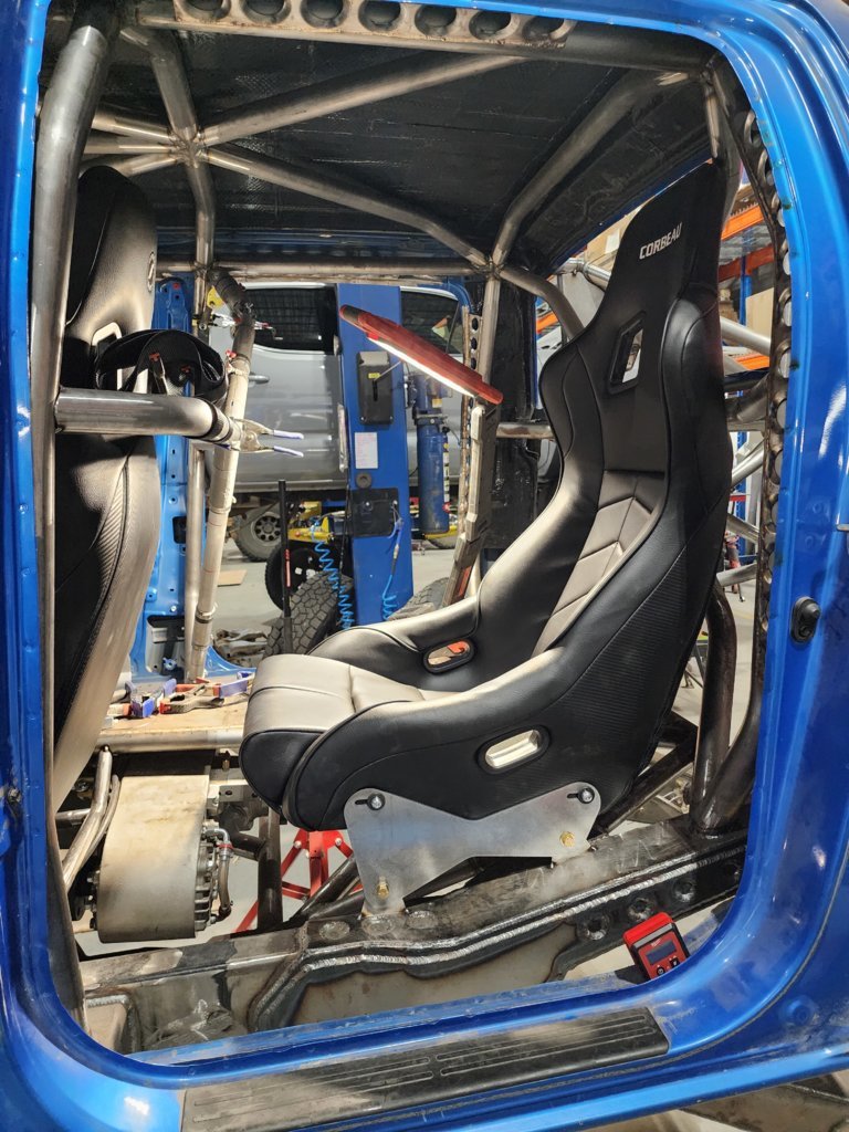

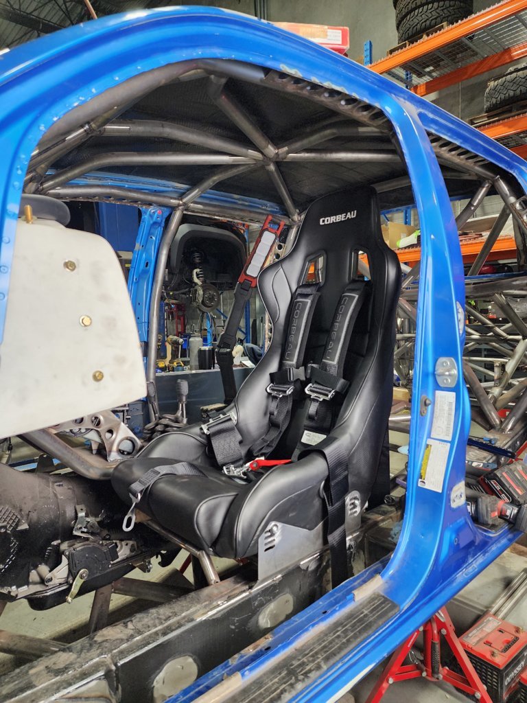

    Seats are hereeeee!!!
    Corbeau DFX. Finally found a seat that's tall enough for my lanky torso. I find them quite comfortable considering how much containment they have. Won't know for sure how they are on long drives until it's running though. Super stoked on them though! Their harnesses are really nice too. I threw them on just for fun. The dfx also have side or bottom mount which is gunna be helpful for me considering how tight the space is. I made the outside mount today, but I don't know if I'll actually keep that one because I don't think I can make the inside mount have that much adjustability anyway.

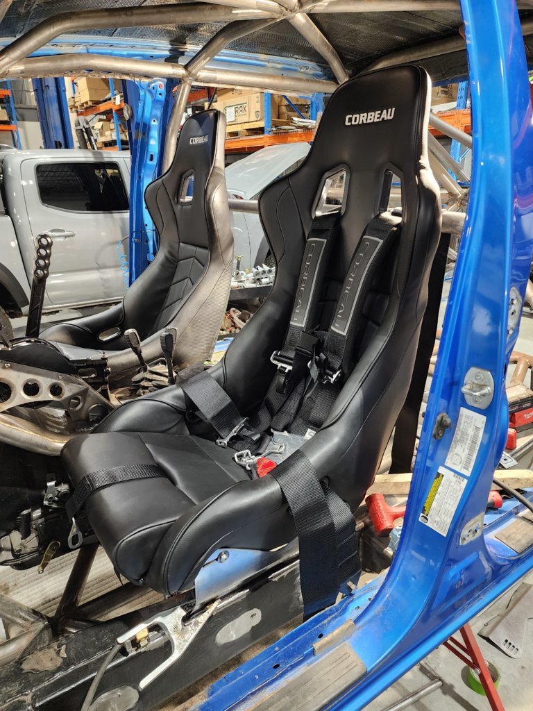

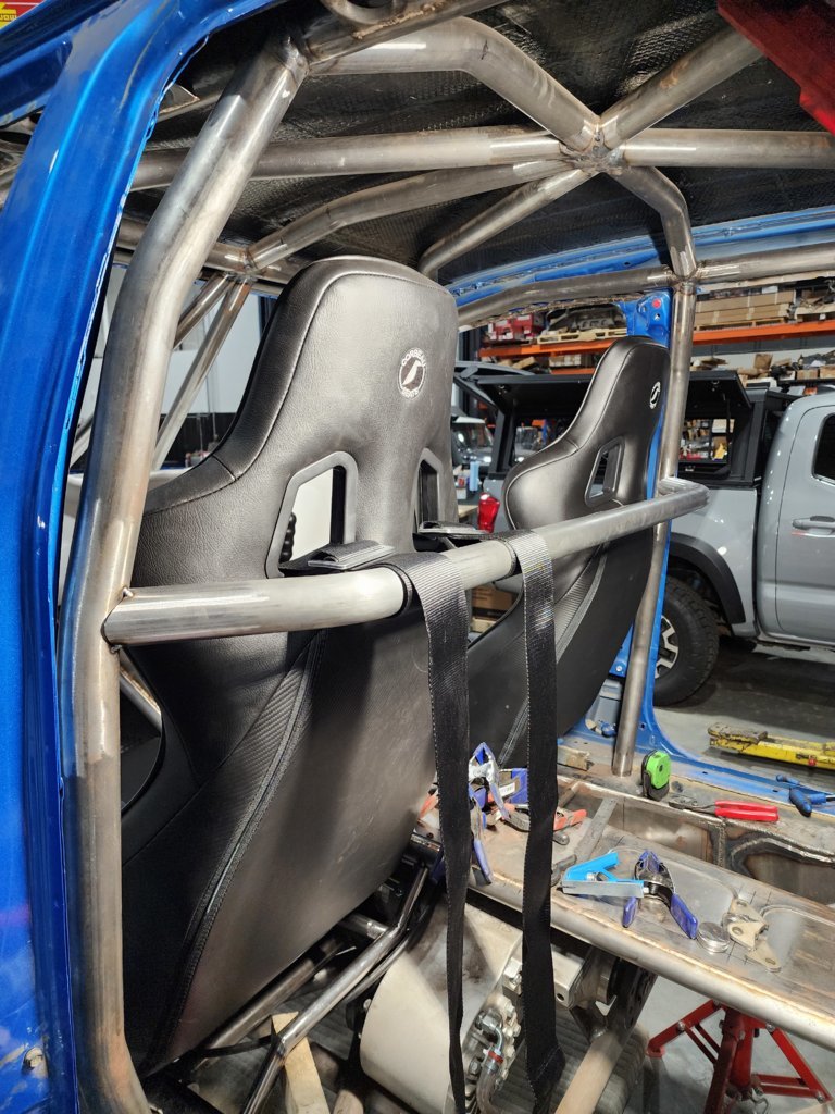

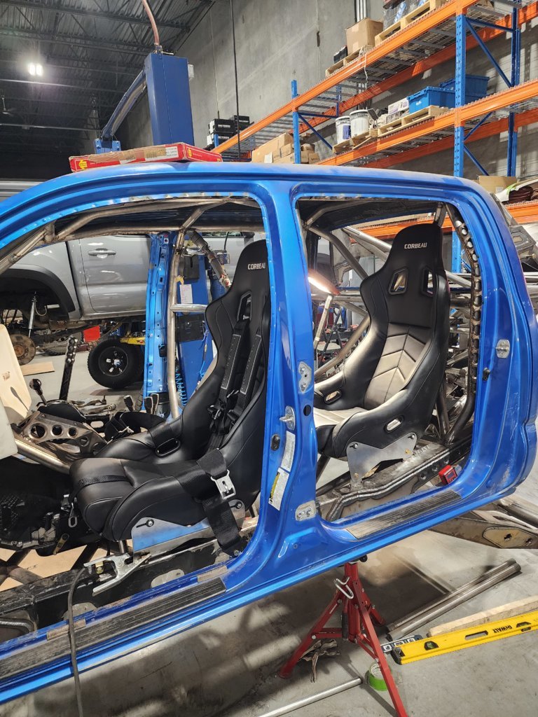

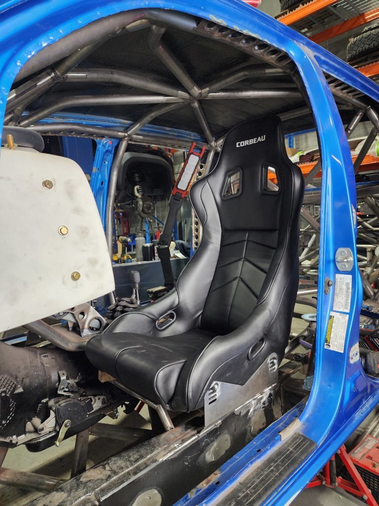

    All the seat mounts are done and 90% of the front harness mounts are done. Redid the front mounts too. Once all the harness mounts are done, I have 6 interior tubes to do and a couple gussets, then the floor and back wall are ready for sheet metal!
    Rear seats are tight, but I'm taller than anybody who will be back there, and honestly I could ride in the back and not be too uncomfortable for less than an hour. Anybody shorter will be fine!
    I also made the rear seat side mounts removable so if I take a seat or two out of the rear, to make room for extra storage or something, I don't have those big plates there.
    Really stoked to be making some forward progress. The Corbeau DFX are sick. The fact that they are side or bottom mount has made it so much easier for me since it it super tight in the front with the trans tunnel and drive shaft. I actually am bottom mounting the inside and side mounting the outside.
