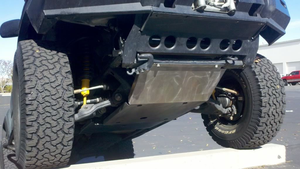

    Eric? He makes 1/4 and 3/16 IFS.
    3/16 mid and 3/16 t-case

    FWIW, I've beaten my 3/16 IFS skid pretty damn hard. I've caved it in a few times but I just take it off and pound it back with a sledge. I think it's enough for what I do, which is occasionally pretty big rocks. If you're thrashing your truck every weekend 1/4 is better and you won't deform it IMO. It's also really damn heavy and I'd still rather have 3/16. At some point I'm going to take it off and weld some angle iron in strategic places to brace it and it'll be a lot lighter than 1/4 but still almost as strong.

    This is his IFS skid and this is how far it covers in the rear w/o mid skid or t-case skid.
