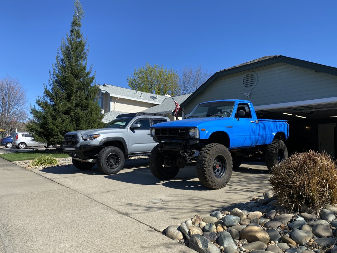

    707D7FF5-EECA-4E4E-8FF4-0DDCED9EC1D7.jpg B08AE35E-4C89-423A-B22B-53E825D14464.jpg Updated pics with 37’s, making my taco look weak af on 33’s. You’re welcome joseph!

    The tires are BFG blue label Krawlers in 37x12.5R17 flavor.
    Short day yesterday at @jimmyg08 house. The majority of the welding was done, so it was time to bring it home to continue the build.

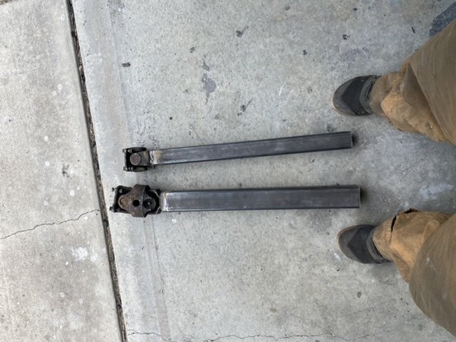

    welded the square driveshaft up. Also installed new body mounts and sprayed the interior floors with bed liner.

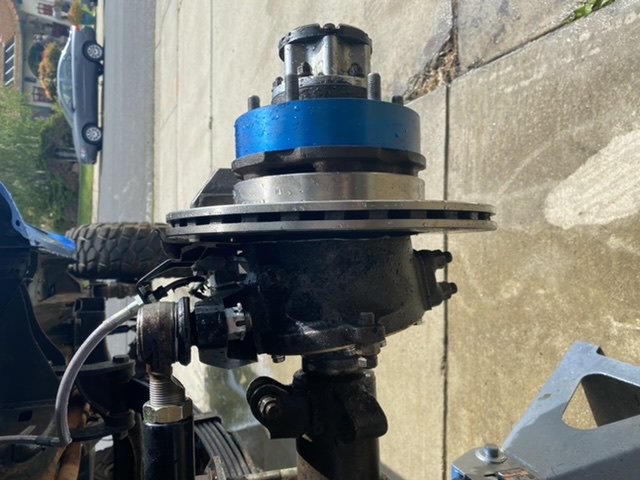

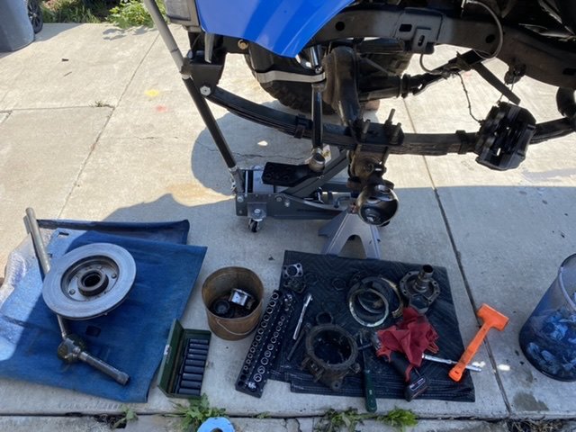

    tomorrow I work on the front axle and rebuild it

    I forgot how much of a job these front axles were. No during pictures because I was drowning in grease

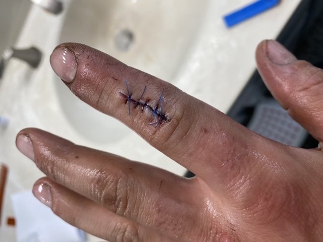

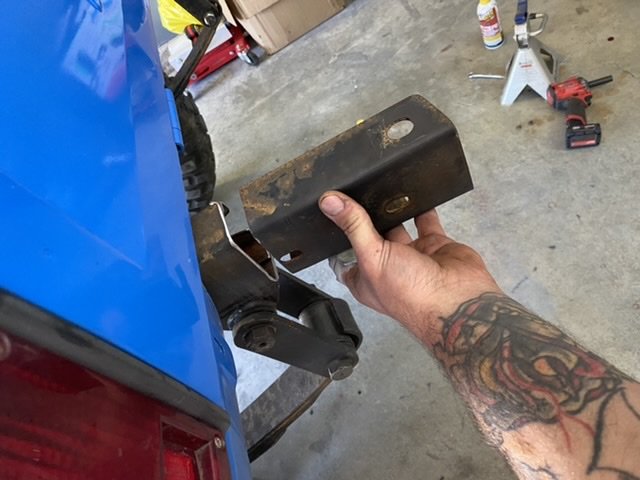

    Had an accident last night while grinding, split my finger down to the bone.
    A quick 5 stitches and a few modelo’s and I’m back at it.

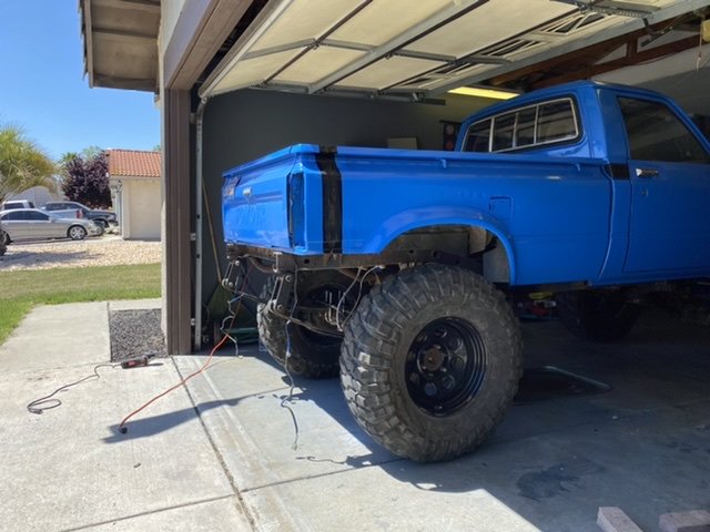

    pulled two leaves from the rear, truck is too tall for my liking. Waiting to slap a winch on the front before I pull any leaves from there.

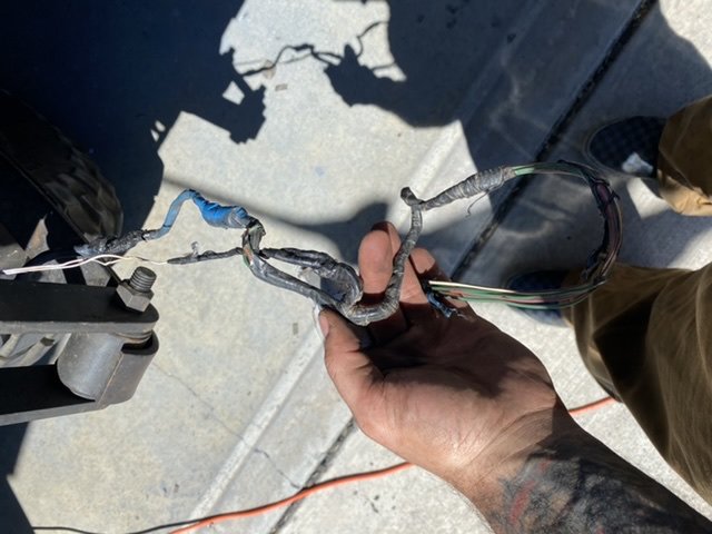

    while driving it the other day, all the lights in the rear stopped working. Turns out one of the wires grounded out and they all melted together. One more thing to fix, no biggie.
    also cut down the rear frame and bed some more for the bumper I’ll be making.
    Tomorrow I’ll be gettin some exhaust stuff done to it.

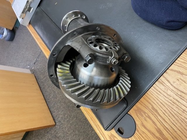

    Got a killer deal on a brand new 3rd with 5.29’s and a grizzly installed, so I picked that up. Stock 3rd from the rear will be rebuilt to an open 5.29.
    I have a lead on an IFS width rear axle and may pick that up on Thursday to throw the 3rd into and shove under the truck.

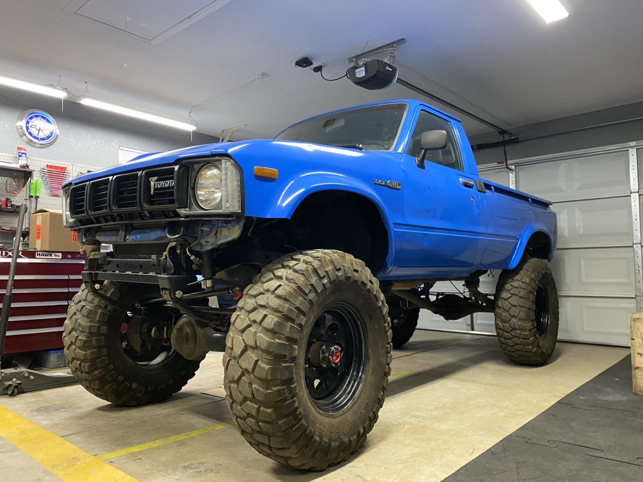

    Also, the truck is just way too tall for my liking. Suspension is going to be reworked. I prefer low lift with big tires for stability, so I have some old school 2” OME springs coming to replace the TG’s.
    subsequent fender hacking to come, can’t wait.
