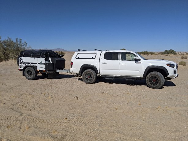

    1st Upgrade: I tried 500 lb. Sumo Springs with the stock suspension. They would barely touch the frame rail without the trailer and provided a slightly firmer ride. They also stabilized the rear in turns, making the Tacoma lean less, especially with heavier loads in the bed. Add the camping load and I would sit about level. But add the trailer, I would get rear squat…which I hate!

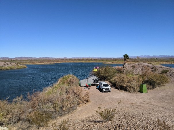

    It's hard to see the squat in this pic due to the uneven terrain...but trust me, it's there!

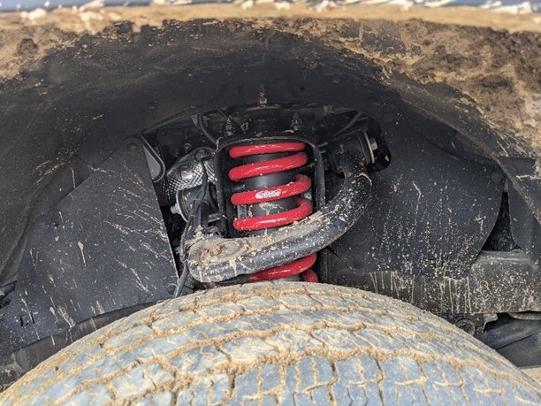

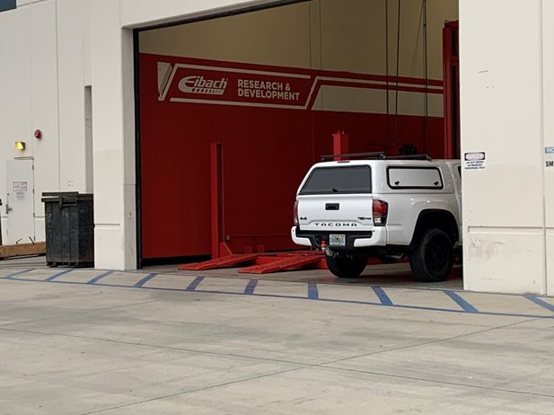

    2nd Upgrade: Eibach has been developing a front spring upgrade for 3rd Gen TRD Pros over the past year or so (thanks @mark@eibach). COVID had a say, so they have been delayed. In October, I took my Tacoma into Eibach for a measurement and shock testing session. Then, in early February, I took my Tacoma in to get front springs and rear blocks installed.
    The front was raised 1.5” and the rear 1”. The ride was nice. Slightly firmer than stock (not in a bad way) but still compliant and controlled. One of the things I hate most about my TRD Pro is the weird harmonic bouncing that happens on interstates, particularly on concrete with the gaps cut between slabs. Heavy loads exacerbate it, and the trailer doesn’t help either. The new front springs helped a bit, but the rear was still soft and induced it slightly. Again, as soon as I added the trailer, I would get rear squat…which I hate! The block added lift, but not load carrying capacity.
