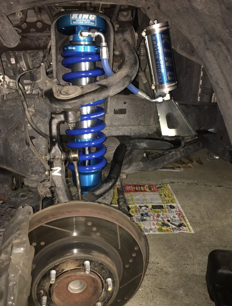

    I recently installed the King OEM suspension on my '16 TRD off road and the front only lifted about 1.5 inches, vs the around 2.5 that it should have gone up. The coilovers were adjusted from King at the factory and not changed in my end.
    I installed them with the ecgs bearing and total chaos ucas with deaver leafs and king shocks in the back. The back of the truck was lifted the expected amount, about 2.75 inches, any ideas on why the front is so much less than it should be?
    The truck is very close to stock weight, attached is a picture of the front driver coil. The ride is still phenomenal, the back is stiffer than the front, but that is expected with leafs. I don't feel the front is overly soft, my original thought was that the coils just need more preload but that would make them stiffer.

    Obviously they weren't. And considering the amount of thread showing above the upper perch, you have the majority of the adjustment available. So pull 'em and set 'em where you want.

    You shouldn't have to remove the entire coilover to make the adjustment. You need to loosen the set screw you can see in the photo you provided. Then you need to use the coil nut adjuster tool that are specific for these. Make sure you count the number of turns and do the same to the other side. Also make sure that your adjustment put the set screw in view so that you can lock it back down.
    http://www.kingshocks.com/products/parts/tools/
    Good luck.

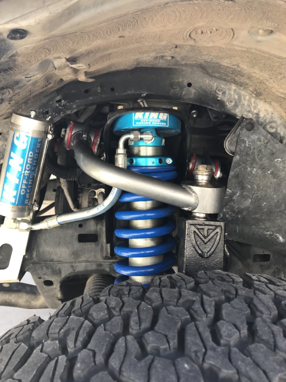

    I’m a 2nd gen with a tad diff setup but with my preload I have set it still rides well. IMO You still have room to move up before losing ride quality

    Who told you that? King's come set from the factory for about 1" lift up front and that's exactly what yours are set at. Can tell by the number of threads above the collar. 2.5" lift is gonna look more like @djthicks picture if not even more threads showing.

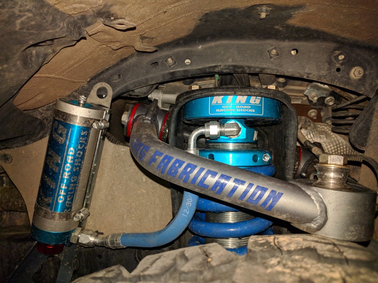

    F638442C-0E0F-47B4-855E-9DF9C1FD1E1D.jpg 2EDC95C8-C827-401B-B765-419BC7092B02.jpg E5B12084-2E9D-4D9D-BE1D-A0B6E3630C42.jpg
    Few more reference pics of when they were first installed. The first pic is the settings they came with from @Downsouth Motorsports... these pics are with king coilovers only
