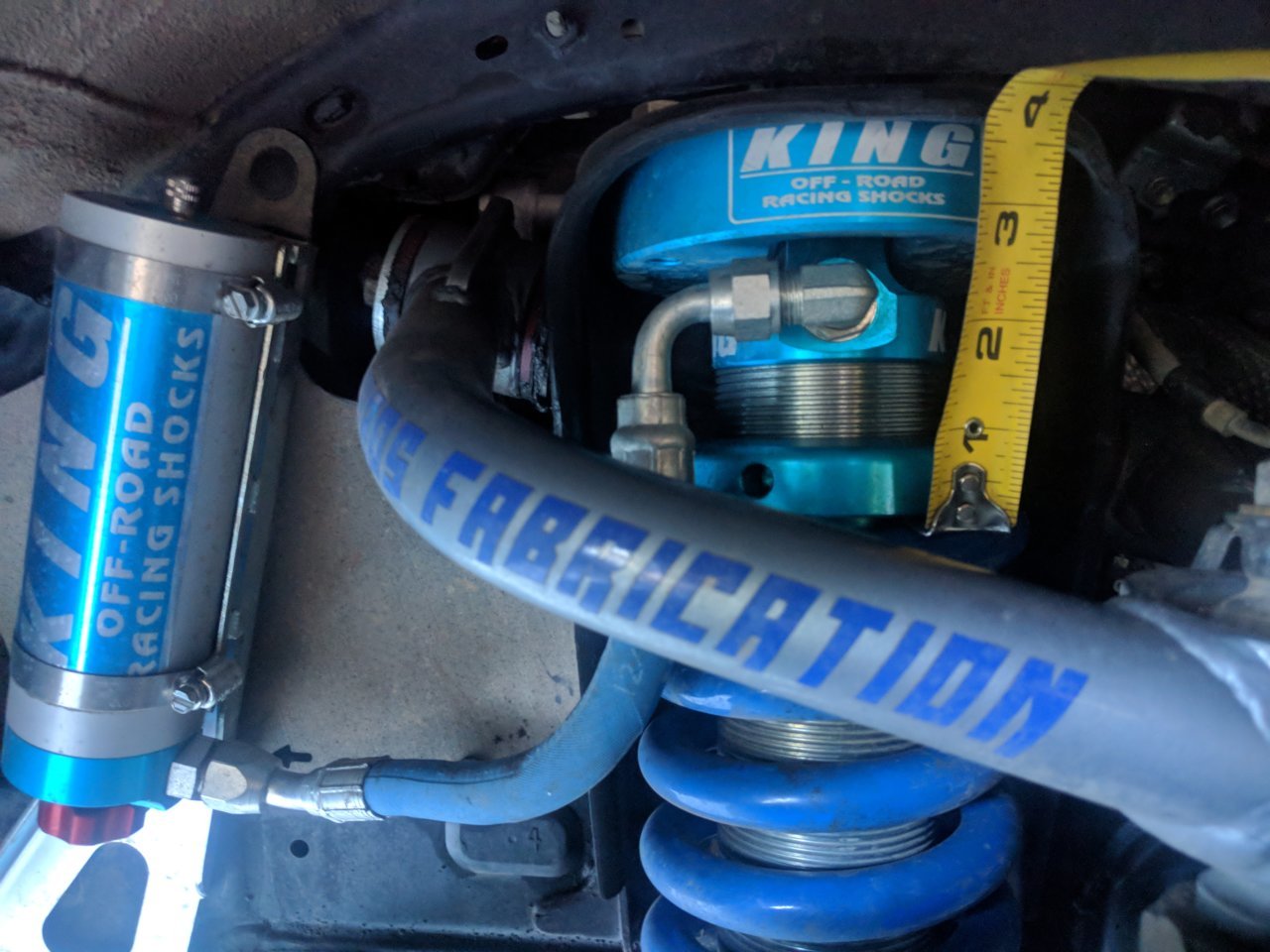

  5. Jun 20, 2018 at 4:42 PM
    #25
    rideawalrus
    rideawalrus [OP] Well-Known Member
    Sep 5, 2015
    #163496
    245
    Four Corners area
    '16 TRD OR 4x4 Prem Tech/JBL Blazing Blue, King coils/shocks, deaver leafs
    King coils/shocks, deaver leafs Pelfrey skid soft topper Nalgene holder

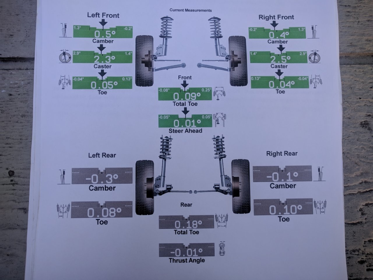

    Got it adjusted to about 3/4 inch of threads showing, 5 full turns brought the truck up about an inch, so now I have about 1 1/2 inch of rake which is perfect. I'll test out the ride quality this weekend. Does anyone have alignment numbers for these? Here is what the shop got me to.

    Where can I order the T-Handle? Ive always felt the front of my truck is too low, I have 2.5" EXT KINGS with 700lb springs, when I ordered from DSM all I received was the 3/16" punch, so will i just jack up the truck by the crossmember, unbolt the upper control arm from the knuckle, maybe loosen the hose just a tad to move it out of the way, loosen the lock nut some and start cranking it?

    I ordered my T handle directly from King. It was not cheap IIRC. Around $50
