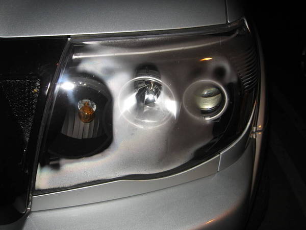

    i bouth these headlights:
    and as you can see, phucking water got in... if there is one phucking thing i hate in this world, this is one of them. I e-mailed the seller, i am waiting for response...i am so pissed right now i cannot think straight.
    please guys i am turning to you for guidance on the matter...what should i do?

    sometimes a little condensation is normal, if it gets to where there are actually water drops inside then there is definitely something to be pissed about. it'll probably just evaporate out tomorrow but i wouldnt be surprised to see it come back.

    Those new ones are supposed to be just as watertight as the factory ones! Condensation is NOT acceptible in a headlight housing as the beam will be contorted and the bulb will fry itself.
    you have a flawed seal and I would reject them both for a new pair!
    My stock stand on things like this is-
    why should YOU accept and live with them when thousands of other folks paid the same bucks and are enjoying nice DRY headlights?

    The factory ones actually do have a hole in them to help this issue. they have a plastic foam plug in to help keep them dry but it lets them breath to dry out if moisture does get in them

    Bro, calm down... This is particularly common in aftermarket lights, especially the DIY aftermarket lights.
    Solution: wait till they are completely dry on the inside. Leave them in a cool climate that is constant like inside your house over night etc... The next day apply a layer of a sealer to where the light comes together on the back part.
    This should fix the problem. It sucks, but the fix is easy... Or return them

    I have those before on my Tacoma.....with a set of HID for the low beam.
    It have water inside the headlight housing after i install it for two days. i e-mail to the seller, they send me a new one.
    I just want to say, if you can return it, return it back.... and get a refund.

    It is probably due to the humidity in the air and not an "exterior" water source. Give it a few days and it will probably go away. It would probably help to leave the bulbs out when you get home.

    That blows. I have the same housings and haven't had any condensation issues. Definitely a defective part and should be replaced.

    I have the same lights and I have some condensation in there... I'd imagine because of the humidity. Clears up after I drive it a bit and not too big of a deal to me.
    You could pull them out and redo the seal... Would save you a lot of waiting for a replacement.
    Where did you buy from? Are those Eagle Eyes?

    yeah, the condensation is gone i will try to get another pair under guarantee if not i will apply some sealant...thanks guy for the replies. i haven't left any feedback to the seller but if he does not take responsibility i will leave neg. feedback.

    turn ur lights on and itll help get the foggyness out, then i suggest resealing the whole head light with silicon II. good luck and keep us posted!

    If you got them from who I got mine from XRTeam... They never answer lol. Really it isn't that big of a deal. I get fogging every once in the while. It goes away.

    yeah, the headlights in my quad do it all the time when i leave it sitting in direct sun, then it cools and the atmosphere within the headlight equalizes and it goes away. not that big of a deal and turning them on makes the moisture go away quicker.
