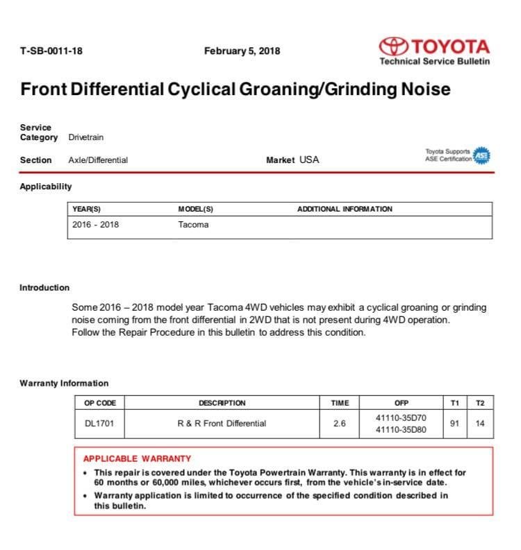

    Could it be...
    Boghog1 likes this.

    I ask because I have a rhythmic vibration that I can feel in the steering wheel between about 20MPH and 60MPH, most noticeable between 40 and 50MPH. It almost feels like I'm driving across very light rumble strips - 3 seconds of high-frequency vibration, 2 seconds of nothing, then 3 seconds of vibration, over and over again. The duration of the vibration and the gap between vibrations does not change significantly with vehicle speed. This is during normal road driving in 2WD. As soon I engage 4HI it goes away completely, which is exactly the behavior described in the TSB I posted. Took it to the dealer, who "didn't hear a noise", but felt the vibration. They then actually removed my wheels and tires, replaced them with stock wheels and tires, and drove the truck again. Said they didn't notice the vibration in stock configuration therefore it was my wheels and tires. When asked if they had engaged 4HI before the swap to reproduce my experience, I got no answer. I'm sure this is the needle bearing in the front diff, but they refuse to do anything. I'm calling Toyota Regional in Denver today to see what they can do for me, then it's on to Corporate if I get no satisfaction.
    Sorry, I didn't mean to come in and hijack your thread, but I thought this info just might be relevant to your issue.

    happens in 4wd...very faint, doesn't feel like a grinding. I have the ECGS bushing that replaced the driver CV needle bearing
