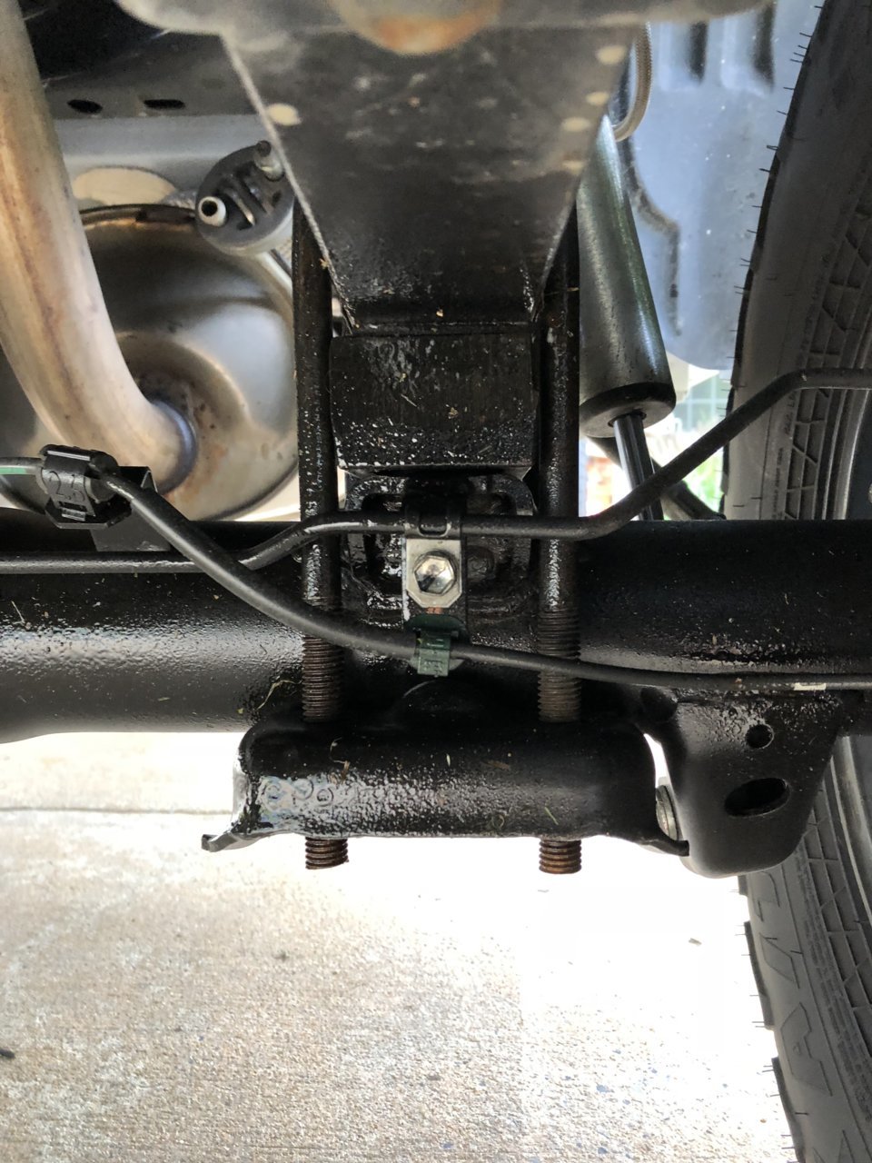

    I’m running 1.5 steel blocks... come tapered to correct for drive line angles paired with 5160 shocks about 20k miles now no issues...think they were $70 bucks with the j-bolts.
    D3669013-24B9-4F96-978B-F0E0E23BC351.jpg C9648764-8B88-44E6-9AEA-36FB9AC98F84.jpg

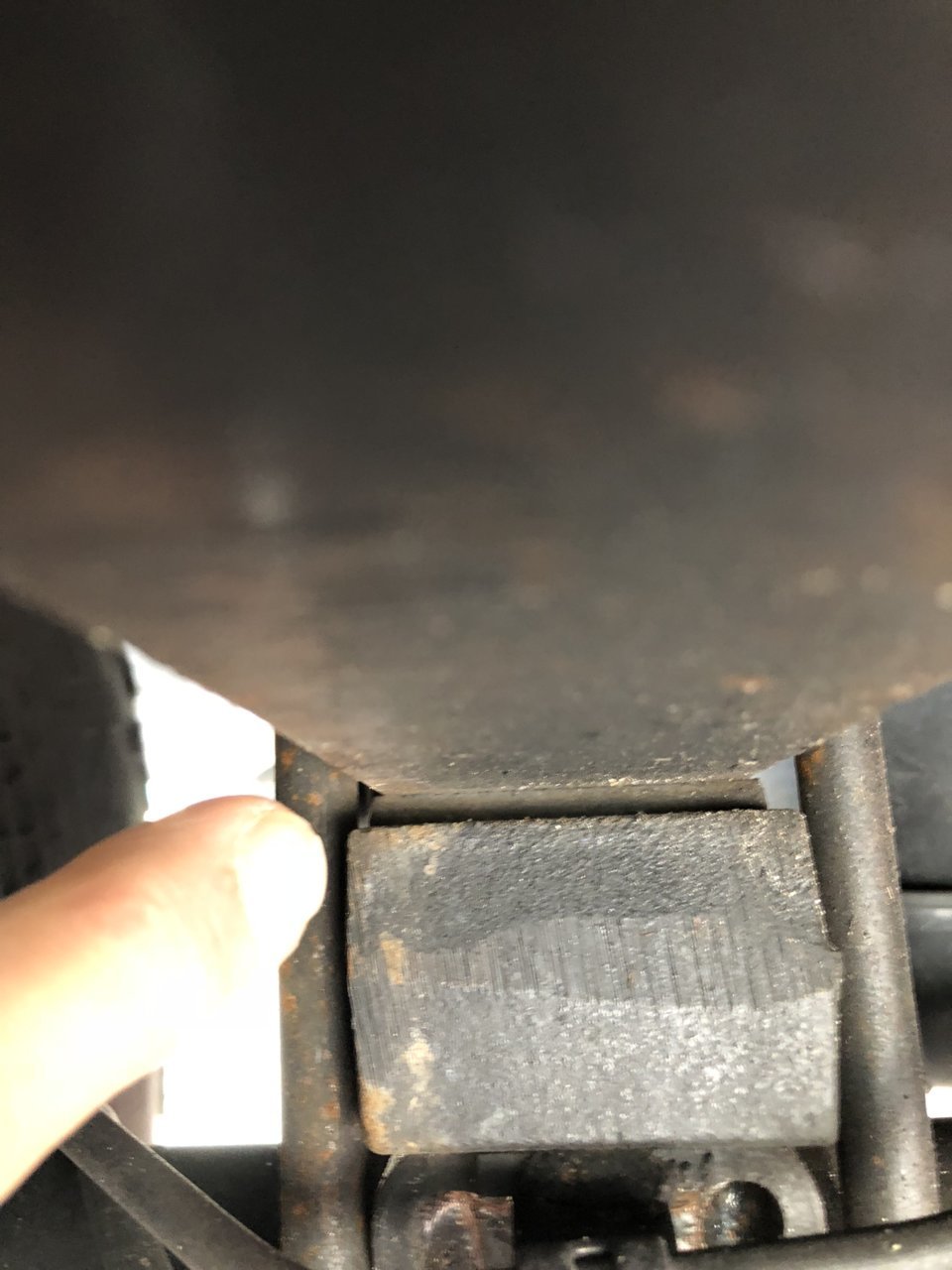

    I have 2 1/4 spacers up front and originally ran 1 inch blocks in the rear with stock shocks for about a month...the truck looked level to slightly nose high so I switched to 1.5 blocks in the rear with bilstein 5160’s now the truck looks level but the rear is actually 3/8 of an inch higher than the front. I’m happy with it. The blocks are tapered to maintain drive angles and prevent vibration and help minimize axel wrap...easy to install fat part of the block towards the rear and thinner part faces towards the front of the truck. My truck came factory with tapered shims I put those shims back in on top of the block see photo the truck is smooth with no vibration and my springs don’t squeak.
