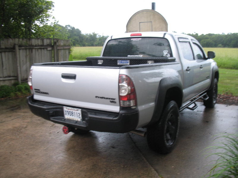

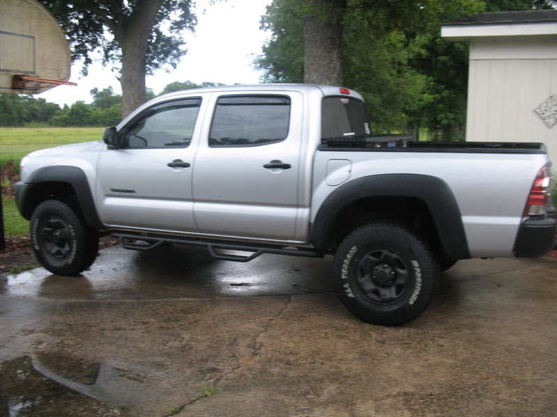

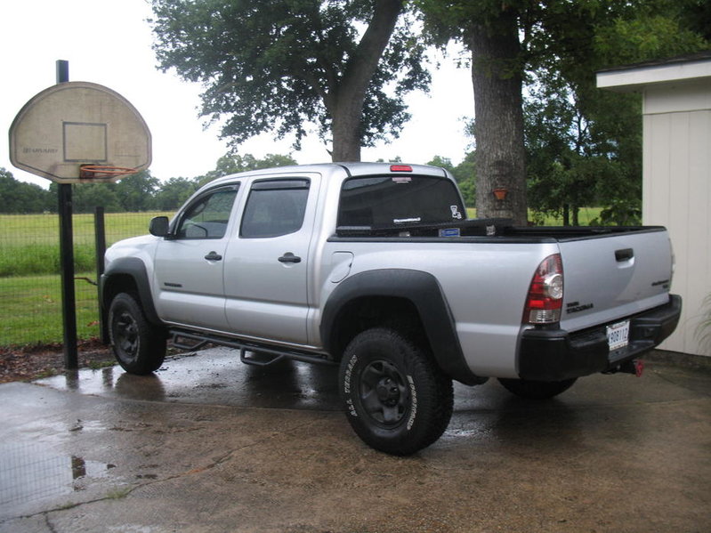

    I recently installed 5100's @ .85 with Eibach coils and I'm not getting a full 2.5". I have the TSB 1.5" AAL for a total of 4 leafs and I am sitting slightly lower in the front. It's a small, but slightly noticeable rake. I've seen many other trucks on the site that are perfectly level with this same setup. Should it have a slight rake, or is there something that I should possibly look into? FWIW, I did set the ring on the second slot on the 5100's.
    Pics for reference:

    Hate to beat a dead horse but pics are about a million and a half words.

    They are in the OP...

    Little more detail besides a generic side shot would help....
