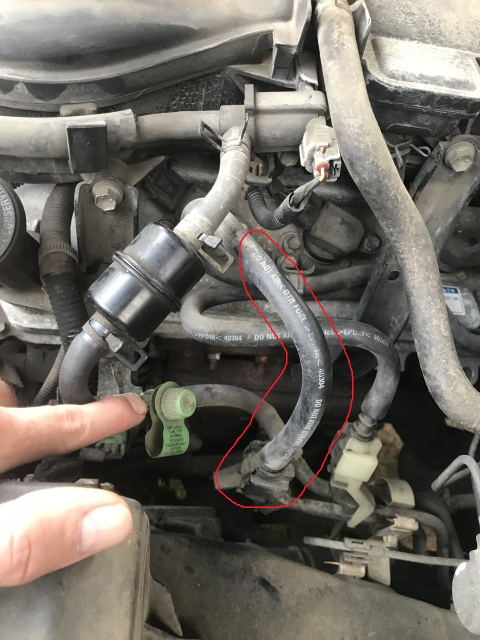

    All the lines look fine. I'm not sure which line it is, but the one with the green port for checking fuel pressure (I assume) I tried putting air through it -- felt restricted but I could kind of hear it near the gas tank so I'm not sure there.

    Got a pic of this port?

    This is the one I checked at.

    Amazing. I didn't know our trucks had a fuel pressure test port.

    I didn't see that line you were pointing at from the link I sent you. According to that link, they checked the pressure from the line circled in red.

    Ok yeah. I didn’t check that one because I wasn’t real sure how to get it off without breaking something.

    Push the plastic retainer off, then depress the two plastic tabs, and pull up.

    I got it off, I pulled the line off and get fuel from the rubber hose side. Not sure what PSI, I don't own a fuel pressure gauge. I'll pick one up tomorrow.

    The green cap is the test port for the evaporative emission system, totally separate from the fuel delivery lines
