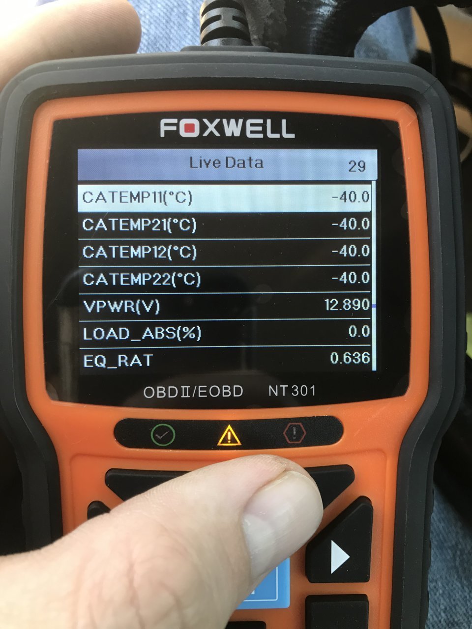

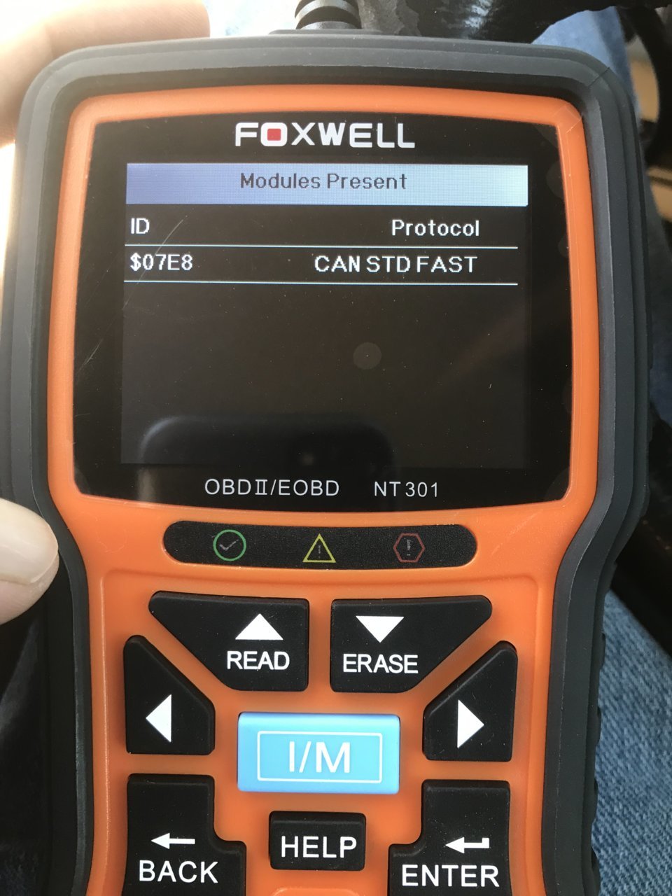

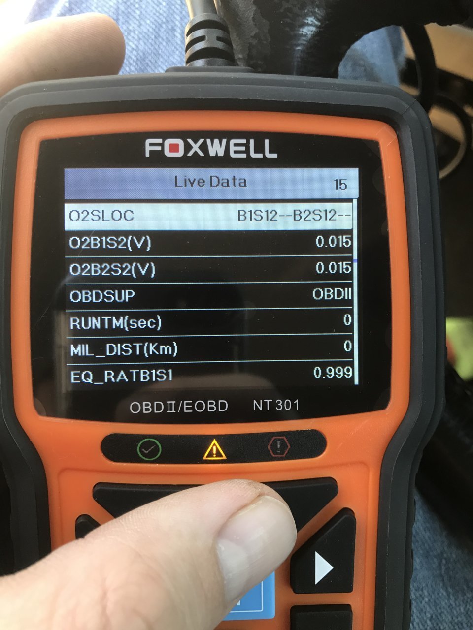

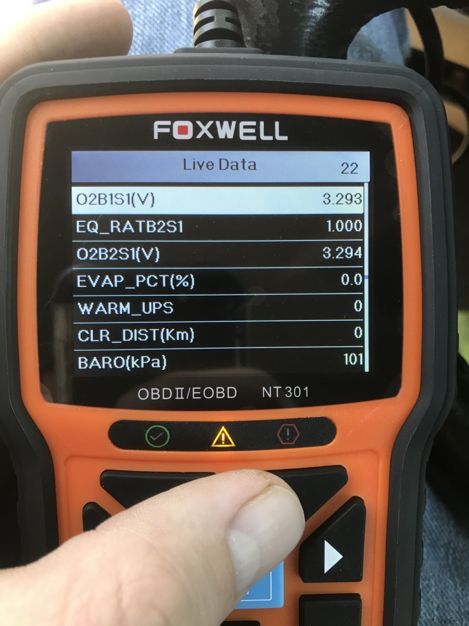

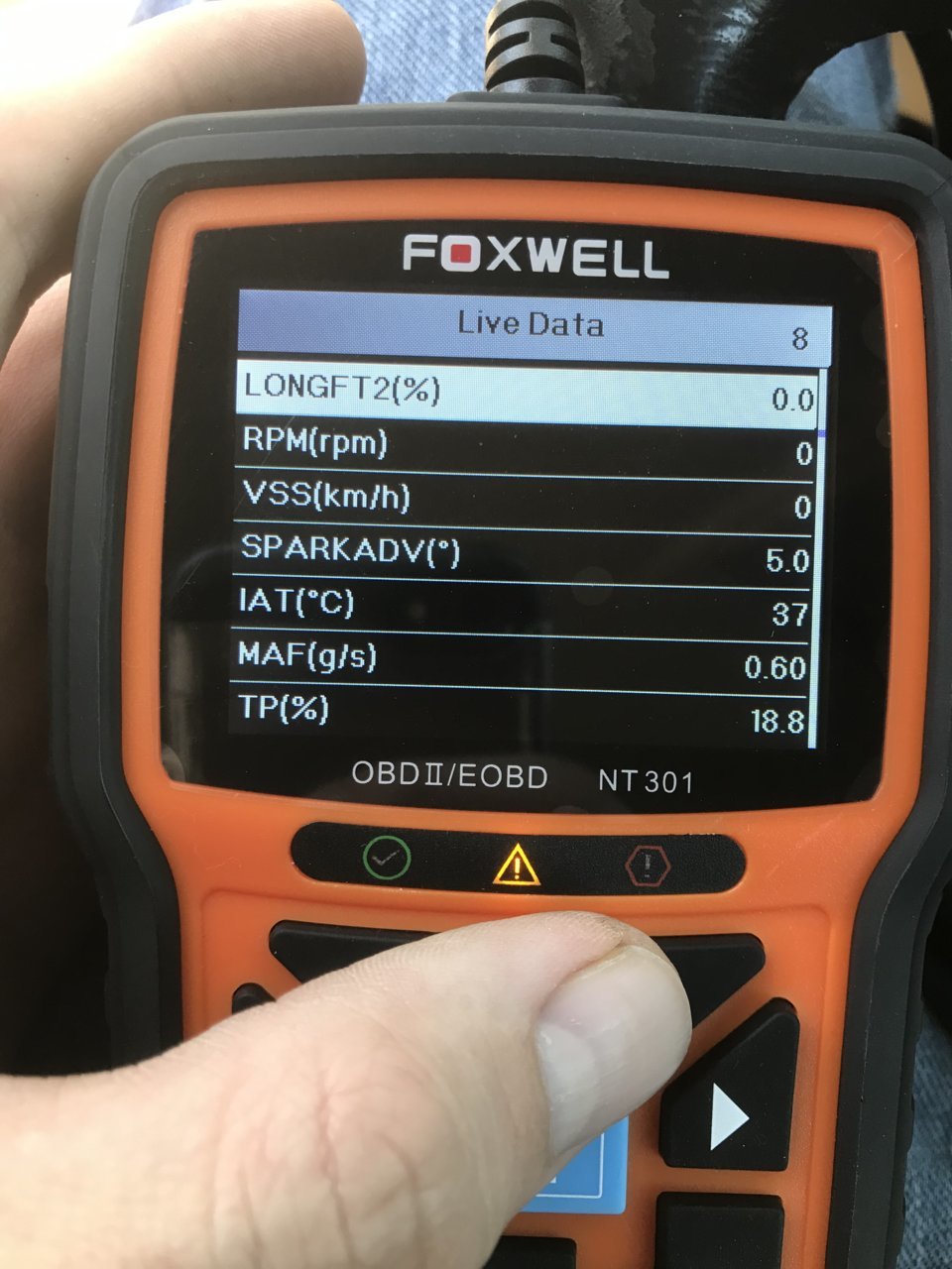

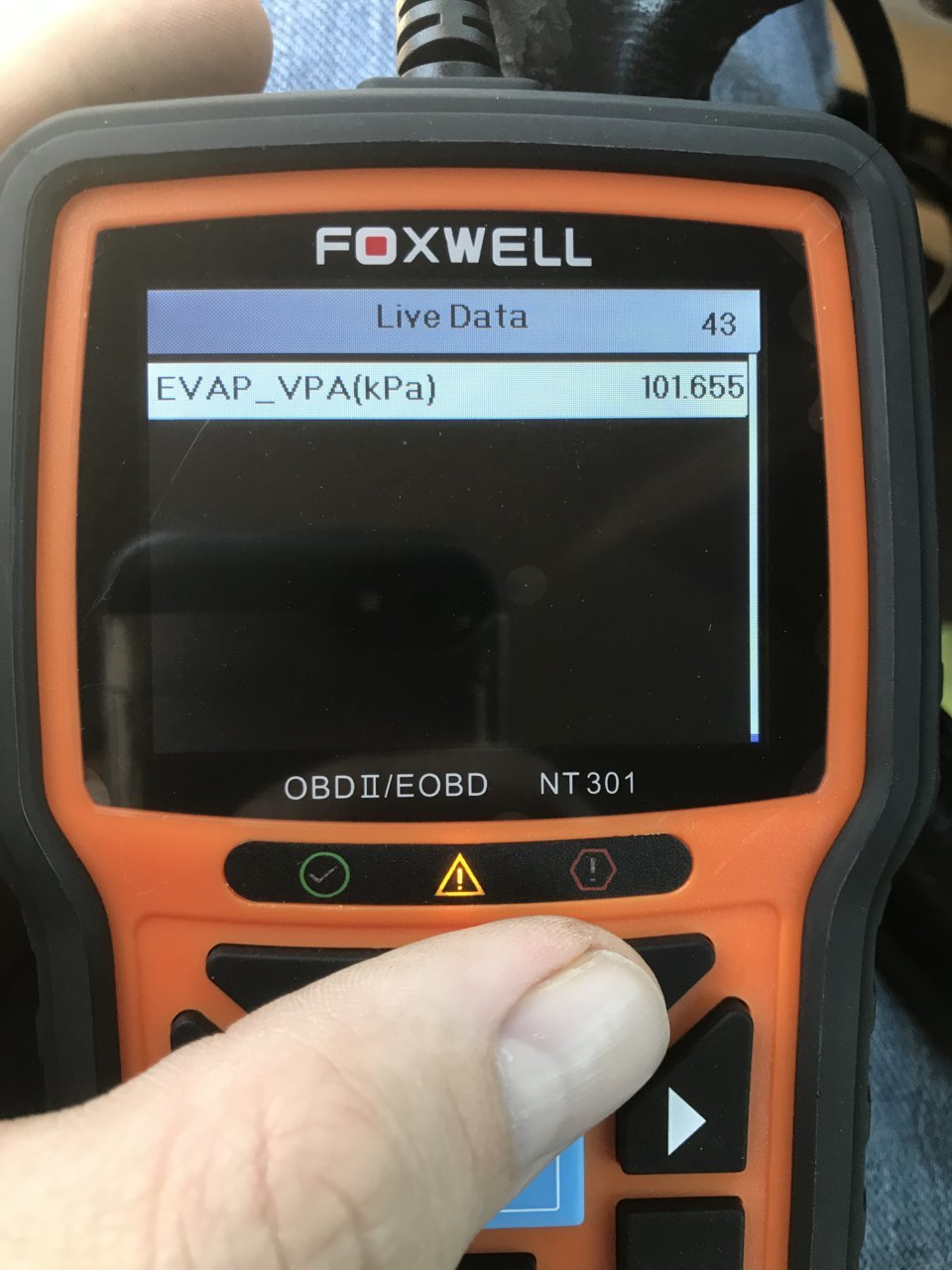

  19. Mar 20, 2019 at 2:30 PM
    #79
    waydwnsouth
    waydwnsouth [OP] Active Member
    Mar 8, 2019
    #285876
    28

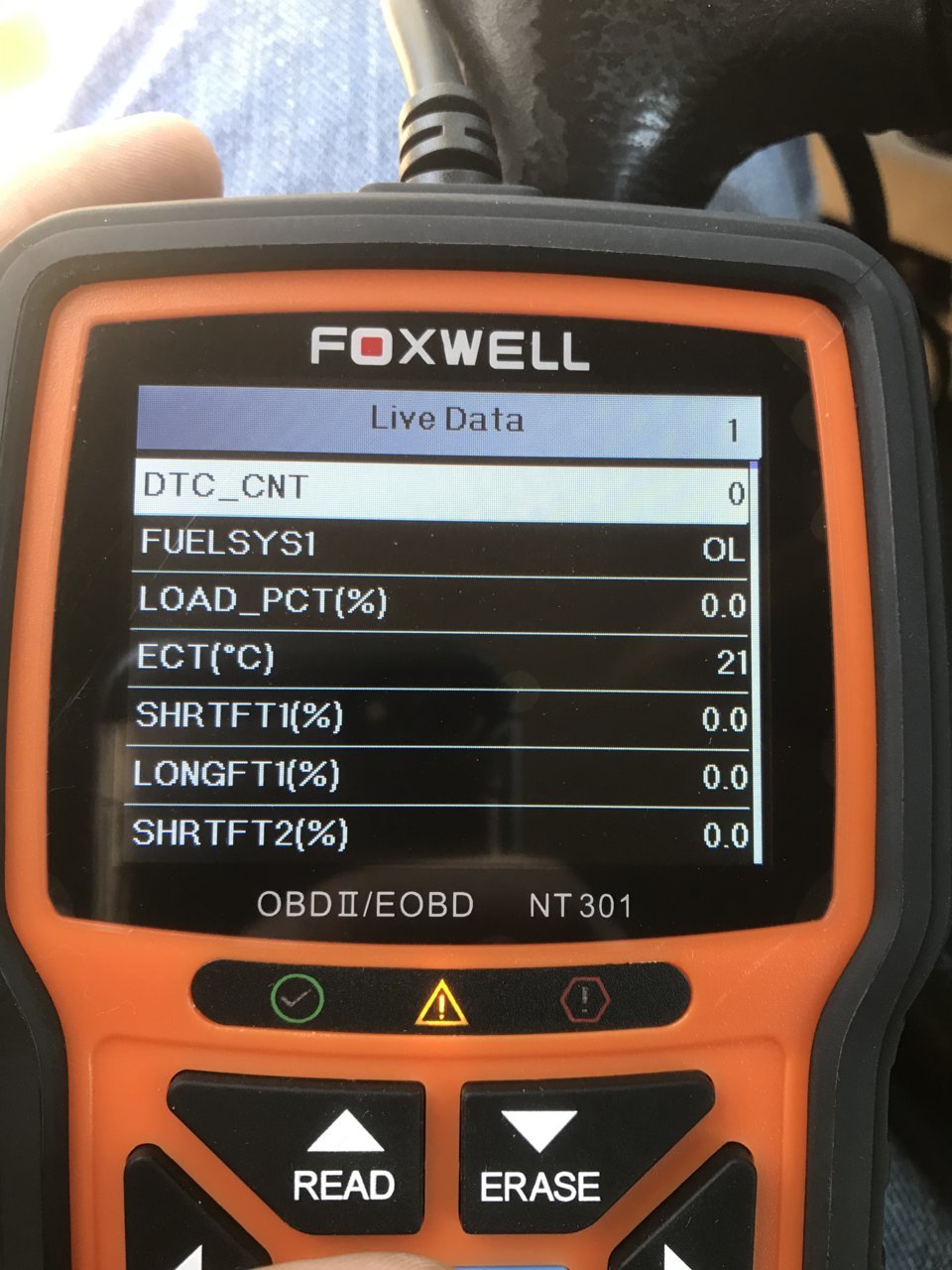

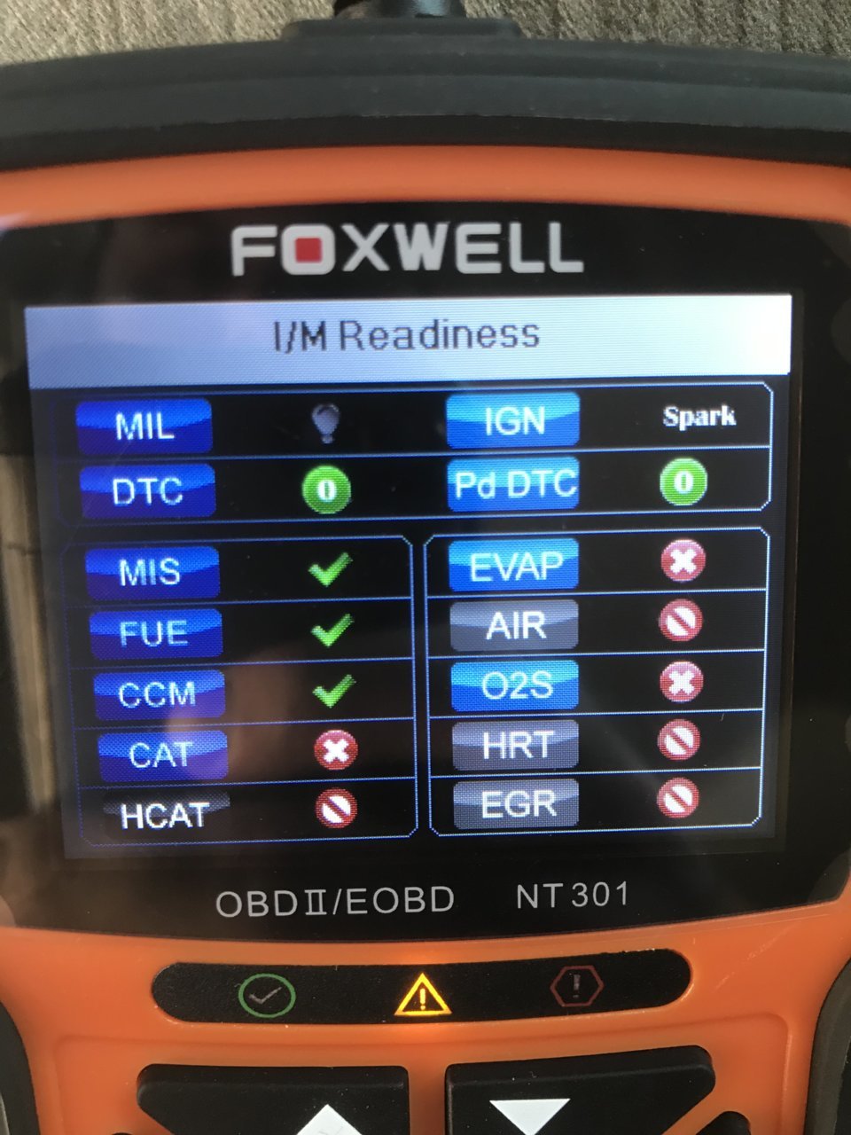

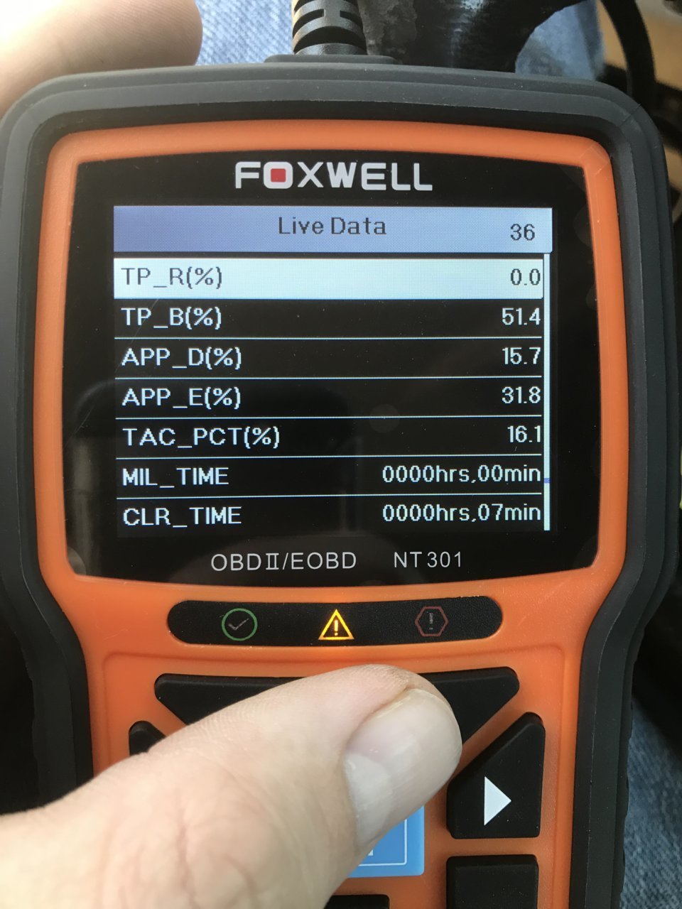

  20. Mar 20, 2019 at 2:30 PM
    #80
    waydwnsouth
    Mar 8, 2019
    #285876
    28
    This is everything I could find on the reader. Been trying to Google what all I can but it’s a bit overwhelming. These are all just stats without cranking.
