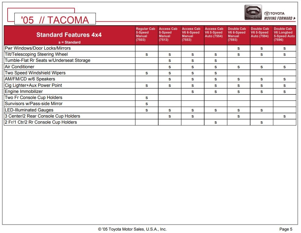

    Look in the middle of the dash to the right of the clock, if you have an immobilizer there will be a red vehicle icon with a key in the middle of it that will flash when there's no key inserted.
    BassAckwards likes this.

    According to the brochure immobilizer is standard equipment on v6 4wd trucks.

    So when i put the valet key in and this goes away, that means its sensing another key somewhere right?
