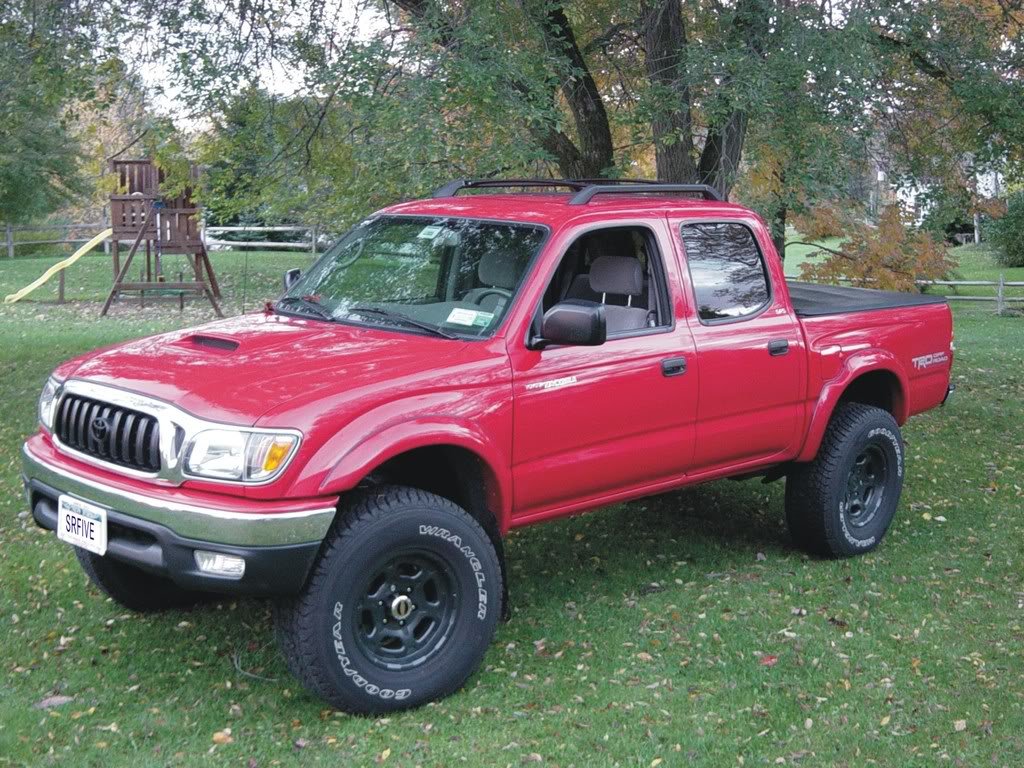

    There is a lot to be said for leaving a truck stock, personally I have always modified my vehicles, (if interested: http://doodlescustomartwork.com/HISTORY.HTM) I just like to have something personalized, and to a certain extent different then everyone else.
    Sounds like your TW friends are offering up advice, and I can't resist giving you mine. This Tacoma, my 6th Toyota truck, I wanted a moderate lift while maintaining comfort and usefulness. Did a lot of research, made some mistakes, but finally got it right (IMO):
    3" front lift - Fat Bob's Garage strut spacers, $117 comes with differential drop hardware. I actually had ICON coilovers first, but took them off because of the terrible ride and some other quality issues.
    1.5" rear lift - added a 4 pack to existing 3 pack leaf springs, not only does this give you a even ride height, but also increases your payload capacity.
    Finished it off with 285/75/16 GY Wranglers and 16x8 American Racing ATX Aluminum wheels.
    Got carried away (as usual) and installed manual hubs, high angle CV joints and upgraded to an 1-1/4" ADDCO Anti-Sway bar, built a custom hood, etc.
    For what it's worth, I don't feel I compromised on the ride at all. It's my daily driver, with a family of four, I can't afford to have an uncomfortable vehicle.
    Now my '87 Toyota 4x4, with the Chevy 350, 8 inches of lift, 35's...that was a little stiff...but that was before the family...
