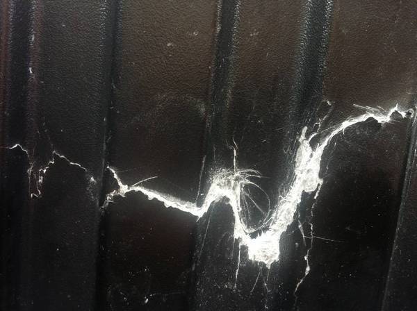

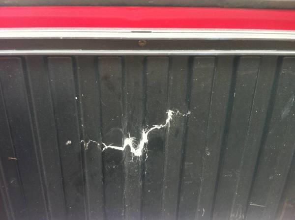

    Well, just checked in with my body guy and this is the stuff he used to make the repair... Quickset 50 by SEM
    http://semproducts.com/product-catalog/repair-materials/dual-mix/adhesives/quick-set-50/
    The stuff has a work time of 50 seconds and has a black color. Perfect for plugging/patching work on small holes. I asked him about Tiger Hair and he said that for the composite material the beds are made of, the fiberglass based Tiger Hair will adhere great at first, but then after it tends to lift and separate.

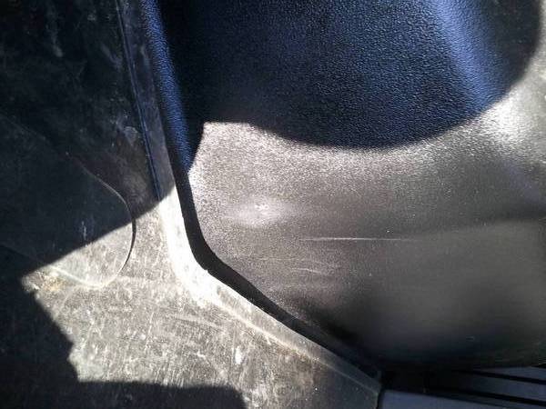

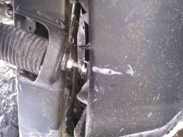

    Here is a view of the fender prior to repair:

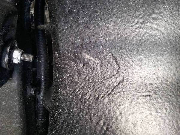

    And after... looks damn good if you ask me... Quickset 50 was the way to go.
    Inside the bed:

    I was wondering if you just purchased the quick set 50, or if you purchased the contour tape as well? This is the best solution for a repair I have seen, and I would like to adapt it to fix the sizable crack I have in the side of my truck bed behind the cab.
    I figure I will drill the holes at the ends of the crack, fill crack with quick set 50, and sand down until looks acceptable.

    I would just hit it with Quickset 50 after drilling holes to stop the crack. I did not have any contour tape on mine. After it has set, I would think you could sand it and then spray it with textured bumper paint or spray on bedliner... both have that rough finish to blend it with the bed. Post some pics of your repair if you can... interested to see how it comes out.
