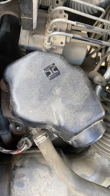

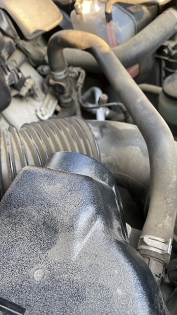

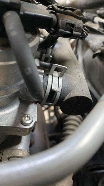

    WTH am I looking at folks? (The thing with the big “H”?)
    I have been combing through my owners manual trying to figure out what this knob is for. It doesn’t appear on any of the diagrams that I could find.
    Here I have pried off the plastic cover. It appears that there was a label glued to the knob at one time and it has fallen loose.
    I first I thought it was a heater control valve because there’s a big H on top of the cover.
    But IMO this is not a knob: it’s just a cover for an adjustment screw, and it spins freely. At least that’s my theory because I have not tried to break it off yet.
    Anyhow it appears to have one hose that leads to this check valve (?) And then to a small rubber manifold that connects to two (air) valves.

    OK, thank you guys. This is just a big expensive air bleed.
    I took it into the dealer for the service last year on this under warranty, as there was a service bulletin.
    This is the bit with a little sponge filter that degrades under wet weather and then plugs up.
    Fortunately I live in the desert and I only wash my truck infrequently because of the drought, so just never turned out to be a problem.

    Not exactly.
    'water' is not the issue, but when the system fails the truck will set a code, sometimes failing to run. Or at least run well.
    It's not a recall, but it does have an extended warranty so if it fails you'll be covered based on the link provided.
    2012 was the worst year for this device to fail.

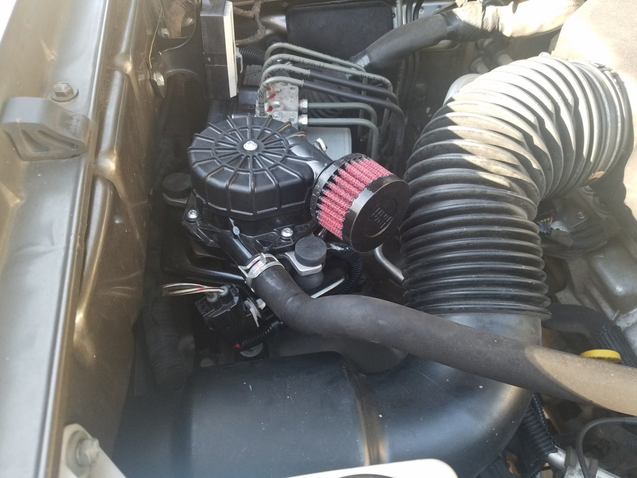

    Many of us have replaced the filter with a small pleated filter to preclude the problem.

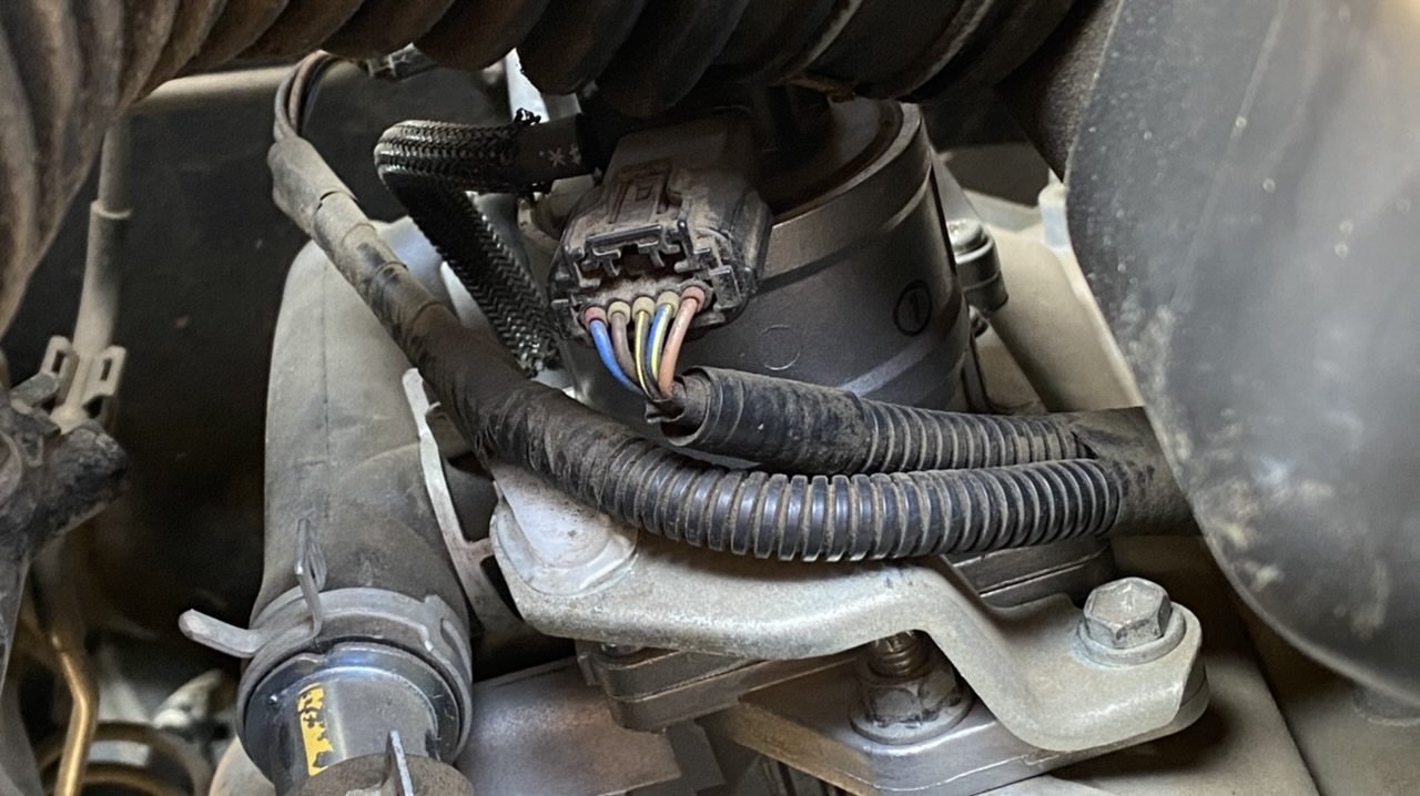

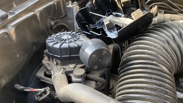

    OK, my truck has 50k miles, and my filter was clean, so it's just been replaced. The snail was clean inside too. No evidence of dust/degradation.

    The earlier models with SAIS had slightly more trouble with the valves because the later models (somewhere around 13 and 14) added programming to run the pump and open the valves for a couple seconds at engine shutown to purge the moisture from the system.
    Filter design seems to be the same but the later models weren't part of the TSB.
    I've done the UNI filter mod on mine just to rule out the filter as a possible failure point but the pumps and valves are know failure points too especially on earlier models it seems.

    It's an air pump that pumps air into the exhaust to heat up the converters faster. The faster the converters heat up, the faster they can start working as designed
    The problem toyota had was the foam filter would break into pieces, go down the line and clog up the valves that regulate the flow of air into the exhaust

    Uni mod on my 13 - almost 3 years no problems & keep your factory shit incase it goes out

    Top cover is on mine with the uni mod. You can leave it off but you’ll have to replace it faster. Def don’t wash the engine with the uni filter exposed
