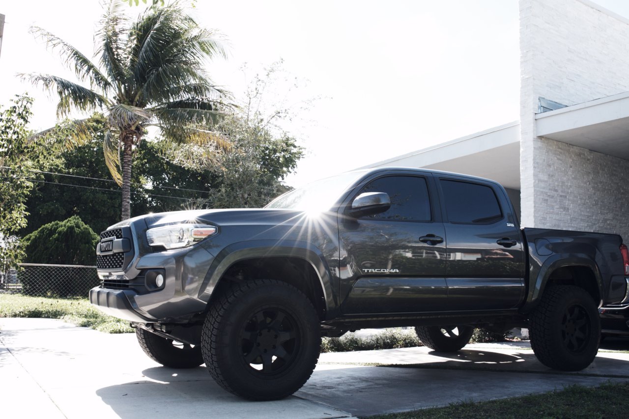

    LIFT AND TIRES:
    Icon Lift 2.0 Stage 1 - up to 3.5” lift
    http://iconvehicledynamics.com/shop...ta-tacoma-0-275-suspension-system-stage1.html
    2" ReadyLift Block (Recommended by the install shop to correct bro lean) (Since deleted)
    https://www.readylift.com/2-rear-block-kit-toyota-tundra-tacoma-1995-2018.html
    Upper Control Arms Huigh Caster - JBA
    https://jbaoffroad.com/jba-std-high-caster-upper-a-arms-for-toyota-tacoma-05-plus
    18" Level 8 Slam
    https://www.carid.com/level-8-wheels/slam-matte-black-1767740629.html
    Nitto Terra Grappler G2 - LT285/65/18
    https://www.carid.com/nitto-tires/terra-grappler-g2-38834197.html
    Nitto Terra Grappler G3 - 285/65/18 E
    https://www.nittotire.com/light-tru...pt4u9CmdUCgb1dXk_AfUO19YlU6HakbBoC2Y4QAvD_BwE

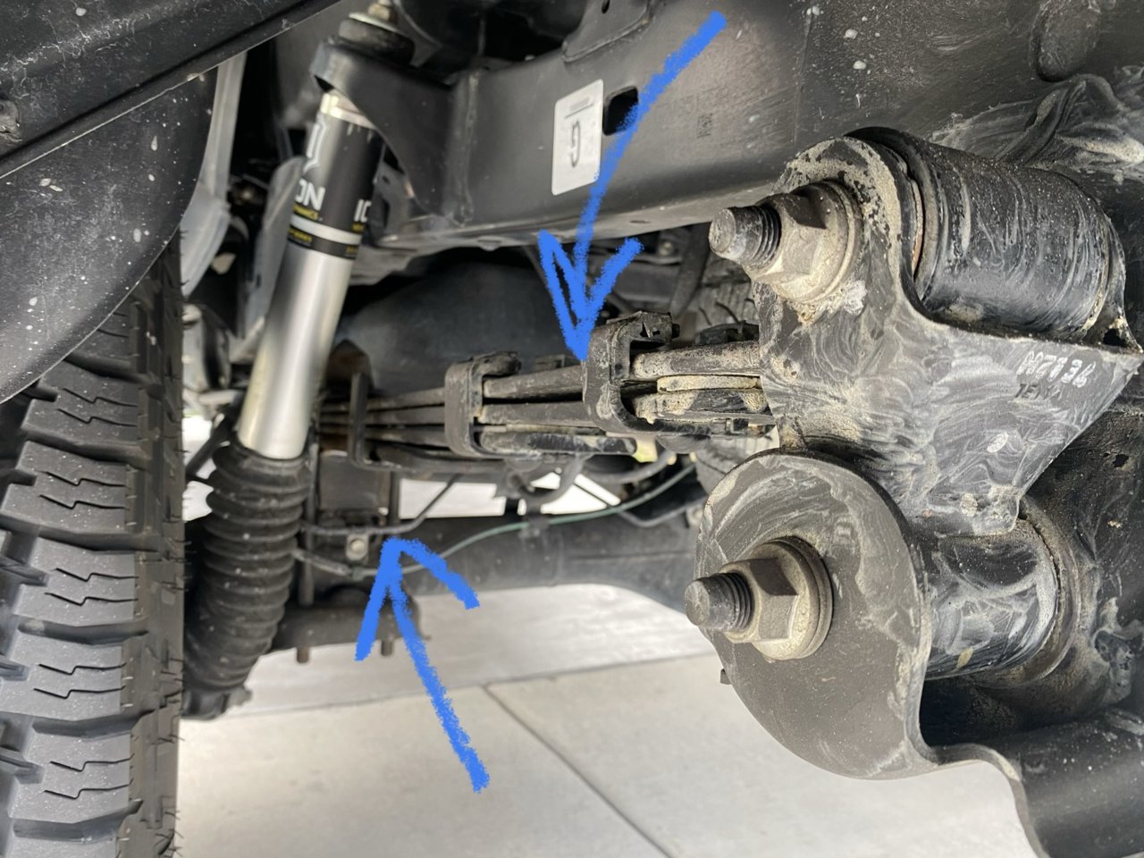

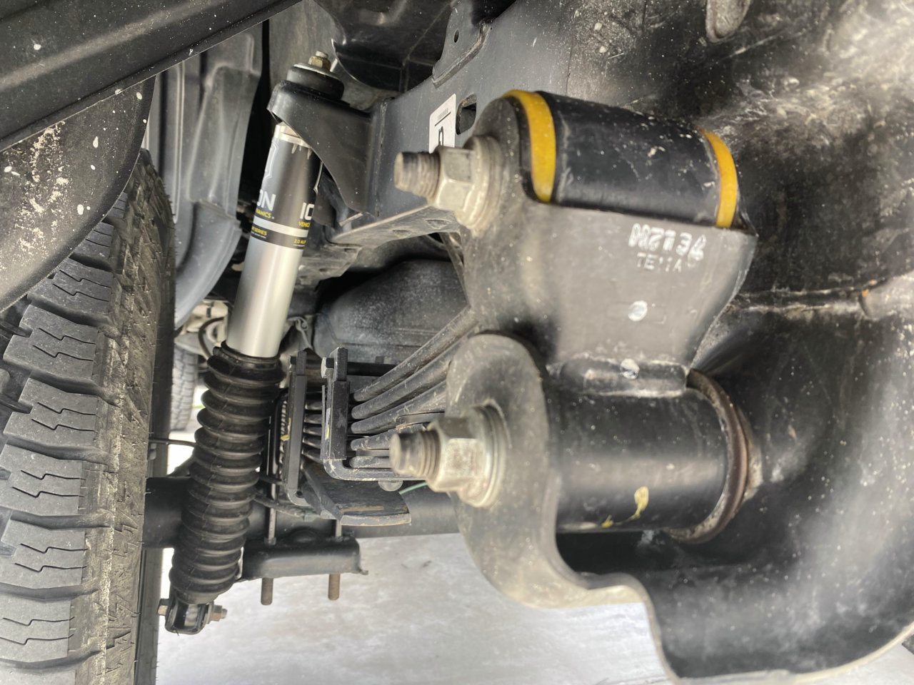

    After driving for about a year, I replaced the block and OEM leaf springs
    OME 2" Lift HD Leaf Springs w/ Extra Leaf
    https://www.bilsteinlifts.com/shop/...IULC4rzBdXvvoVzlqab9v3NB1xpLLXmwaAjHvEALw_wcB

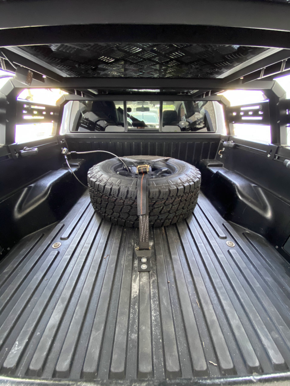

    Installed an NFab Tire Bed Strap

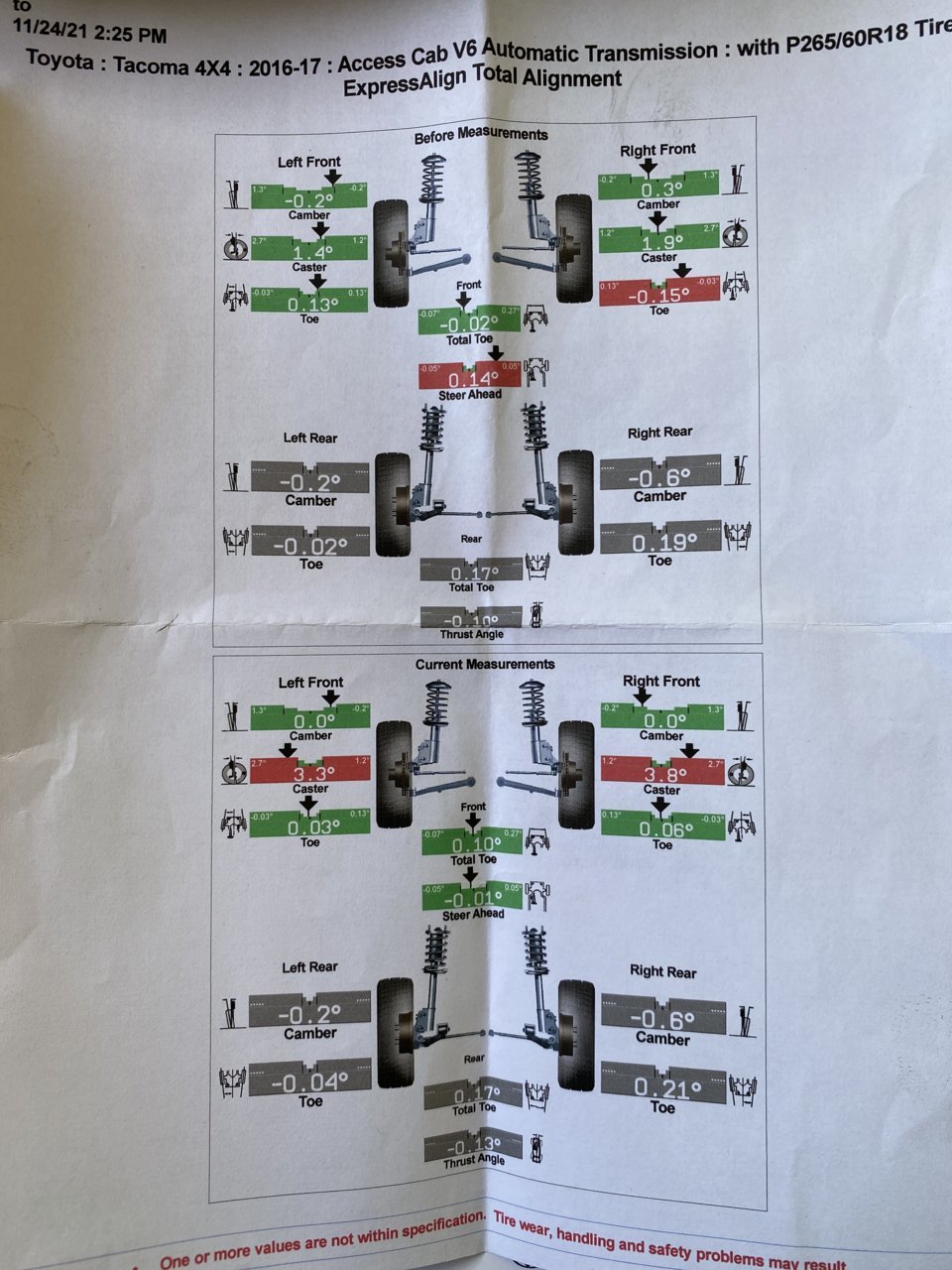

    Upgraded to the new Poly Bushing JBA HD HC UCA
    ***Important*** I Had to lift the front end coilovers a little over an 1" and do a Cab Mount Chop to avoid rubbing on the same wheel/tire setup I had before. After the Caster Degree change the front tires hit their max backspacing.
    TL/DR upgrading UCA's is way more work than expected.
    CMC
    Alignment Post Install for Higher Caster

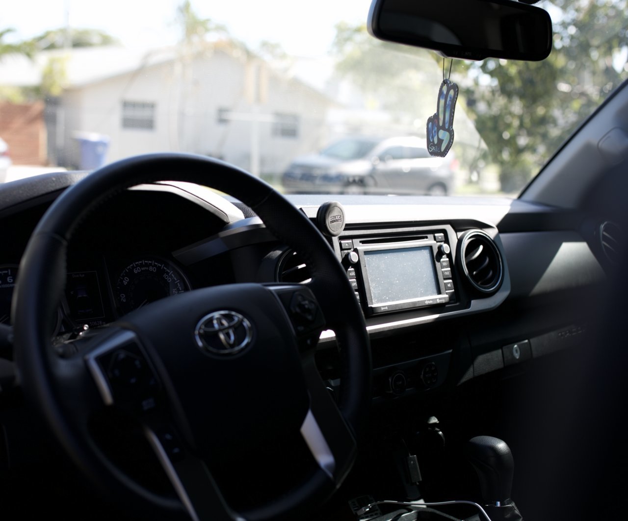

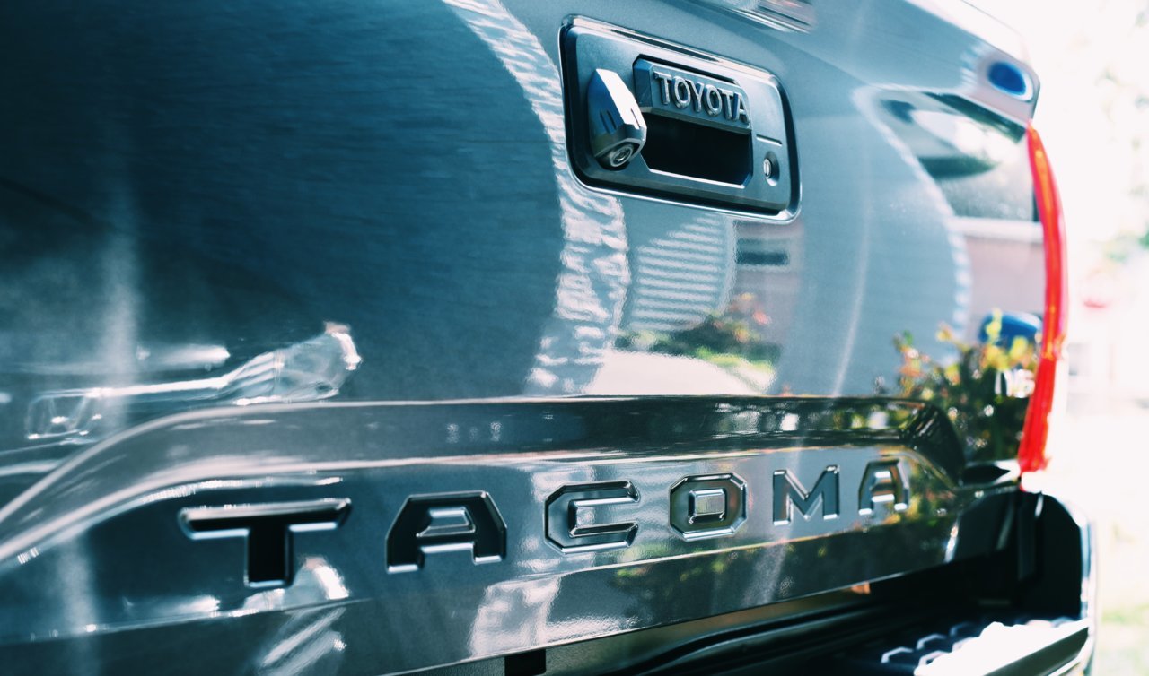

    INEXPENSIVE ADD-ONS:
    Tint - 15% over Stock Tint (Basically 5% all around)
    TRD knockoff grille insert (not sure if that's the exact website so don't quote me on this, it's def a chinese one that cost $100 bucks but oh well, it works)
    https://toyotaproshop.store/products/3rd-gen-tacoma-trd-pro-grill
    Tacoma Stickers for Tailgate
    https://www.amazon.com/dp/B01889X1Y6?_encoding=UTF8&th=1
    StiffyMounts - Dash Magnetic Phone Mount (my favorite so far)
    https://www.etsy.com/listing/631496947/3rd-gen-tacoma-3d-printed-magnetic-phone
    TacoVinyl - Monochromatic Grille Emblem
    https://tacovinyl.com/collections/3.../standard-grille-badge?variant=29484358959207
    Fog Light Tint - Amber
    https://www.tacomalifestyle.com/products/fog-light-covers?variant=34934226124952

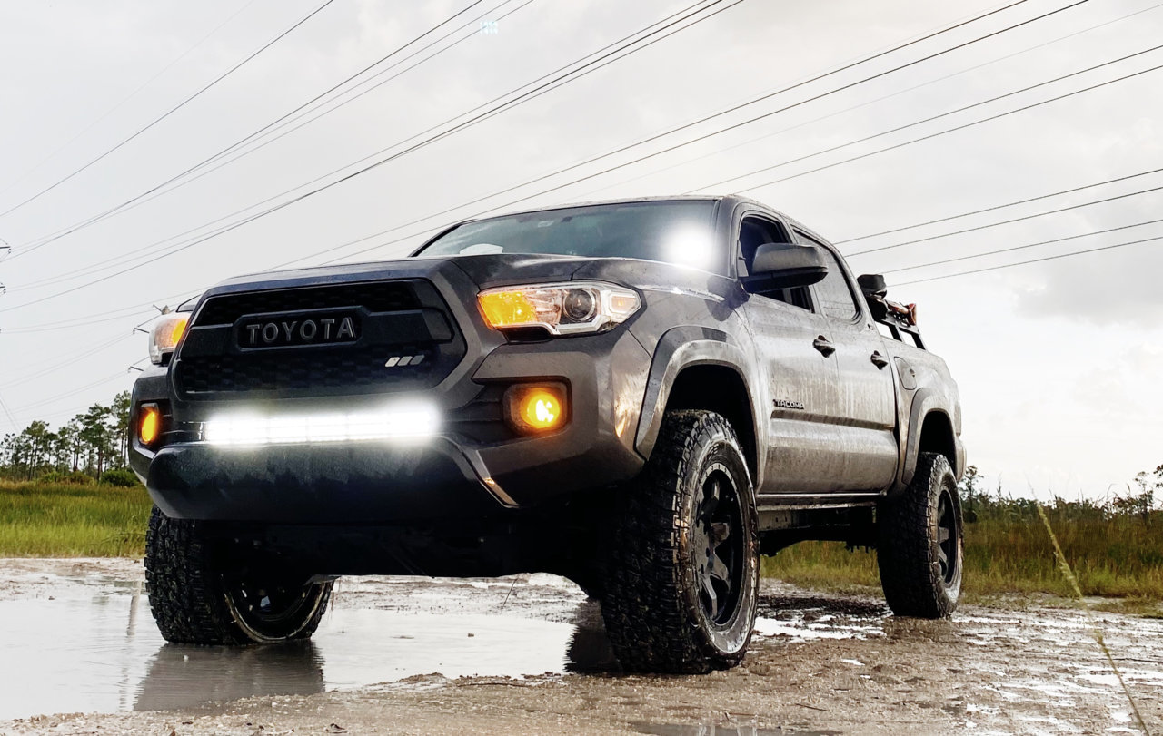

    LIGHTING:
    Caliraised Low Profile Mounting Brackets
    https://caliraisedled.com/collectio...6-2021-toyota-tacoma-ditch-light-brackets-kit
    Caliraised Ditch Light Pod Pair
    https://caliraisedled.com/collectio...roducts/side-projecting-led-pods-sold-as-pair
    Caliraised 32" Hidden Bumper Light Bar
    https://caliraisedled.com/collectio...ow-5d-optic-osram-led-bar?variant=26198011728

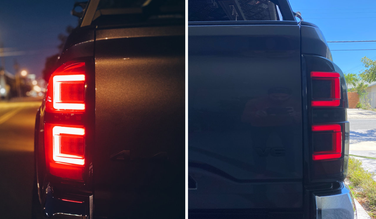

    Recon 3rd Gen LED Smoked Tail Lights
    https://gorecon.com/products/toyota...ights-smoked-lens?_pos=2&_fid=7bb942bb1&_ss=c

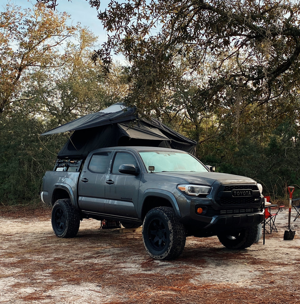

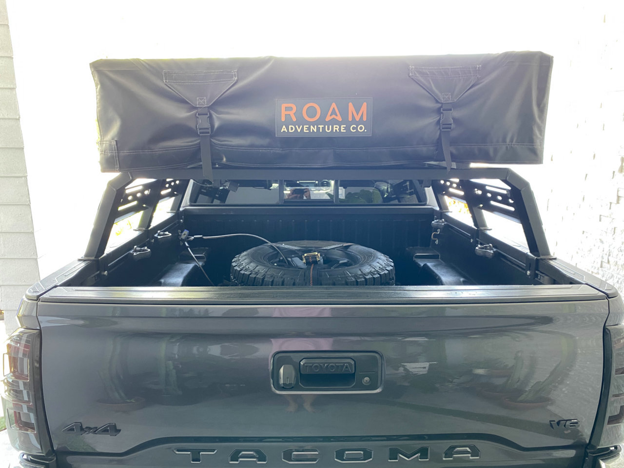

    OVERLAND GEAR:
    I'm going to continuously add to this list but starting with some basics for us.
    ROAM Adventure - Vagabond RTT w/ Annex - Black
    https://www.roamadventureco.com/collections/tents/products/the-vagabond?variant=34718357520550
    RCI 12" Overland Bed Rack w/additional brace - Powder Coat
    https://rcimetalworks.com/product/05-19-tacoma-bed-rack/
    Rago Fabrication Bed Stiffeners Igloo Cooler 124qt
    https://www.igloocoolers.com/collections/large-hard-coolers/products/00048496-mission-124-qt-cooler
    Coleman Grille
    https://www.amazon.com/Coleman-2000...t=&hvlocphy=9011972&hvtargid=pla-309742613703
