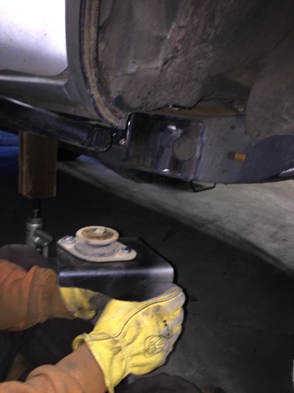

    Its finally alive!!!!!!!!!! Out with the old and in with the new. A friend and fabricator of mine just put in for the first run of 10 sets. Laser cut and bent out of a single piece of 3/16's. Hardware included. I think he's looking at 89.00 + shipping. Just remember these require cutting off the old mount and welding on a new. You also will be required to drill a hole in the floor of your truck for an additional mounting point.
    Ive got three of the 10 spoken for already so PM me if your interested.

    Im interested in this relocation kit. What all is included? Can you post some pictures of all the parts included? Does it come with the floor board plate? Do you sleeve the extra bolt holes?

    It comes with both frame mounts, steel plate for the floor, and the hardware. I plan on taking photos of the kit this week. Im really busy with work so Ill be crunched for time.
    No sleeve for the extra bolt holes. Ive ran this for almost 2 years and have no issues. The kit now is built a whole lot stronger than the prototype I first ran.
