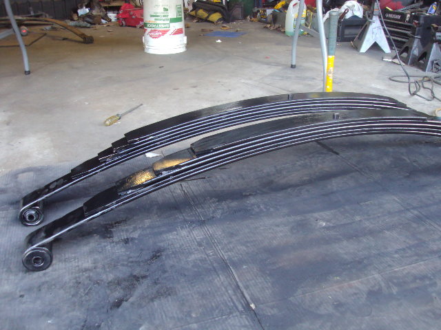

  8. Apr 27, 2013 at 2:34 AM
    4WD
    4WD cRaZy oLdmAn
    Jul 2, 2009
    #19185
    23,949
    Doug
    Lakeside, Ca / Gardnerville, Nevada
    No Truck..well, maybe
    Grey wire MOD, deck plate, diff breather MOD, 2nd gen. OME 883# on Tundra 5100's, OMD custom 3" leafsprings, rear shock relocation, Ivan Stewart TRD rims w/285/75/16's, '02 bumper MOD, Famous Fabrications sliders , LED interior/exterior lights, bed bar, Custom tube bumper, Old school KC day lighters,Red Ring 8" HID flood, Kenwood vhf 2M.. umm some other shit I'm forgetting right now
